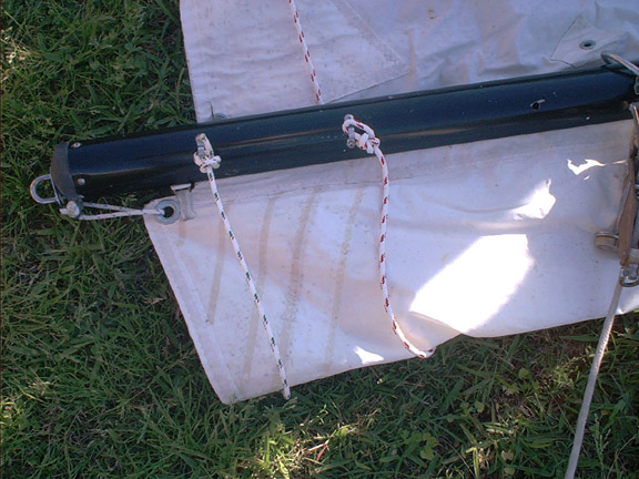

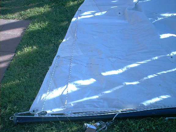

My Merit 22 has a single reef point in the (bolt rope in mast and boom) main sail, but no provision on the boom for reefing, so I'm setting up for simple slab reefing. every place I look seems to show the cheek block and fixed anchor mounted at a different angle from the lowered reef cringle, so I figure I'll ask here also :). one common illustration shows the fixed end of the reef line almost vertical below the reefed cringle and the cheek block mounted back about 45*, I assume the theory being the fixed side of the reef line holds the foot of the sail down, wile the cheek block side pulls it back on the boom?? seems reasonable I guess?..... thoughts?
The other thing that peaked my interest is one site that mentioned mounting both the fixed point and cheek block on the same side of the boom so the bunt of the sail doesn't get bunched up beneath the reef at the rear of the boom. this seems to me a reasonable thought for a couple reasons. less sail wear and a neater reef, as well as allowing the reef point to set more consistent and lower on the boom. thoughts?

yes one pulls it down, the other pulls it back. mine comes from the wnd of the boom to a small block in the cringle, and back down to the boom just a tiny bit aft of the cringle.

Generally having one side close to straight down (slightly aft is ok) and the other about 45° is a good way to go. I would not put both on one side since that would put a lot of torque on the boom. I've never had much of a problem with the bunt getting in the way.

I re-ran my two main reefing lines on either side of the sail. While at it, I ran them through the sheaves on their respective sides of the sail/boom. It helps "capture" the sail when reefing or dropping the sail in heavy winds.

it's OK. that ship has sailed now anyway, and I ended up placing the fixed end of the rear reefing line at about 1" aft of the reefed cringle and the cheek block side places the line at 45* aft of the reefed cringle. the vertical fixed side pulls the sail down to the boom and the other side hauls it back, so it's just 2:1 now (less in reality), but as an afterthought I may look at adding a floating block between the clam cleat and the cheek block to make it 4:1. but not today. today it's cold outside :beer:.
