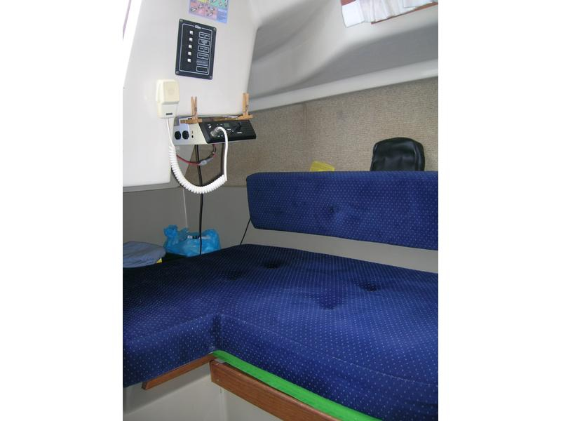

The attached picture may give you some idea as to the bracket. It is hinged along the aft edge. Unfortunately I can't remember the type of hinge or if there was any kind of backing plate. Also you may be able to see on the bulkhead there is a ledge, approximately 2"x2" to support the forward end of the extension. The cushion that fits there is the back cushion from the quarter berth.

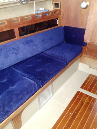

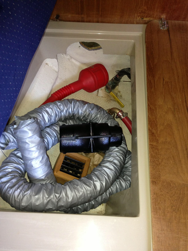

I have a 1985 O'Day 23. The port side on mine does have two ledges and a piece of plywood that slides out. I am sorry I do not have a good pic- there is no support underneath and I was hesitant at first to actually lay down on it, but it does hold me with no noticeable sag. I weigh in @ 190#. I also have storage underneath and I do have to slide out the plywood/ cushions to get to it. The wood has a nice wood trim that also acts as a way to grip the plywood.

The extension on ours (1985 model) was pretty much a sheet of plywood as you say. The trim on the inboard side was attached to the plywood rather than the bench seat. The extension just slid out over the hatch boards onto that folding support and the ledge on the bulkhead. There was no track. We did have the same hatch boards you mention. We would just slide the extension out a few inches past the sleeping position to be able to open the hatch boards and access the storage. Attached is a picture of the extension fully out to be able to access the storage.
To hold the extension in the sleeping and sitting positions were a couple of sliding pins that slid into pre drilled holes in the wood on either end of the settee. The pins were mounted on the extension at its front and aft edges. You can see the one on the front edge, and the two holes for the sleeping and sitting positions in the attached. One word of caution - Don't forget to latch those pins when you go out sailing, otherwise you'll be surprised to hear the extension flying across the cabin when you get hit by a 30kt gust on port tack.
