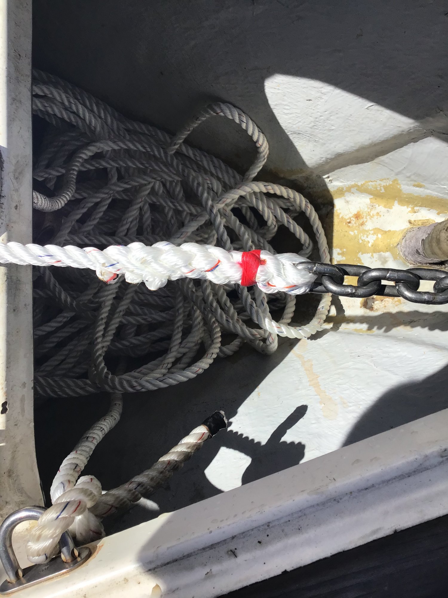

b. Samson has a good guide to rope. Samson Rope Guide. Also Marlow. Marlow rope guide. Age is not mentioned by either. See the pattern?
Looking over the references you give above plus others, I do not see mentions of “age” per se (except as noted above for Cancord Ropes), but I do see discussions on when or whether to retire your rope. The Cancord site might have meant to suggest the service life for nylon rode rather than a shelf life. Section D of the Sampson Guide recommends considering, among other things when inspecting for possible retirement, “the time it has been in service.” As with Sampson, Marlow details several “Lifetime Factors” that affect one’s retirement decision for his/her ropes. The word “age” does not appear but everything listed is related to the amount and type of use the rope has received during its “Lifetime.” Where climbing ropes are involved, I see admonition at another website (artofmanliness.com) to “replace regularly” depending on amount of use, but all within 7 years of service.
In my thinking, “time in service”, “retirement”, and “lifetime” all refer to the age of the rope; more directly to its amount of use. All of the manufacturers give guidance on when one might retire the rope from service and replace it.
Regarding my insurance comment, claims for losses that clearly do, or might, result from lack of proper maintenance of the yacht or its equipment will be challenged. Perhaps age is not the best reference term; condition might be preferable. However, I cannot believe that for a loss due to a parting anchor rode the ins adjuster would not examine the rode for condition. It might then fall to the owner to prove that the equipment was not beyond its viable service life and that it had been properly maintained according, most likely, to the manufacturer’s guide you cite above which mentions “time in service”, equating to its age. For example, “Does the rode show excessive wear or degradation for its age?”, etc. There is an evident and acknowledged longevity expectation for the safe use of rope based fundamentally on its age, but also on its use and care. Whether it’s 10 or 20 yr, or other, is the debatable question.

I’m sure that’s what most of us do. But after at least 15 years of service and having to repair the splice anyway, plus it (the rode) having other signs of wear, especially near the deployed end, I opted to “retire” the old man!!
