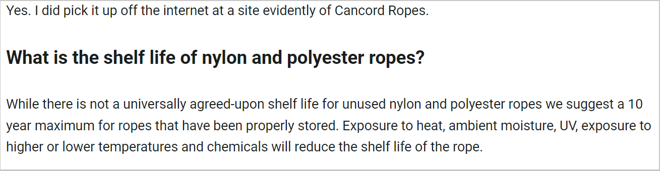

Yes. I did pick it up off the internet at a site evidently of Cancord Ropes.
What is the shelf life of nylon and polyester ropes?
While there is not a universally agreed-upon shelf life for unused nylon and polyester ropes we suggest a 10 year maximum for ropes that have been properly stored. Exposure to heat, ambient moisture, UV, exposure to higher or lower temperatures and chemicals will reduce the shelf life of the rope.

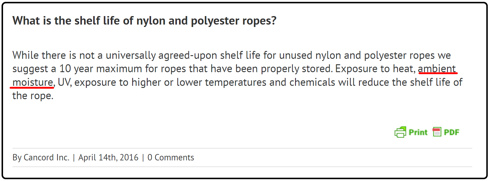

Remember, if you want it to last ten years you must store it properly and that means no ambient humidity.

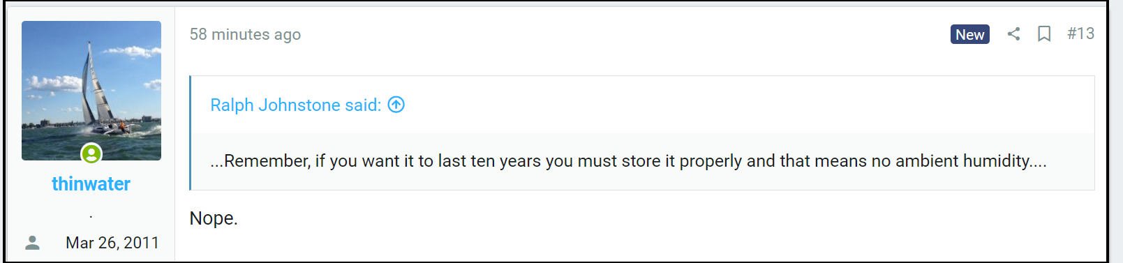

...Remember, if you want it to last ten years you must store it properly and that means no ambient humidity....
Nope.
a. Nylon is used for deepwater mooring ropes, sometimes for periods that long. Nylon is used for plumbing fittings. Moisture has the initial effect of weakening nylon, but there is NO deterioration effect over time. None. This just does not square with observation and long established uses.
b. I have tested ropes stored in basements and stored in wet bilges for 20-30 years. No effect.
This is a boilerplate statement that comes from natural fibers in the past and non-technical writers. Pure myth for nearly all plastics. Samson and Marlow make no such statements.
