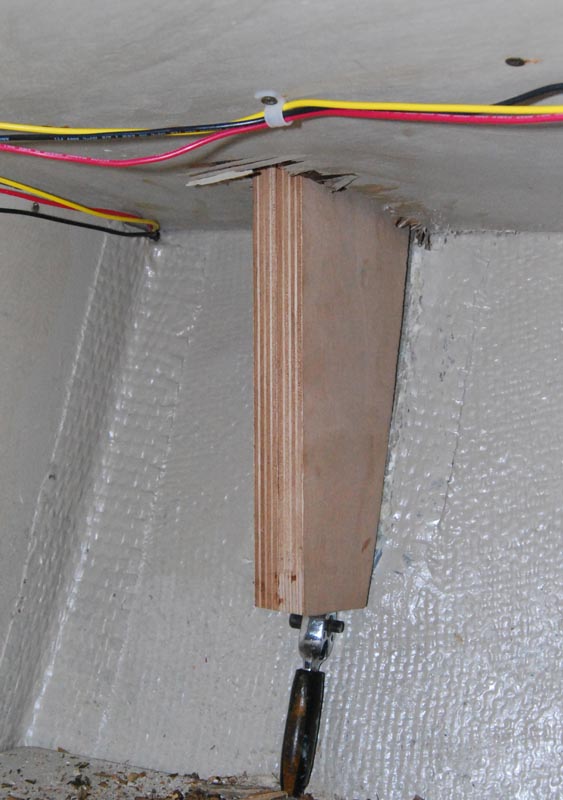

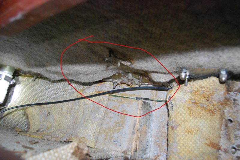

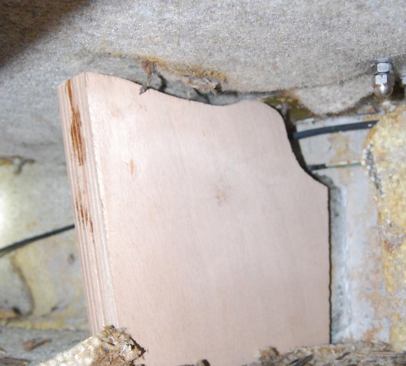

I've got the old knee out (that Dremel carbide blade Woody recommended fit right in my Bosch multitool and really cut through the roving nicely). I'll attach some shots of the new knee in rough position, with some cleaning up on the hull still to go. The third picture is of the underside of the deck, where the old knee butted up, but was not attached. I'm thinking about cleaning off the carpeting and epoxying the top of the knee to that area to add strength and to help keep any future moisture from penetrating. Cleaning out the deck rot will have to wait until warmer and drier weather. Any tips on how to keep the holes in the knee for the chainplate (which I've yet to drill) clear while I fiberglass things in? Sorry I haven't had the Shop Vac at the boat to clean up the rotted bits.
