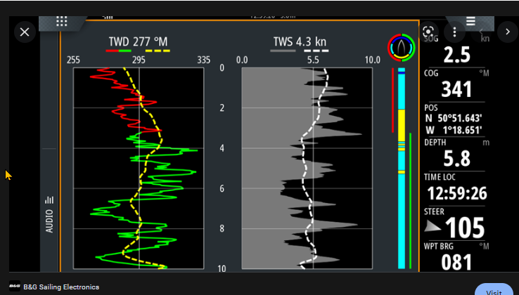

I don't intend to do the calculations by hand as I sometimes short hand the boat and want the system to show me the Median and Current wind plot as shown below so that I can predict what phase the wind is in. This is a screenshot from the interwebs. My advanced wind plot doesn't show any data because TWD is blank.

Sounds like I need at least one more sensor to make my dreams of laylines and wind shifts to be graphically displayed on the Chart Plotter.
Update, I called B&G and technical support said I need the following for this to work....another $800 worth of transducers and won't be possible until I haul out in the fall
Depth, Speed, Temperature Triducer (B&G) -$400
GPS Antenna w/ Compass (B&G) -$300
These things being NMEA2k I'm thinking I can find Similar or good enough sensors...I don't need Gucci Gear for this, I'm in a pearson 26 that has more money in electronics than the rest of the boat and sail inventory is worth and I don't want to tip the scales too much further in that direction to be honest.
