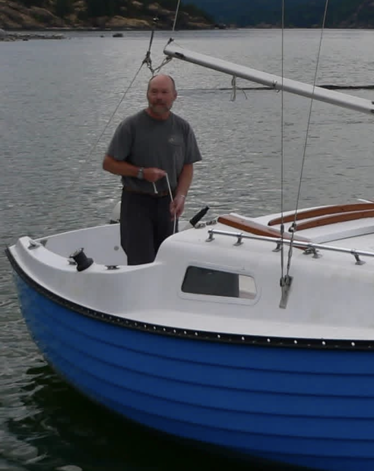

Here is a Monty 17 owner in BC with standard winches and cam cleats to hold his foresail.
Her owner, in the cockpit, rigged with a pair of small winch snubbers and cam-cleats. This setup is somewhat affordable (If you can find a #8 or #10 snubber winch at a price under $250, and it is in serviceable condition). It addresses the ideas you query.
