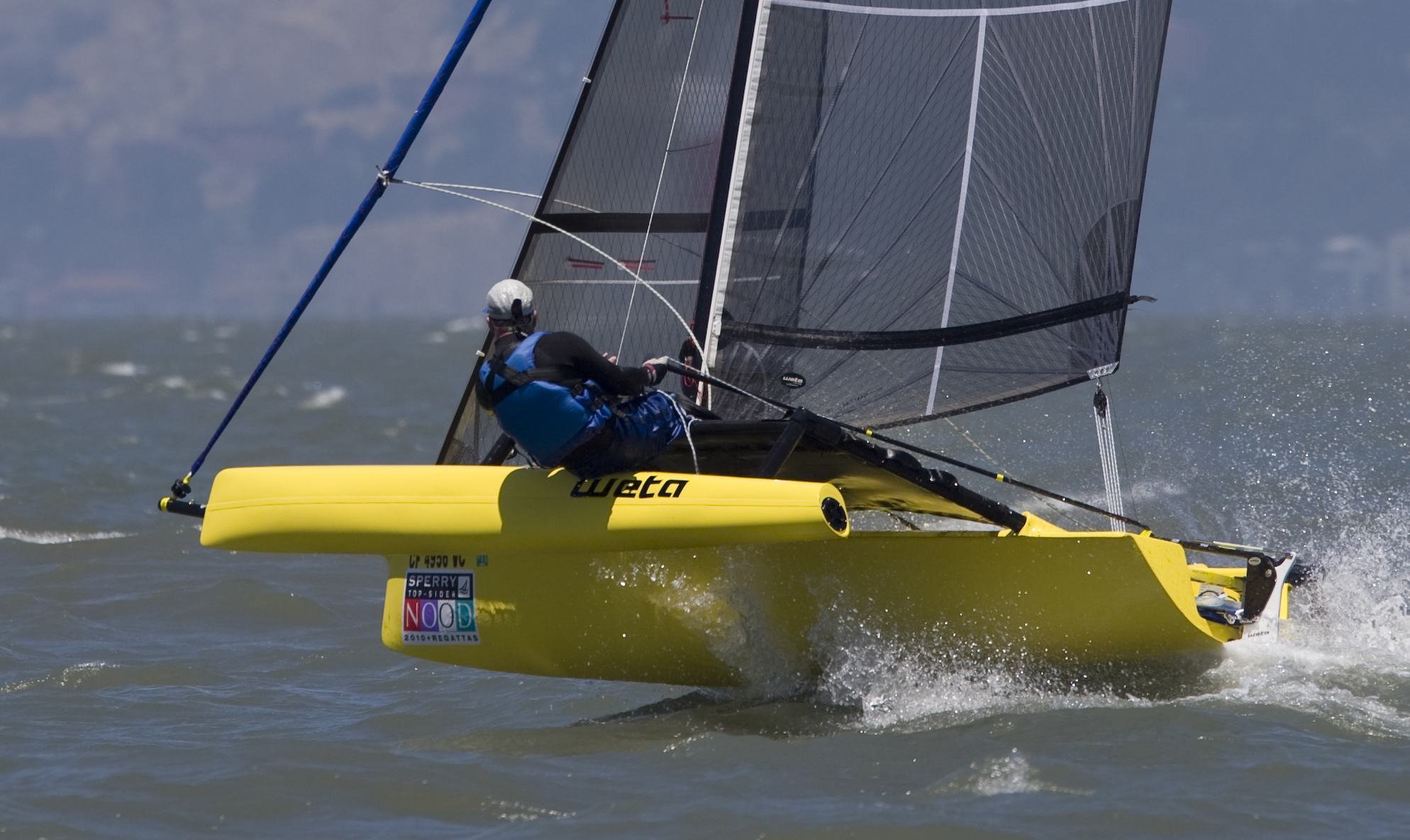

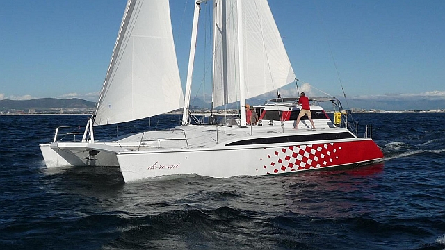

Here are a few examples of boomless sailboats.
There are a few examples of boomless self-tacking staysails. They all seem to utilize a traveler and so limit the size of the staysail to maybe 110s. However, I can imagine a 155 Genoa sheeted on a looped line that runs through blocks to guide the clew around the mast and stays. I am not clear on how to adjust the sheet for points of sail, but I'm sure it can be worked out.
Actually it can't. You have to adjust sheets accounting for the clew being aft the mast on each tack. If you're adjusting sheets, you don't self-tacking system.
