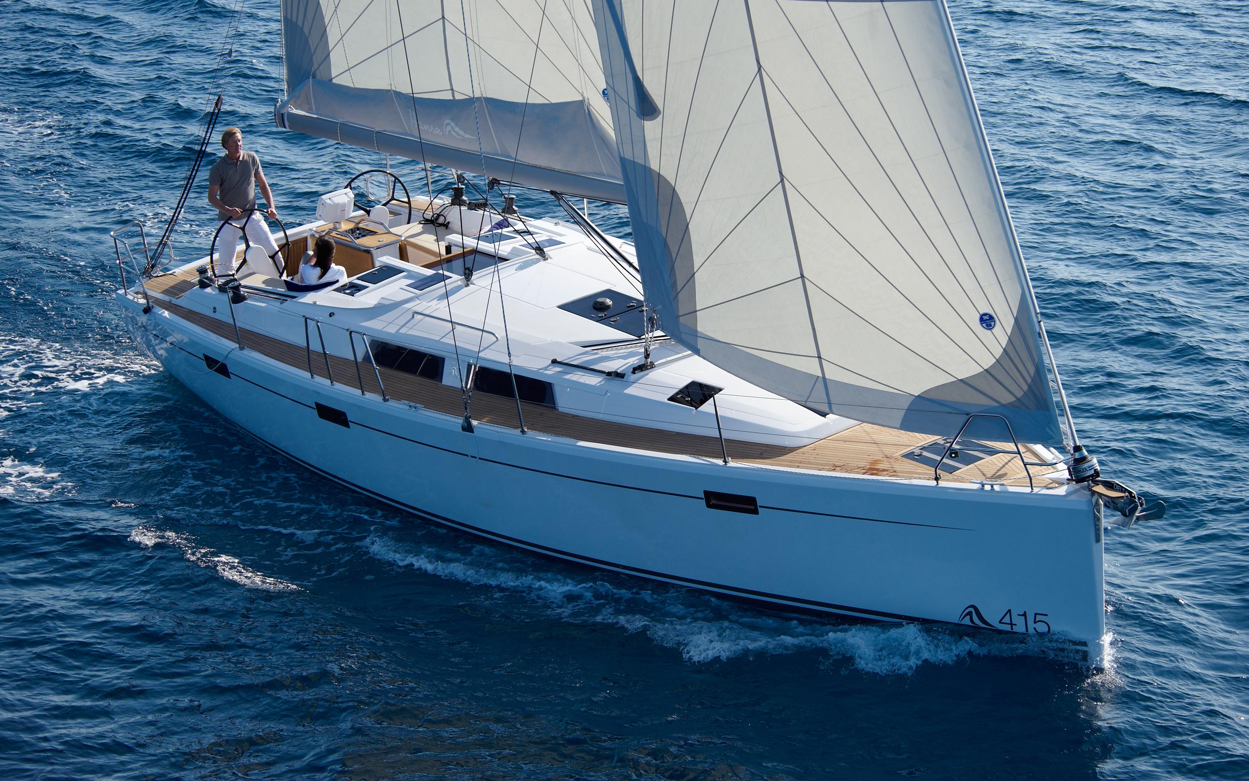

Self tackers have really come into their own in the era of main-driven, non-overlapping rigs. Its no surprise to me that a masthead boat with a tiny main that is supposed to have a big genoa is turd with a ST jib.
A friend of mine has a new Hanse 415. Fractional and designed for a track ST, the thing is a witch upwind. Things rates like 68 in PHRF. That will destroy anything south of a First 40. Or the late lamented Blue Jacket 40. Now THAT was a nice boat. Again, ST from the ground up, this time with a Hoyt boom.
Nov 8, 2010
11,386
I'm sure the fore-boom makes a difference!
Indeed. It actually helps more for off-the-wind sailing, when you want the clew out but not up. The track on the 415 is better for upwind work. Well designed, you can really get some nice trim.
Hanse uses a very clever sheeting scheme. The single sheet comes from a common pivot point not on the foredeck, but UP THE MAST. Like a topping lift. Nice.

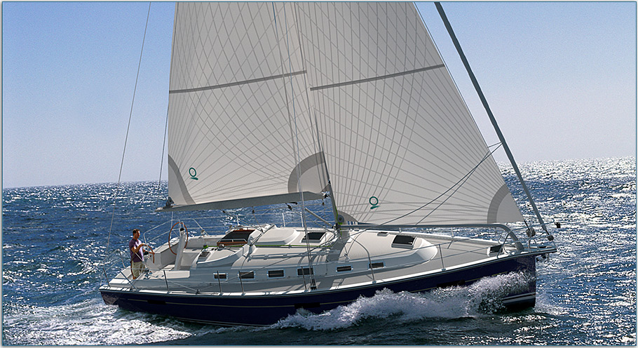

There may be a little bit of "apples & oranges" here I now see. In the first pic the ST was mounted to control the sail on an inner stay. I know we see these fairly often in some cutter rigs. I once sailed on a IP-37 to Dry Tortugas rigged with a ST staysail on its own boom. In the Hanse you pictured the ST is on a track as in the P-34-2, but it controls the principal headsail, not a staysail or variety of. Which are we discussing the merits of?
Nov 8, 2010
11,386
Both pics show the boats with their jibs.
The BJ40 has a code 0 of a furler in front of the forestay, out on the prod. It trims like a spinnaker. Its for light air reaching.
