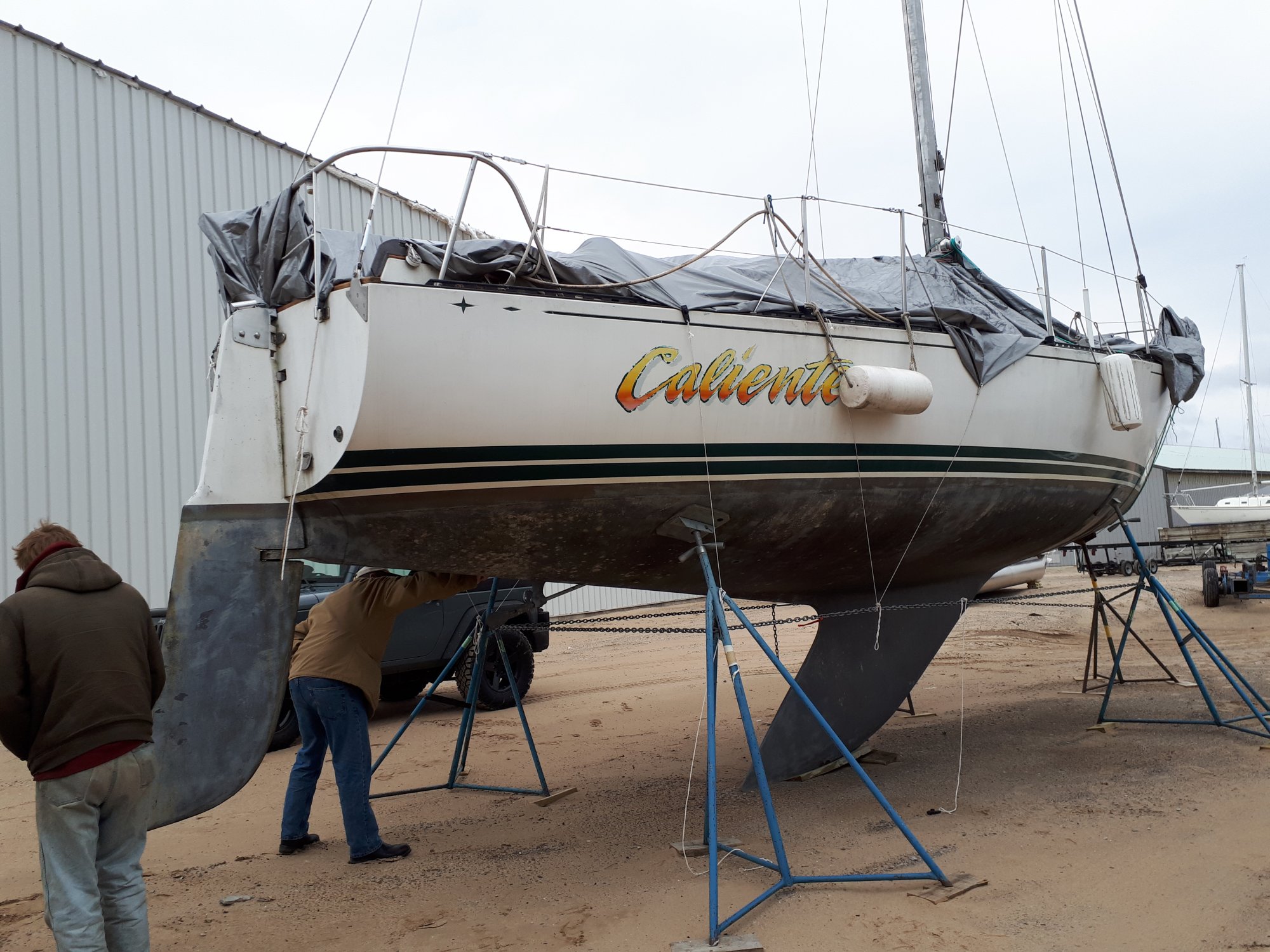

24,623
My oh my. That is a huge rudder. Looks almost bigger than the shark fin keel.
Tell us how she sails.
