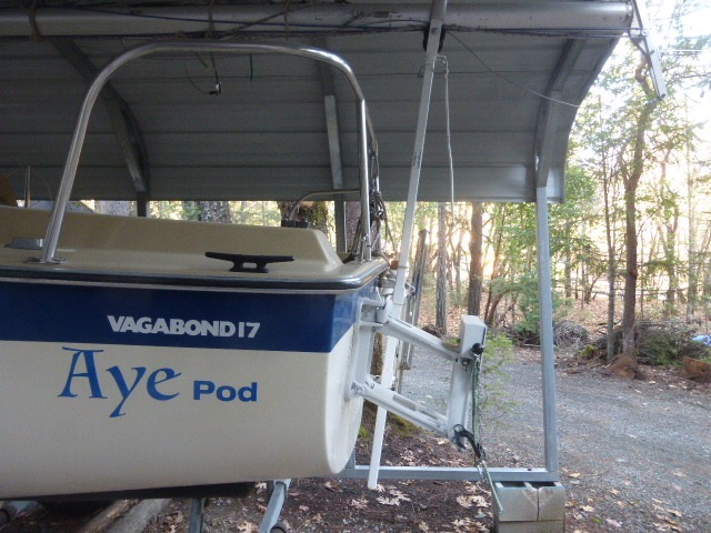

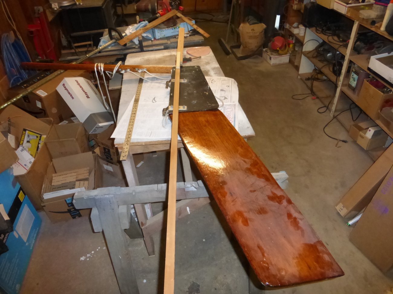

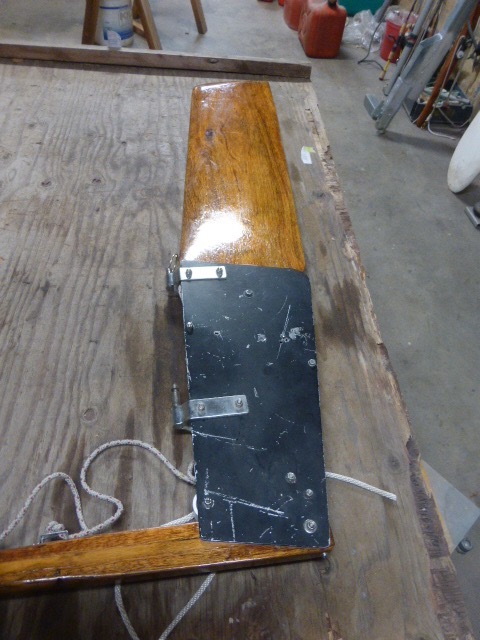

Now that you mention it, I can certainly vouch for the steering effort conversation ;) . When I first purchased our little boat (V-17) it came with the oem rudder assy as well as an aftermarket unit. the po told me the boat was "hard to control" with the oem unit and was the reason he only used the aftermarket piece after that. well the aftermarket unit weighed a ton, and I prefer wood, so I set about testing for myself. he was right!!... when hit by a strong gust it took both feet on the opposing side of the boat and both arms to pull the tiller back :yikes:. when I returned home and did some investigating it became pretty obvious what the problem was. I found no obvious reason why it was this way, and no extra "non factory" holes, but the stop bolt for the rudder forced the lower portion to sit almost 11" out from the pivot axis.
I drilled a new hole for the stop which set the lower rudder perpendicular to the water line when installed on the boat, which obviously made a HUGE difference in steering effort.
Now I'm wondering how it would react to being angled forward to the limit of the transom angle... huum.. I gotta try that just for my own curiosity ;)
