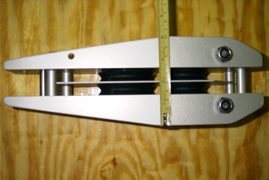

Any idea how i could replace the sheave for my Mains halyard at mast top without lowering the mast?
Hi Ken,
Below are two pics which Selden sent me back around 2001. I used them for planning the installation of a wind indicator. As you can see, both sets of sheaves will be in use as you climb the mast. One set for climbing and the other set for your safety line. Just can't see how you're going to remove that sheave unless you sprout wings. I feel your pain as that's going to cost bucks. Any mast towers in your neighbourhood ?

OOoo..Boy! It didn't occur to me that I'll be dismantling the very sheave that brings me up there!!
No mast tower around. Thanks Ralph.
Looks like I've to put more job items for the mast to make worthwhile to lower the mast.
