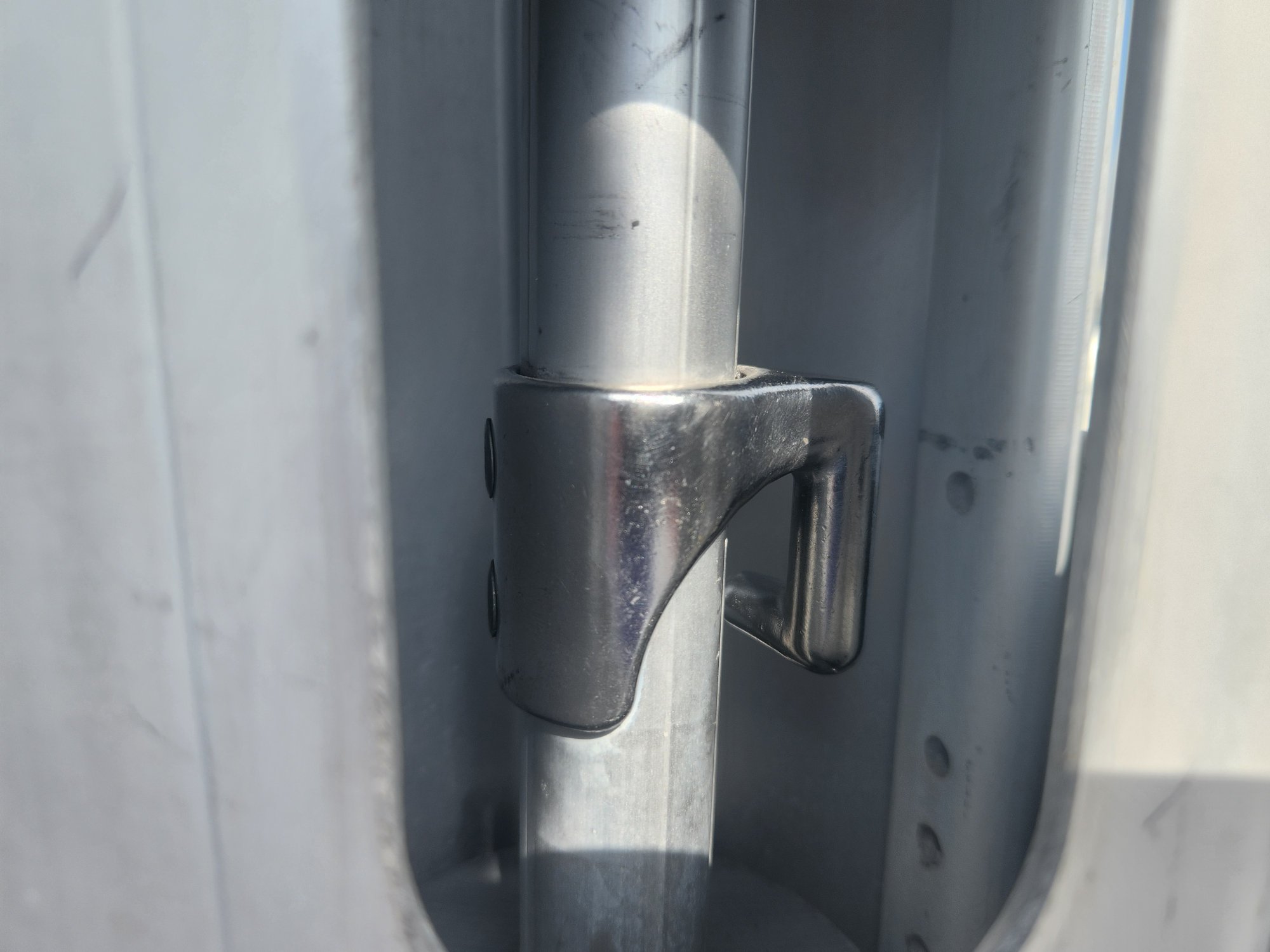

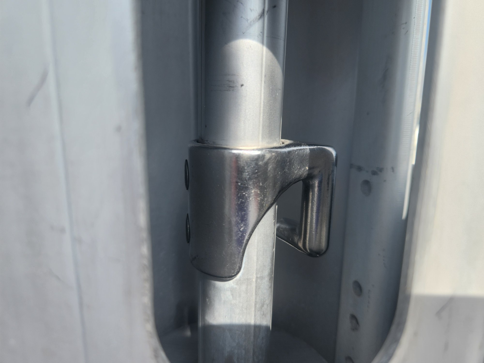

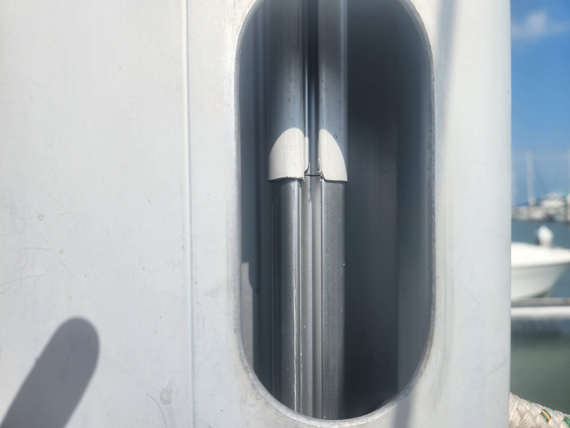

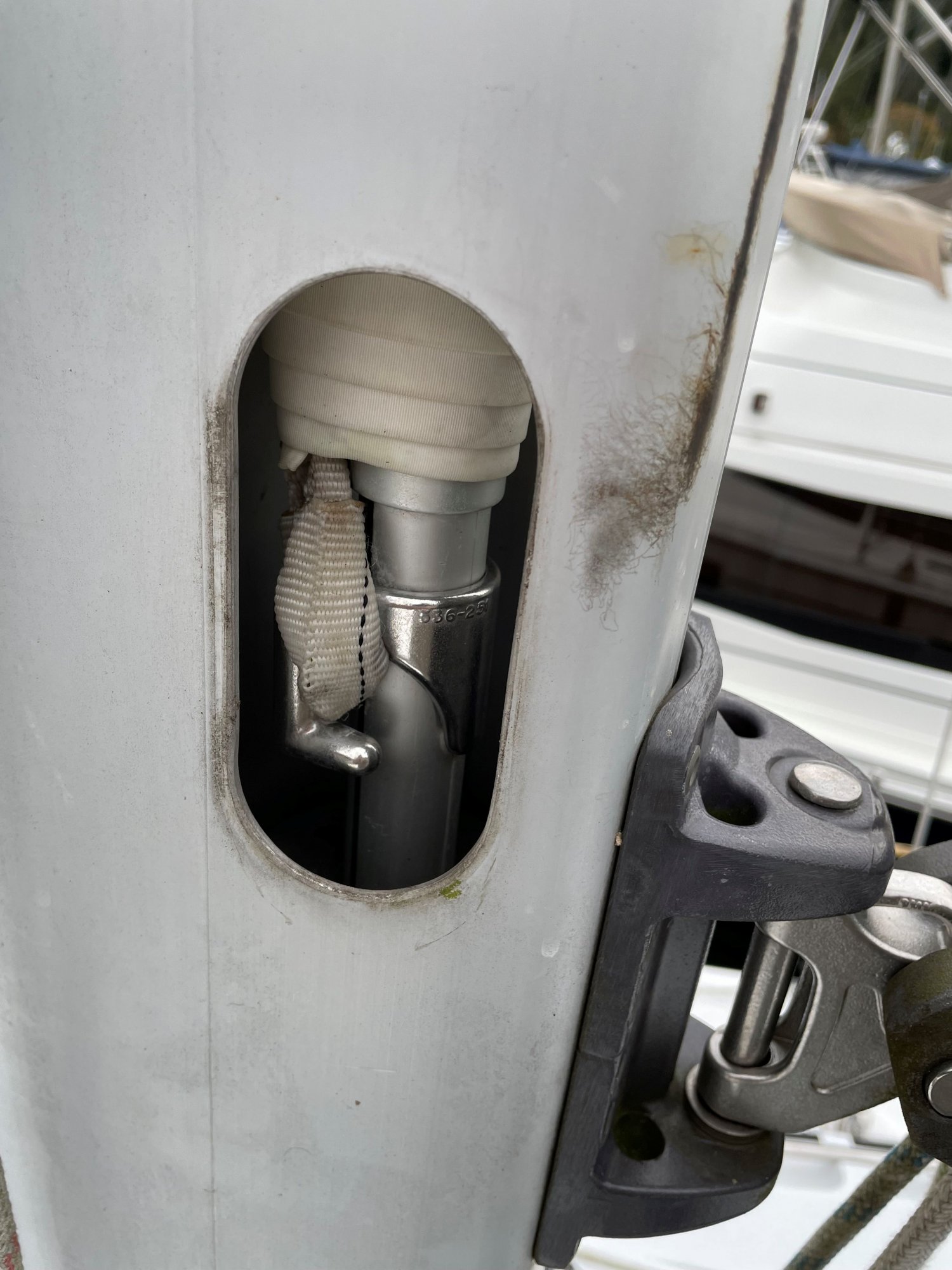

Rigger took mainsail out then ghosted. Went to put it back in (1st for this newbie), which appeared to go fine...then wasn't going in right. Bottom of sail was bunching. Kicker boom vang tightened down...not truly perpendicular but close. On review, the hook for the tack is 90 degrees off from the groove the sail is going into...so it doesn't start twisting at the same time...appears to be my issue. Am I missing something? The head goes straight on just fine. If 90 off on tack is OK, do I need to start wrapped in a certain direction first? I see no immediate path to fix this, since the set screw on the threaded part appears bent over ATM and jammed..probably why the rigger bailed. Wonder if he did that or previous owner. Any thoughts people? If you look at the attached pics, you'll see in the mast openings for setting up the sail, that the groove is 90 degrees off the tack hook...

Correction...sail hauled up and went in track fine. Furling no bueno
The SS tack hook should be aligned with the groove. If the rigger tried to adjust the foil tension, he removed a set screw, lifted the locking tube, and got the locking tube out of alignment with the SS tack hook.
Go to Selden.com and get the document for adjusting the foil extrusion and you will see how to align the SS tack hook with the extrusion.
Once this is corrected I set the boom height with the topping lift. To do this mainsail halyard to be tight so no horizontal wrinkles at the bottom of the luff tape. Loosen the topping lift so it is loose and the sail is holding the boom. Outhaul to be tight. Mainsheet to be snug. Now tighten the topping lift. MARK THE ROPE AT THE CLEAT OR ROPE CLUTCH. This method works for most all sails. If the boom ends up with an angle greater than 87 degrees, it will not furl smooth.
To furl the mainsail, be on a starboard tack slightly is best. Loosen the mainsheet. SLIGHTLY loosen the outhaul and keep some tension. Pull furling line to roll so extrusion turns COUNTER CLOCKWISE. Let the outhaul out as you furl the mainsail but keep some outhaul tension. Sail should roll up fine.
Mast should be very straight with no PRE-BEND.
If the mainsail is DACRON, and over 5 years old, have a qualified sailmaker with furling mainsail building experience check the shape. You can take photos of the sail from under the boom with the outhaul tight and post it here and I can
let you know about your sail camber.

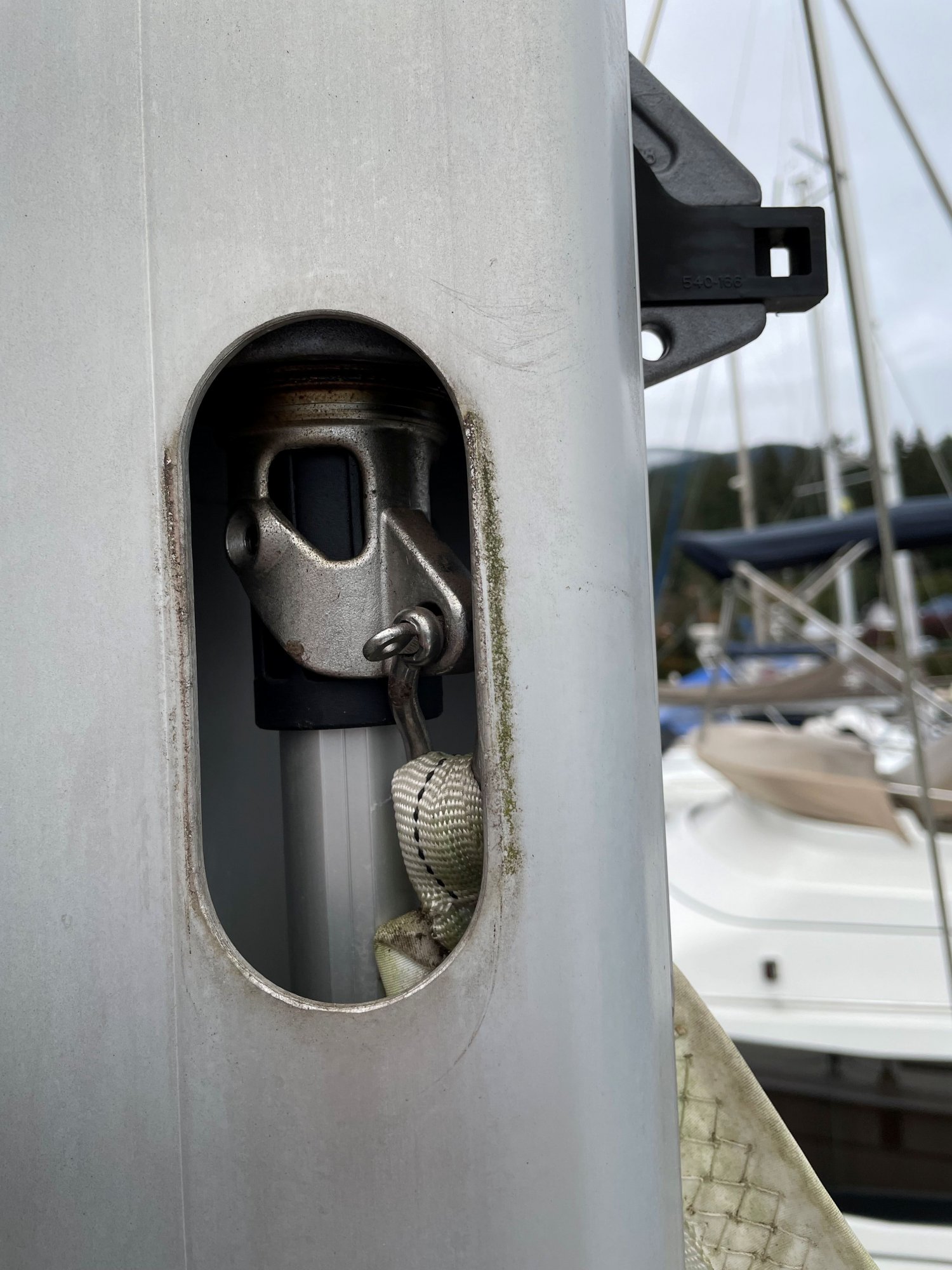

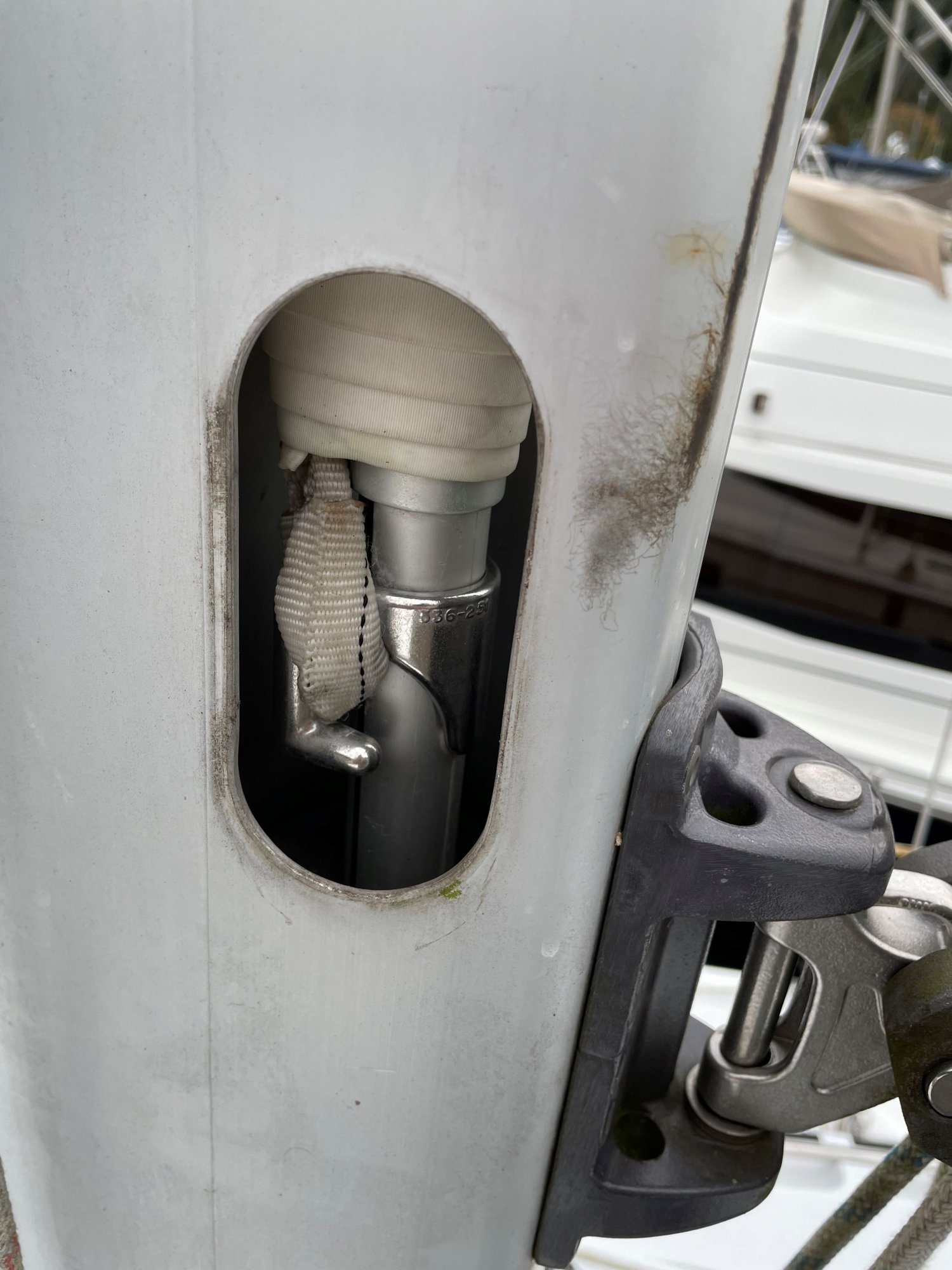

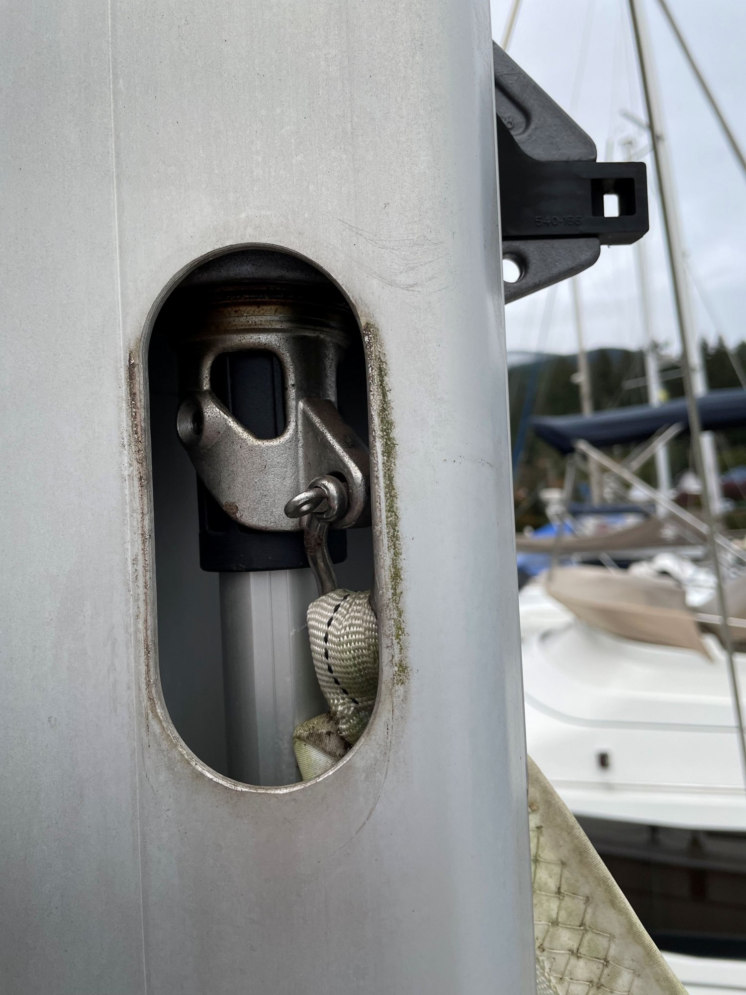

Hello, not sure if this is helpful as my boat is much smaller. Here are pictures from my Hunter e36 with a Selden mast. I took these before I took the sail down for cleaning. Connected it up the same way after cleaning and it furls in just fine.

I managed to get them aligned and get the sail reinstalled for our trip. I'll have to go back and fix the set screw later.
