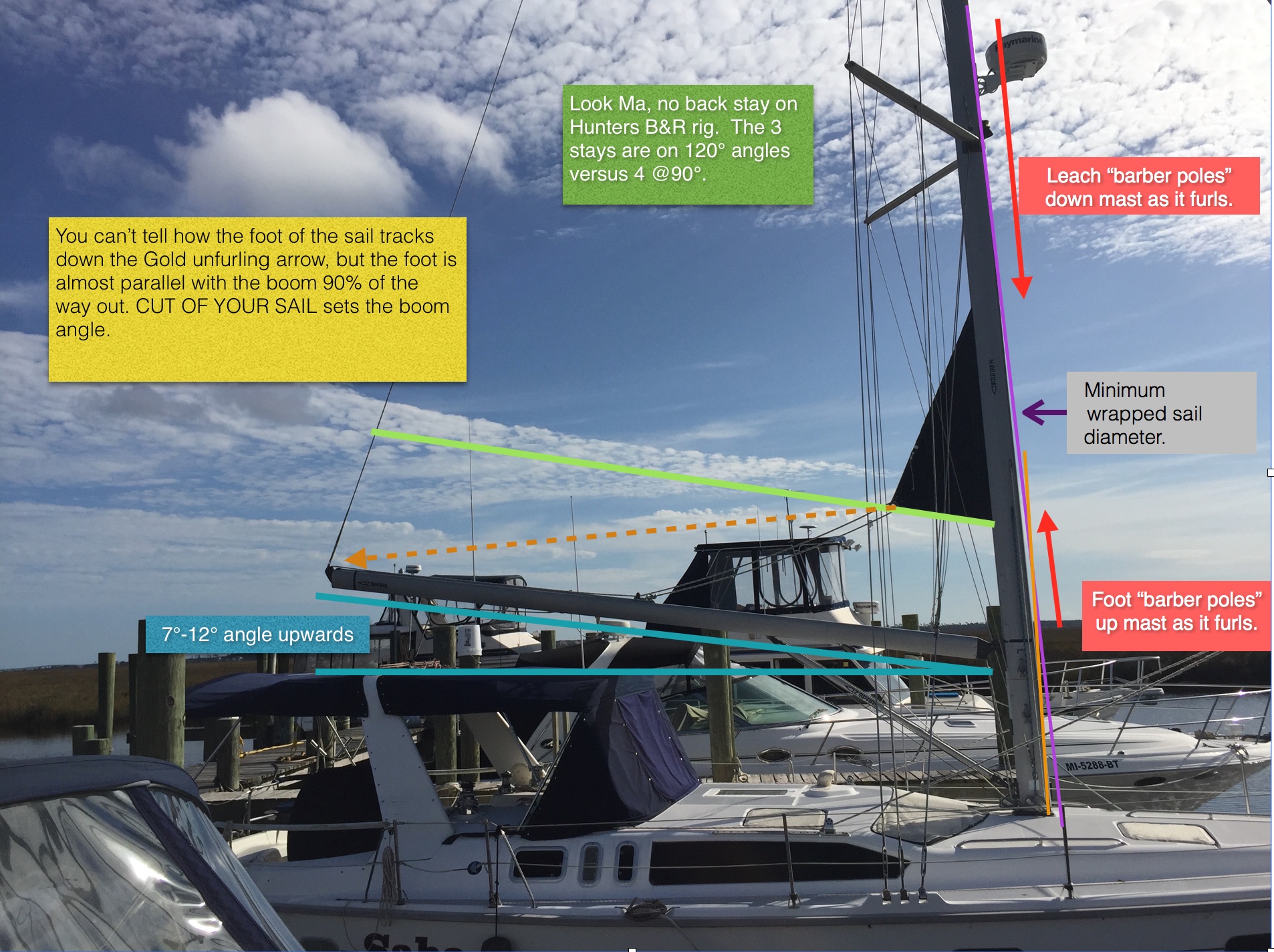

Normal Main sails for In-mast are not 90° .
My Main Sail is 83° which means I have to use my Boom lift to Set it UP about 7° from Horizontal.
Hope this picture helps.

PS: I was guessing my angle when I took that picture. Later I found my angle was exactly 7°.
PSS: The Orange and Purple Lines show the Mast Pre-Bend is where it should be!
