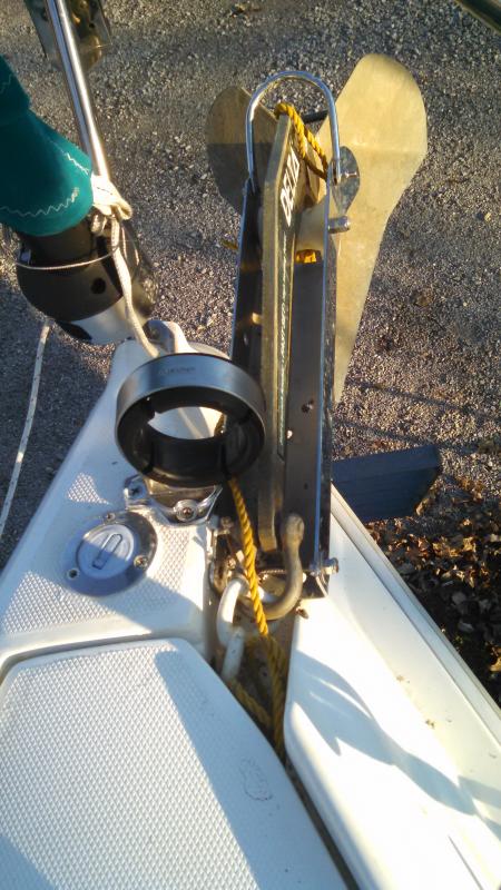

Update on Bowsprit Install
This weekend we got the Selden Bracket successfully installed on the foredeck of our H-260. Very tight. Was especially fun down in the v-berth tightening the bolts/washers beneath the deck. Thanks Dave for the tip!
Stay tuned.
