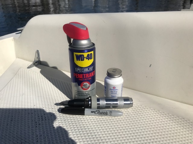

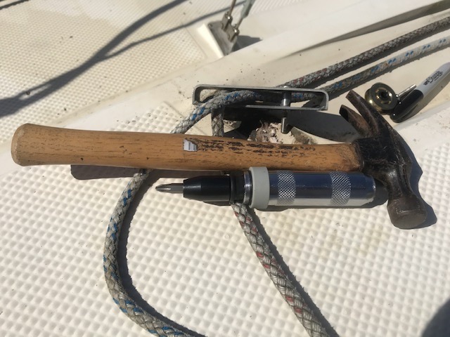

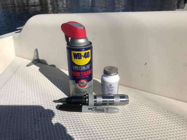

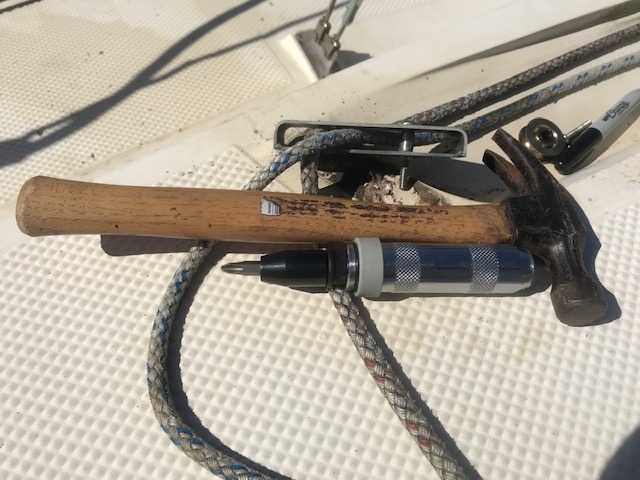

Got it out! thank you all for the help!
I used WD Specialist Penetrant over the course of 4 days. Applied it in the AM and the PM. Then used the manual impact driver that rgranger suggested. I marked the screw head with a Sharpie to see if it was turning. It took time & patience but it worked. I will use anti-seize lubricant when I reinstall. And a new bolt. Thanks again!
Also, ya gotta give me props for using the word sheave instead of pulley.
