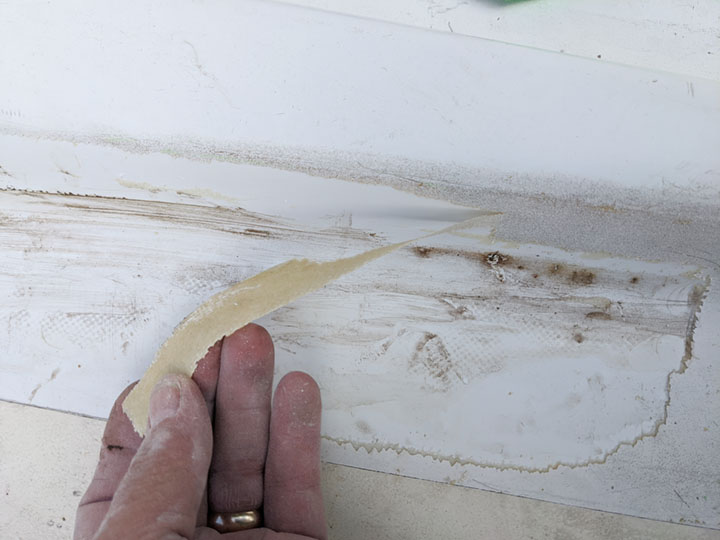

I came to the realization today that one of the previous owners of my Hunter 170 decided to overlay the gunwales and deck with a layer of fiberglass, presumably to cover some cracks that were appearing in those areas. Trouble is, a lot of that is delaminating and is either falling off or needs to be peeled off. Spent the better part of the day pulling these sections off. Now I need to try to seal them, sand them, and paint them. Fun and games!

The sad thing is that it appears they put a lot of effort into it. Didn't really look bad on the whole, but talk about ill-advised!
I got the worst of it off and sanded out today. Final sanding and painting remain. I'll just have to wait and see if any of the rest of it starts to come loose.

Does it looked like prep was done on the luran? All scuffed up and what not?
Its really hard to get luran prepped so that large areas will accept epoxy. It "fish eyes" like crazy, and the dust will fish eye a perfectly good application.
Remember the coefficent thing? The luran was expanding at noon and contracting at dawn. The glass on top less so.
I have a big job that i still consider experimental. But so far so good. The key was minimal overlap

No, the Luran looks smooth except for a few places where they patched moderate cracks. That was the main thing that tipped me off. When I removed the first bit of delaminated glass, I was thinking "This looks more like a finished surface than the finished surface". Lightbulb moment. I think they were going for a consistent look for the final layer, because there were not really very many cracks. I think they would have done better with some JB Weld and a coat of paint, which is what my current approach is. I have found a very good color match with Rust-Oleum Painter's touch 2X Ultracover White. I will use gloss for the hull and flat for the upper deck.
Overall the boat is sound. I have found one spongy part on the lower deck a bit aft of the centerboard, but that's another project for another day.
