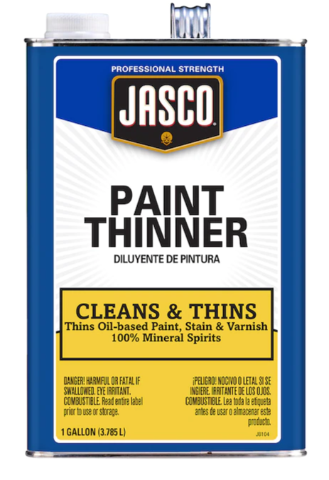

And I am a Ph.D. chemist. Also you opened with ..
Their web site SDS says the appropriate thinner is aromatic and aliphatic hydrocarbon.
Those are kind of on opposites ends of the hydrocarbon scale. Aromatics have benzene rings ... aliphatic are straight chain... Gasoline is an example of a mixture of the two...
I'm going to guess hexane will work but honestly any organic solvent that seems to thin will probably work. Mineral spirits (from Lowes) is the safest. Be mindful of the flashpoints (spontaneous combustion) of the solvents you are using. Mineral spirits is 100F. Xylene is ~90F. Both are high enough that if you work with small amounts in a well ventalated space you are probably safe from the on looker who lights up a smoke.
You could do a small test with some commercail paint thinner. They sell this at Lowes. I'm going to guess it is made in the same factory as your epaint thinner.
