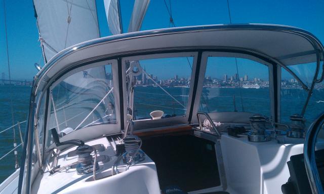

I use separate self tailing winches on both my jenoa and main sheets. The jenoa sheet winches are the outside ones on the cabin top and the main sheet winch is the inner one on the starboard side of the cabin top. This allows me to quickly release each or both in the event of a gust and makes it easy to tighten up the sails. An alternative for a small boat that does not require winches to tighten the sails is to use a cam cleat.

I use separate self tailing winches on both my jenoa and main sheets. The jenoa sheet winches are the outside ones on the cabin top and the main sheet winch is the inner winch on the starboard side. This allows me to quickly release each or both in the event of a gust and makes it easy to tighten up the sails. An alternative for a small boat that does not require winching to tighten the sails, is to use a cam cleat.
