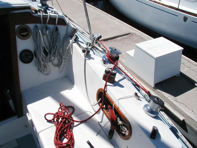

I would never use a captive style cleat, such a the aforementioned Spinlocks. Most older, smaller vessels came equipped with a "jam" cleat... i.e. it looked like a small horn cleat with one of the horns tapered towards the shank so you could "jam" the sheet under it.
I would never use "winchers" on sheet winches either... I have used them on halyard winches, though. The reason is that you must fill the drum with wraps all the way up to the underside of the wincher, where the grippers are, to make it work. Then...... to unload the drum, you must uncoil the wraps from the drum, rather than simply pulling up on the sheet like you can with a standard winch. Totally slow and a pain in the ass. And all this for the sake of using the wincher as a cleat replacement.
No........ use an open cleat... no fairlead, no captive style cleats like spinlocks... nothing to restrict your ability to quickly disengage the sheet. And.... you want the cleat located to secure the "tail" of the sheet, not between the winch and the sail.
On my boat I use open "clam" or "vee" cleats, and "cam" cleats. If you look at the picture you'll see from front to back... 1. a cam cleat with fairlead, for EZ glide jib car control line. 2. Primary winch cleat, open cam on riser to prevent overrides (no fairlead) 3, small, open cam cleat on deck for jib downhaul. 4. Secondary winch, open "vee" cleat (again, no fairlead)

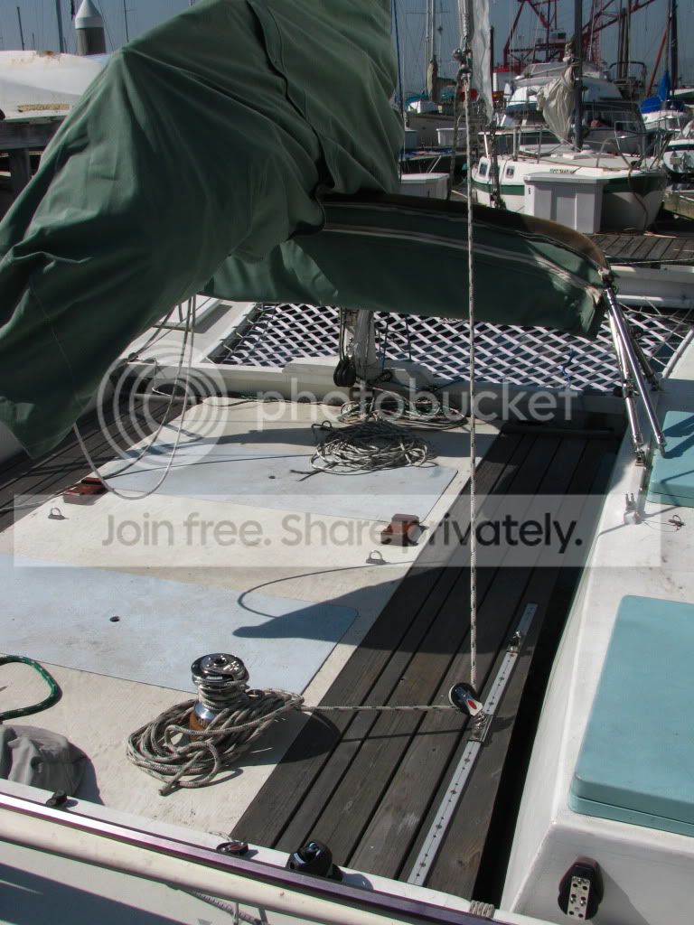

I use the smallest self-tailers that Andersen makes:
Defender was having a sale! BTW, the sheet is not kept there when actually sailing!

A 155 in an area prone to thunderstorms almost has to be a request to be looking down at the mast. I have self tailers - but Joe's solution looks good to me & I think it is pretty typical. Self tailers don't strip as well as standard winches - but they don't seem to jam as long as you are practiced at stripping them.
We have had almost nothing but thunderstorms this year. Apparently the Pacific ocean temperatures are weird and the jet stream is unstable. Almost every time I go out I have to shorten sail. Stuff like Genoa sheets really have to be able to be released NOW. More important is to learn what kind of local conditions can cause the gust in the first place and have the Genoa rolled in some before it gets really bad.
That cleat really does have to be something that can always be released now.
