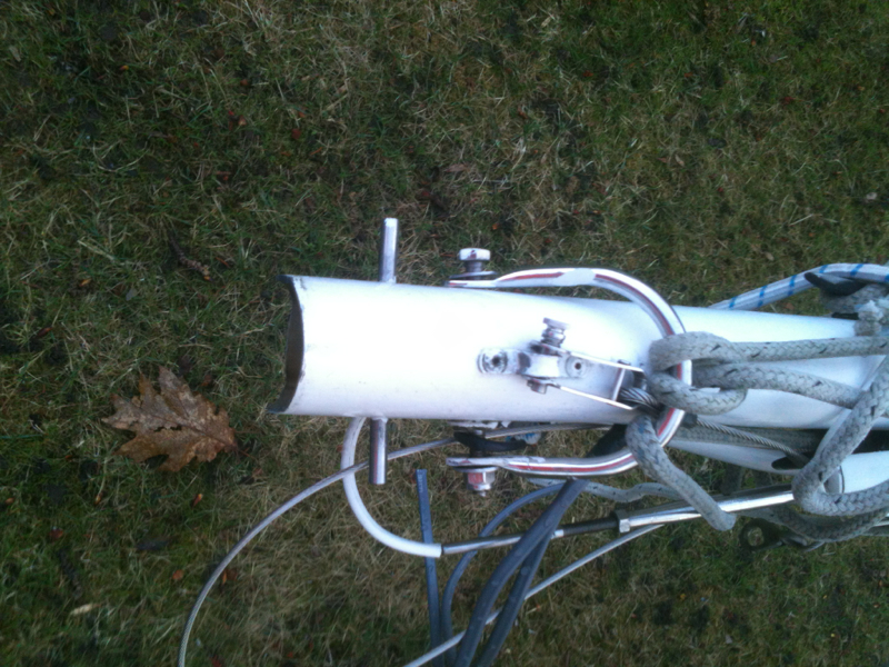

How is the mast secured on the deck bracket. There are 2 pins that slip into the deck bracket but how does the crome plated u bracket feature in the process of securing it? See picture attached. This a 1976 Oday 22.

Just guessing, as your setup is completely different from the one on my 1975 Oday 22.
I think the pins and the bolt are used to secure the mast to the step and that the U is an accessory for storing halyards etc.
A picture of the base the mast attaches to might help.

You have the same type of mast tabernacle that my friend Wayne has on his Seaward 22. When you go to raise your mast, that single pin that is running through the mast fits into the open tabernacle slots on the cabin and drops down to lock in. All your stays need to be connected to the chainplates first, with the exception of your forestay which is then connected after the mast is up.
That stainless steel U bracket or bale is used for connecting your boom vang. The bottom of the boom vang is connected to that and the top part of the boom vang is connected to a bail like that one, or an eye strap on the under side of your boom about 1/3 of the way out from the mast and goose neck fitting.

Daydreamer I think you are correct. On further examination, the u bracket is unrelated to securing the mast to the "step". It appears the mast stays in place due to the tension of guy wires & the angle of the slots that the pins slide into. That brings me to another question. How taught should the guy wires be? It seems the bow & stern are just slightly loose whereas the port & starboard centre wires are fairly tight. Thanks for your help.

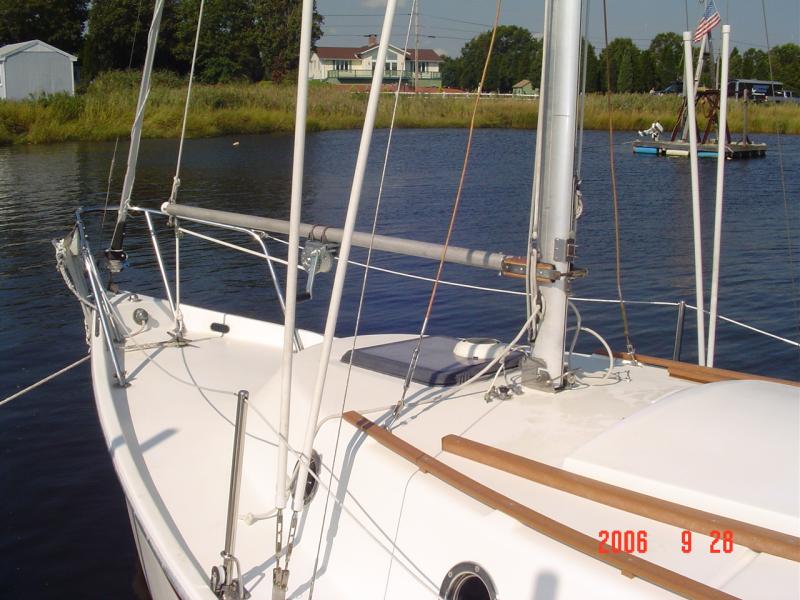

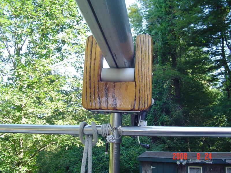

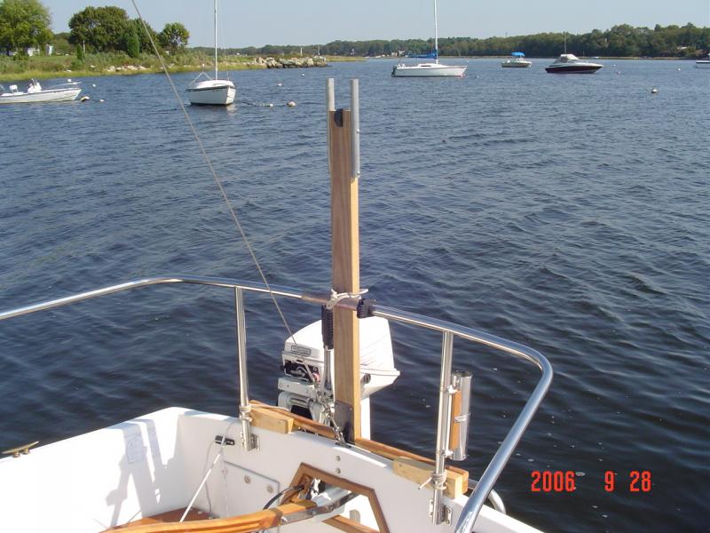

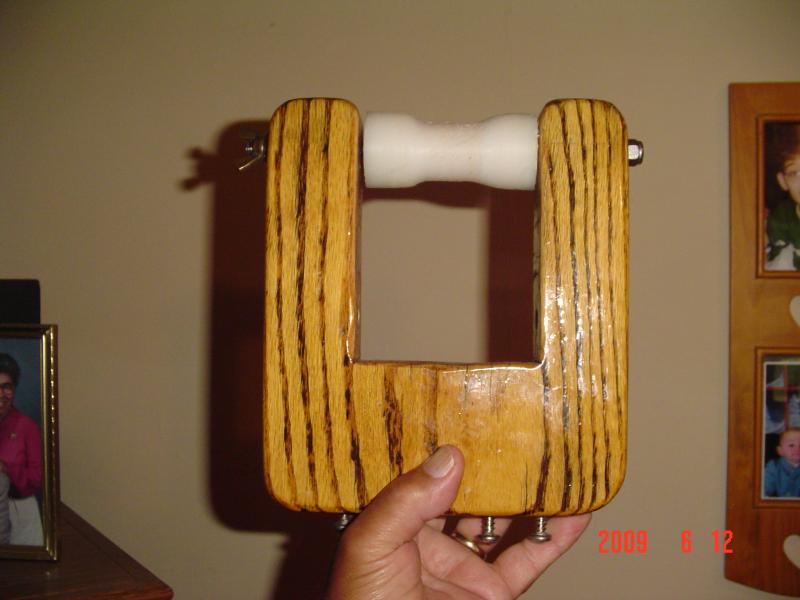

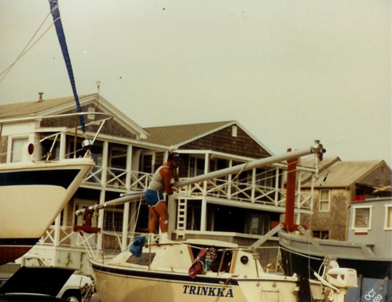

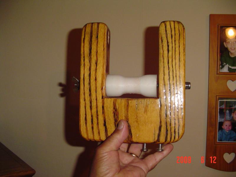

Years ago when I first started stepping the mast on my O'Day 222, the first thing I did was build some kind of a mast supporting device or mast crutch which I mounted on my stern rail. Years later I added a small roller in the crutch to enable me to roll the mast forward or aft.

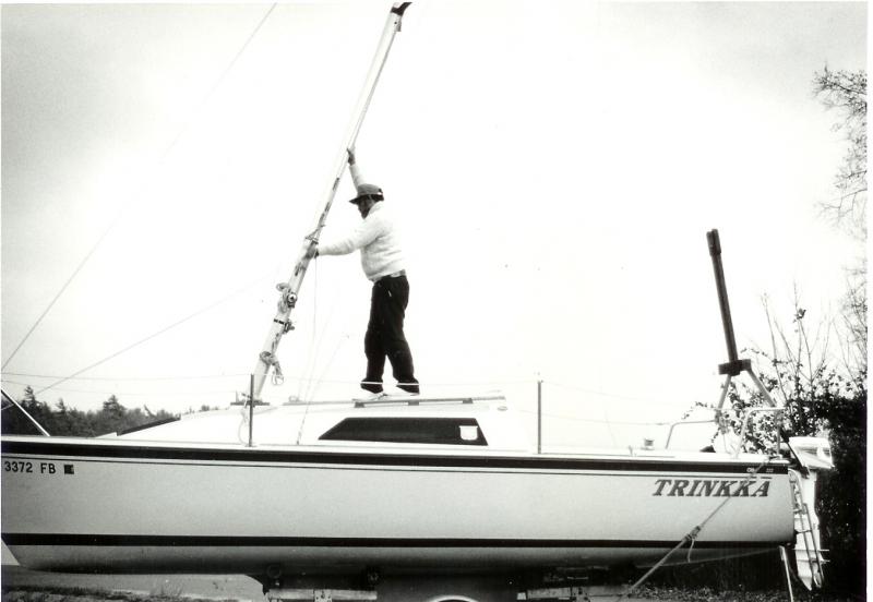

Then I needed something to keep the mast from falling backward after I got it up, so I bought about 65' of 3/8" nylon three strand line and spliced an eye on one end. I ran this line through a single sheave block and attached it to the rear hole in my bow stem chain plate.
Then I would connect my Jib Halyard shackle to the line's eye splice and haul the shackle to the top and cleat off the Jib Halyard at the bottom of the mast.
With the stays all connected except the fore stay which I secured to the mast with a bungee, I would stand on the closed hatch cover with the line in my hand, and lift the mast by hand. As the mast began it's ascent I would put my shoulder into it and push it the rest of the way while pulling on the line. The mast needs to be about 3/4 of the way up for the line to take effect, but once the mast is up I would pull on the line tight and take it around the mast above the gooseneck fitting on the mast so that the rope doesn't slide down, and I would cleat it off on the Starboard bow cleat.
Now the mast was secure and I had both hands free to untie the bungee holding the forestay and connect it to the foreward most hole in the bow stem chainplate. After the fore stay is connected the rope can be let off.
It's very important that you take it slow when raising the mast and keep a close eye on your stays to make sure that they don't get snagged on anything. Make sure there are no twists in the stays or the turnbuckles.
Remember that while the mast is on it's way up or down, it can still go over sideways. The stays are always loose until the mast is all the way up.
If the boat is leaning to one side the mast will lean to that low side and go over if you're not careful.
A strong wind coming toward the beam of the boat can also blow the mast over the side. It has happened to one of my friends and this is why I bring it up.
You may want to build a Gin Pole and use it for mast raising/lowering.

I built an extendable crutch with a roller on it for the stern.
When extended it gives me that first two feet.

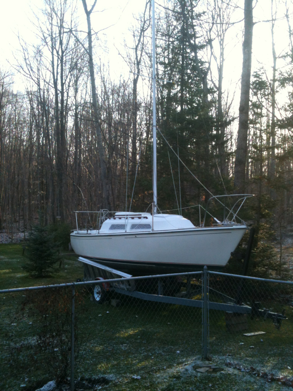

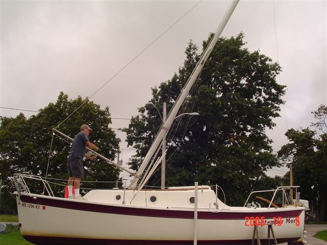

Got my mast up with help of neighbor & you guys. Thanks everyone. You provided some useful info.
Beautiful! That wasn't that hard was it? I notice that you have a stern rail on your boat which can come in handy for supporting a detachable mast crutch. All you need to do is design something to fit that rail which can support your mast when you want to raise or lower it. You could put a small roller in the crutch so that you can roll the mast forward or aft.
I had to be able to change the position of the roller in my mast crutch because sometimes a stay would get caught in while I was roller the mast aft and I'd have to walk aft to clear the snag. I cured that problem by being able to move the roller up higher. At any rate, having a built in roller for the crutch is better than having to lift the mast and walk it back and forth each time I raise/lower the mast and there's less chance of slipping and falling off the deck with the mast in your hands.
