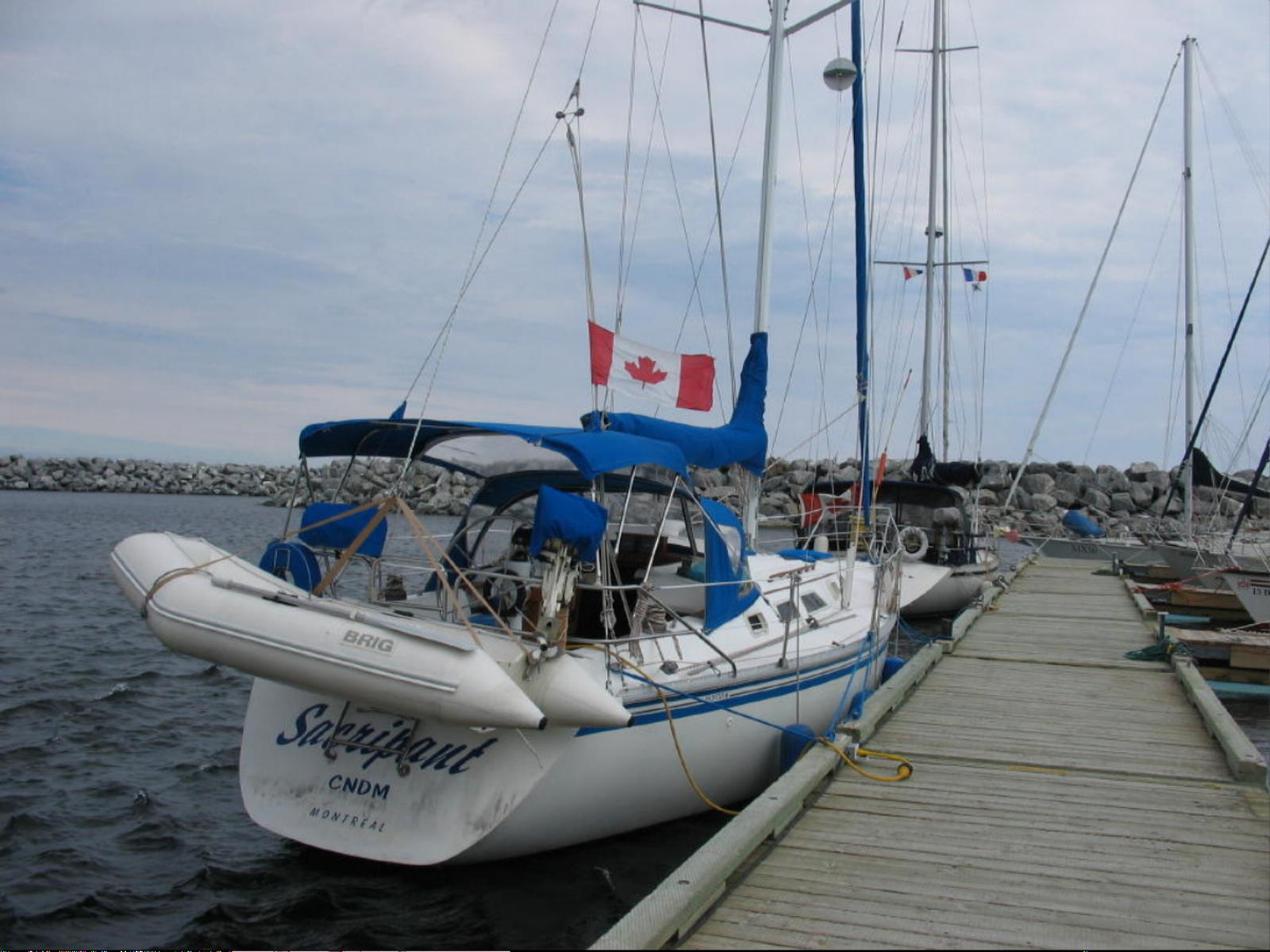

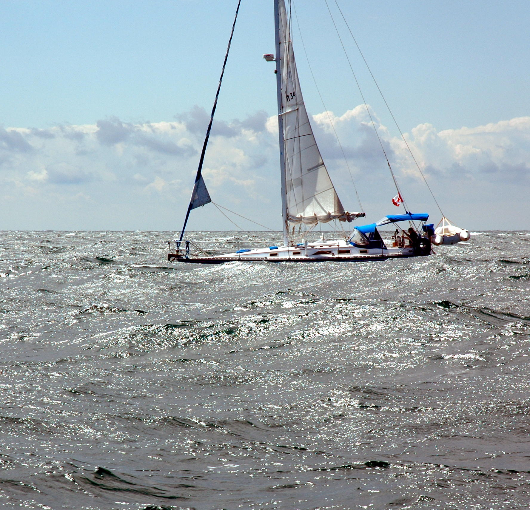

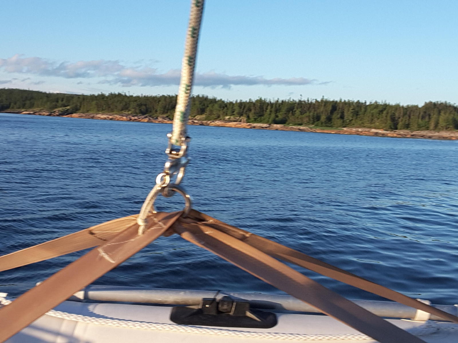

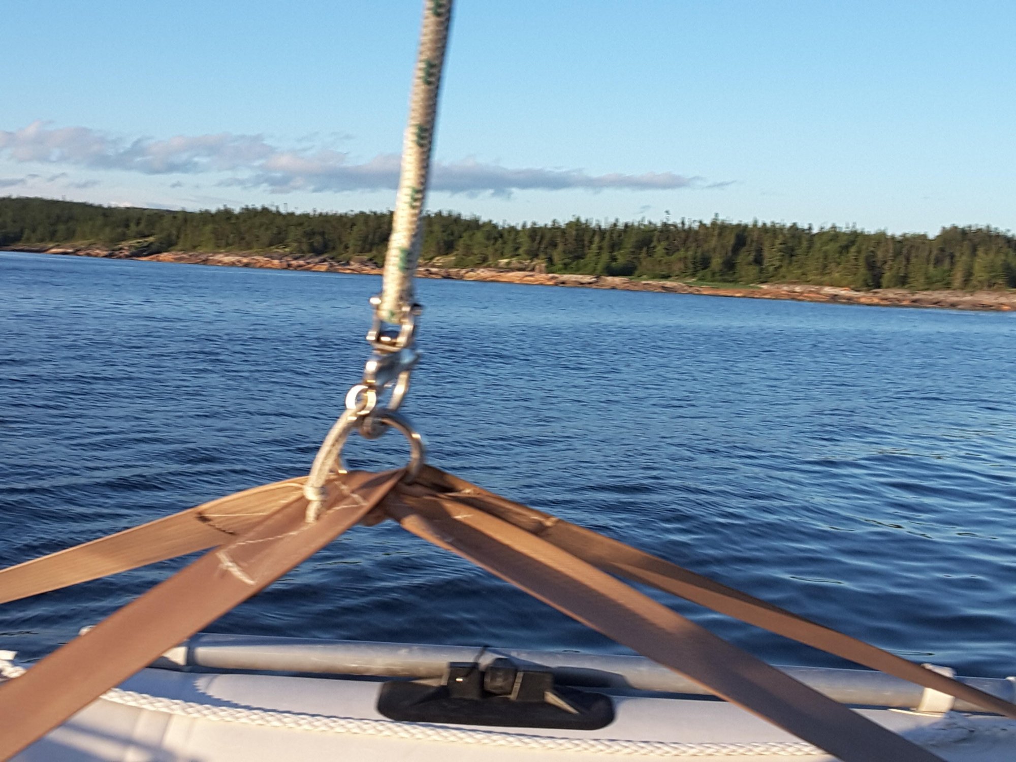

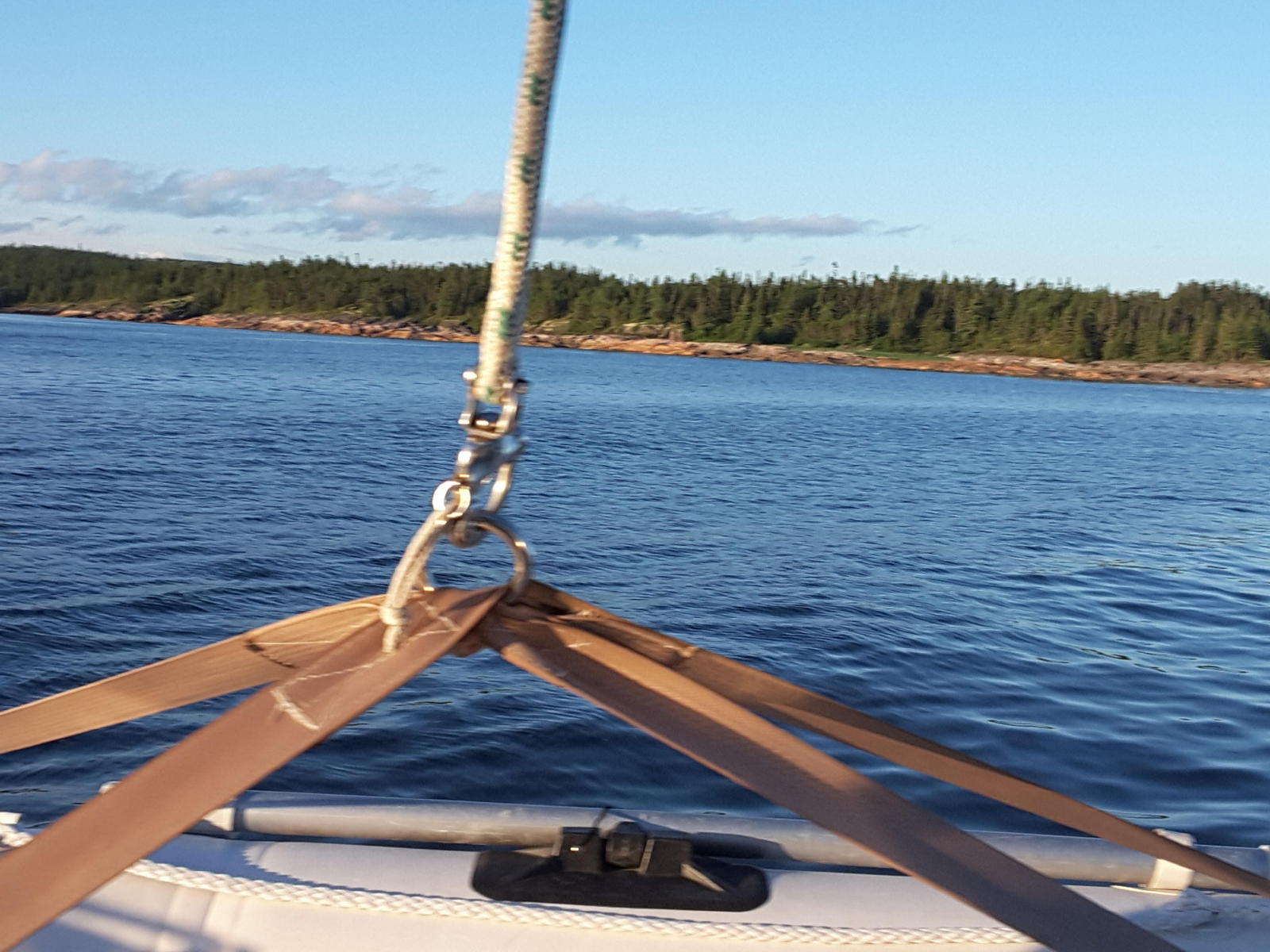

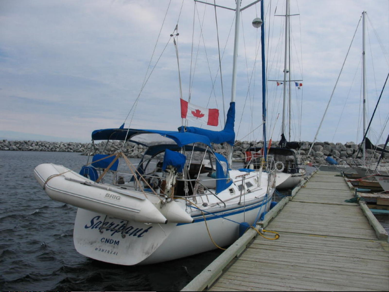

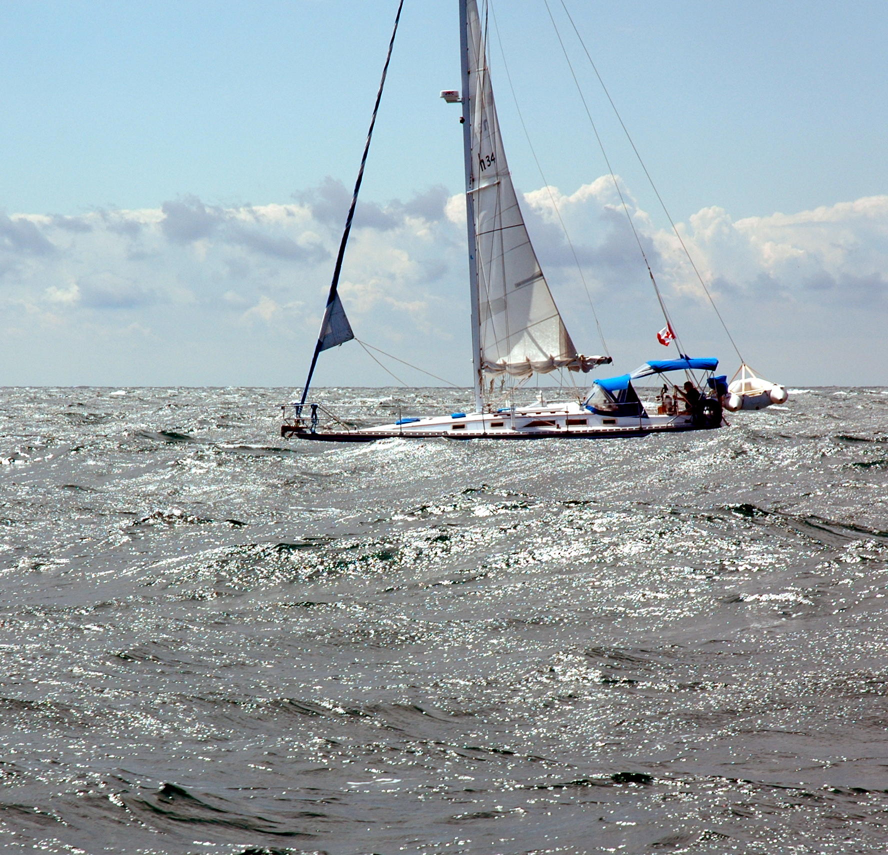

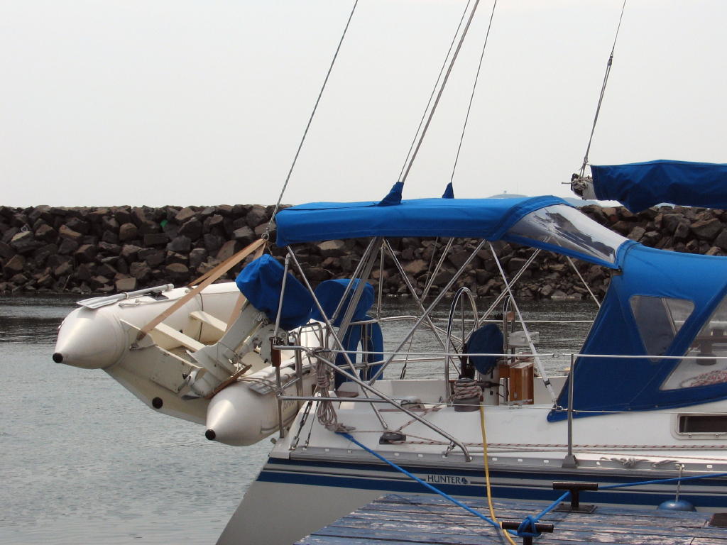

FYI, I have been doing it for 15+ years. I ran a 7/16 halyard in the mast using the spare sheave next to the main halyard sheave, (both on top and on the bottom of the mast). I made a sling with safety belt material and attached 4 hooks to the 4 arms of the sling. 2 hooks are attached to the dinghy transom (I installed eyelets) and 2 hooks are attached to the D-rings each side of the dinghy bow. For better support I also have a piece of sling going from side to side under the bow so it is not supported just by the D-rings.
I have brought the halyard to the cockpit and use the winch on top of the cabin to hoist the dinghy. Once where I want it, at the same height as the top of the stern railing, I secure the dinghy bow and stern to the railing to prevent port to starboard movement and to prevent lifting. It has been safe under all conditions and I have not had a problem ! And... I'm now smart enough to leave the dinghy drain plug undone when hoisted so that it does not get filled-up with rain water.
As mentioned 15 years since installed, but 20,000 miles in those 15 years, with 2 trips to Labrador, Magdalen Islands, and the Bahamas under all kinds of conditions. Not one problem ! I never have done it, but feel I could probably leave the OB on it as I have tested it by getting into it while at the dock. So far, the only real drawback is the same as davits. I have to lower it out of the way if I want to use the swim ladder. I can swing it to the side of the boat, but it gets tricky because of the bimini.
Take a look at the attached pics. I also have a few videos (filmed on the lower St.Lawrence river, under 42 knots, no main just about 40 sq. feet of jib), but can't seem to upload them.
It has proven safe under every sea conditions that I have met but I will not go so far as recommend it. I am just saying I have never had any problems doing it. Your boat your decision !

Unfortunately the photos are far too small, at least on my computer, to see how you have rigged the halyard and dinghy. :(
14,093
Hi Dave, hoping this gives you a better idea.
Thank you. So long as the halyard is strong enough and the lead from the mast head is fair, then it can easily support the weight of a dry dinghy.
The OP wasn't clear if it was a second main halyard or a spare jib or spin halyard or a topping lift, thus the cautionary words.

I am very interested in your setup for the dinghy. This looks like it could be a great option to explore. Do you have any issues with wear on the inflatable? Also, how big is the outboard that you have mounted on the stern rail?

Halyard is 7/16 so strong enough ! And I'm now smart enough to leave the plug in the stern open so that very little rain water collects in it. As for the OP, you're right that it wasn't clear. I totally agree that it shouldn't be done with spare jib or spinnaker halyards brought back towards the stern. Chafing would be a real concern to me.

Hi Rick. No noticeable wear on the dinghy. It is supported by a sling under the bow going from port D-ring to starboard D-ring. Bow and stern are also attached to the stern railing to prevent movement left and right and to prevent lifting. The outboard is an old Johnson 2-stroke 7.5HP. Had it since 1981 when the kids were young and it knew of only 2 speeds, i.e. flat out or dead stopped LOL. Still going good. Amazing that it lasted that long. Now looking for a 3rd dinghy to use it on. The first 2 lasted 20 years each.
