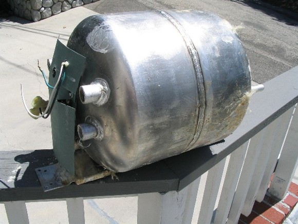

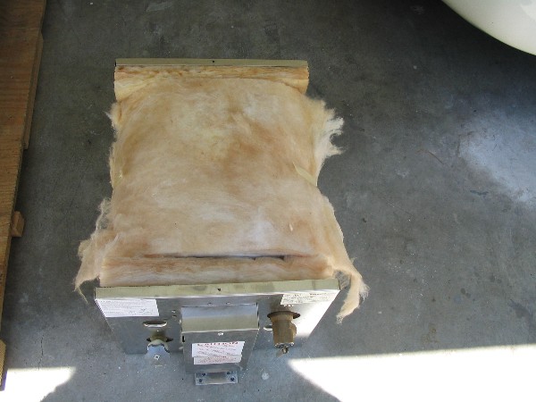

I think all are an aluminum interior tank and that the exterior is the only difference in materials. I have replaced three in 30 years on two boats FWIW. All were internal leakages. I assume you believe it is the HW heater since there is water under it? In other words, it isn't the pressure sensor on the water pump, right? If you know it is the HW heater, I'd first contact Seaward to ask for a warranty extension given the short time out of the termination. Good luck!

Rick, It’s the tank. I’ve had my other Seaward apart like you show in your pictures. Just to see where they leaked from. This time the water is in the back right corner and seeping out. It’s definitely water, as it was hot and not colored with antifreeze (in my case yellow). And it wasn’t winterizing antifreeze (pink). I thought it might be some had gotten in the casing and found its way out after all this time (spring commissioning). But no such luck.
