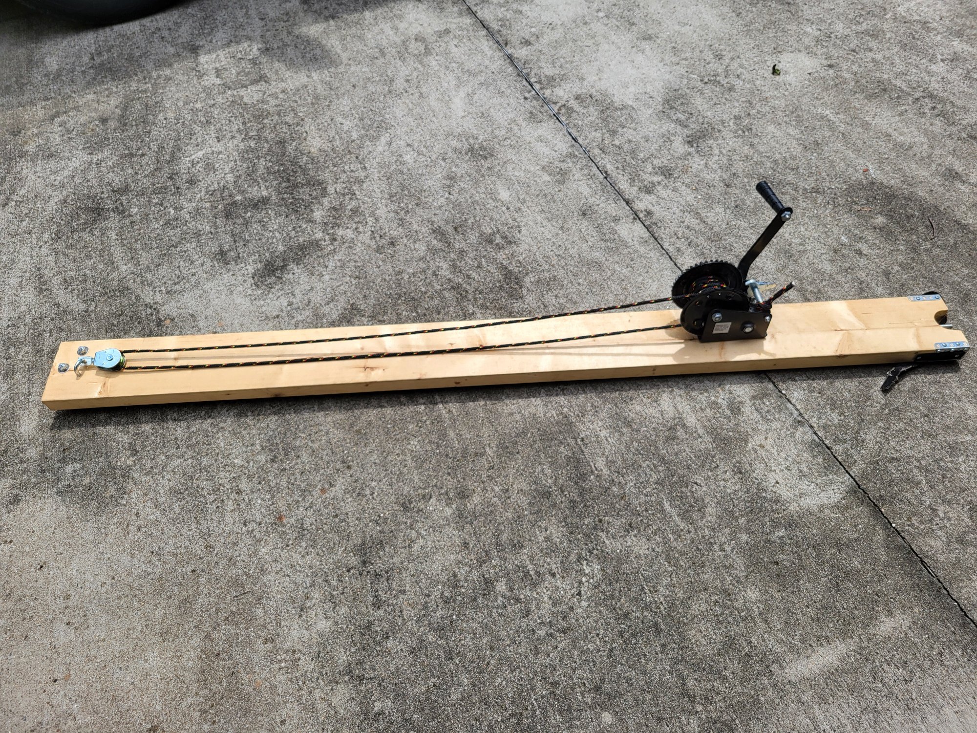

I was blessed with a hole in the front of my mast when I bought the boat. So I decided to put a pin in my gin pole in the saddle. Measured the size of the hole, got some threaded rod, and an insert, and used those to secure the rod into the gin pole saddle (along with some epoxy to make sure nothing lets go at a critical moment). I use a heavy duty velcro strap around the mast to retain the gin pole in place. See the right end of the gin pole.
I originally used a 2x4 but the jaw around the mast broke during a raising causing everything to crash down. Learned my lesson, went to a 2x6 as shown. Used metal angles to reinforce the wood near the jaws. The photo shows the bottom of the gin pole. The winch line goes to a block mounted on the stem fitting where the jib tack normally goes. Line is then led to the bow cleat. I set up the gin pole at a 90 degree angle to the mast with the threaded rod in the mast hole. Crank away until the mast is vertical, and forestay can reach the stem fitting. Having the winch line run through the block at the stem fitting is critical to getting the gin pole to bring the mast all the way up.

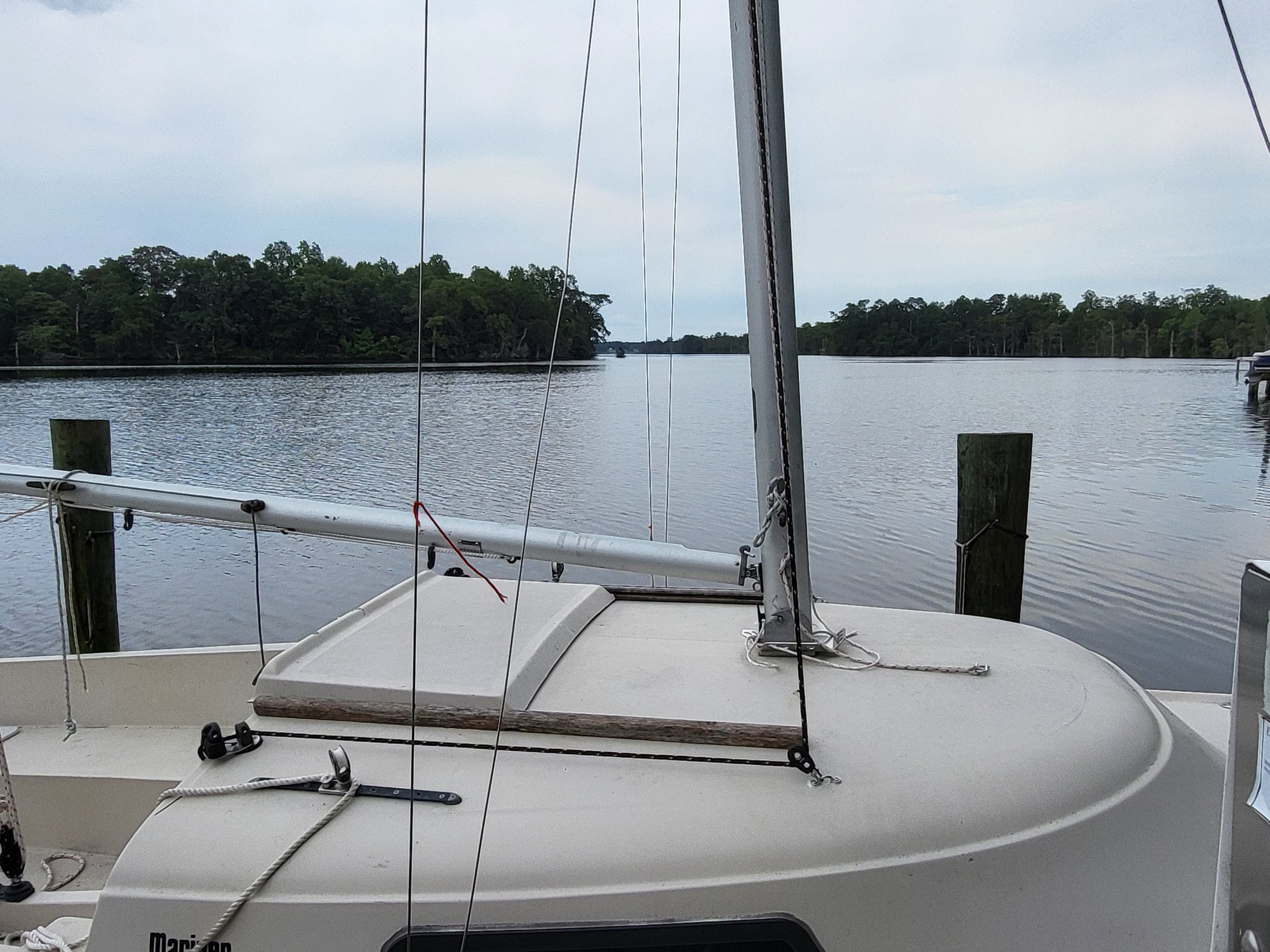

This photo shows the baby stays in place after raising the mast. As you can see the deck block is slightly forward of the mast tabernacle to compensate for being lower than the tabernacle. This puts the baby stay in line with the mast at about the 45 degree angle while raising, or peak load on the baby stays. As you can see, my shrouds sweep aft, so they hold the mast in place during the last part of raising, and it's then OK for the baby stays to lose a little of their tension. When I mount the gin pole and baby stays, I pull the baby stays as tight as I can get them. I use nylon so they do stretch a little under load, which is what I want. System has worked well since I refined it for the 2024 Mariner Rendezvous in Connecticut. Baby stays are tied to eyes mounted on the mast about 6ft up (so I can remove them after raising the mast).
One last gotcha - see the cleat sitting on the aft side of the mast almost at deck level? That cleat needs to be moved up in the slot before lowering the mast. Otherwise the cleat catches on the aft side of the mast plate before the mast lowers all the way. Everything gets jammed up, and the only way to fix is to raise the mast back up. Don't ask how I know (notice the cracks in the aft ridge of the cabin hatch?).
