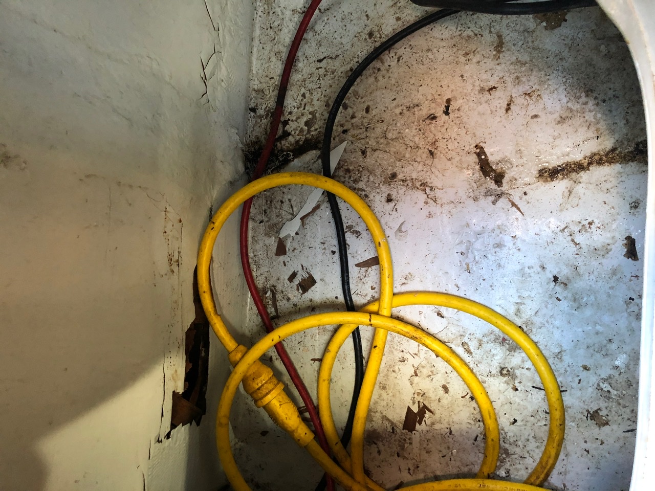

I am considering purchasing a 1993 Seaward 25, and ran across the following issue in the area under the companionway steps. The owner says it was like this when he bought it a year ago. Any idea what may have caused it and how big an issue it is?

Is that a wooden bulkhead with peeling paint? I take it, the junk is just bilge detritus and can be vacuumed out.
The peeling paint over wet wood means rot, to me. It doesn't mean all is lost, but attention needs to be paid to proper repairs.
Clean it off, cut out the rot, kill the fungus with bleach, dry thoroughly with heat and fan, fill with glass and epoxy and paint with epoxy-based barrier paint.
If it's extensive, replace the bulkhead.
Time consuming, but not difficult, if there aren't other issues to consider.

Thank you, Will. It's the area where an inboard engine would go (this boat has an outboard). The white that is peeling is actually fiberglass. A previous owner had tried to repair this with a bad job of re-fiberglassing. I believe that the issue is that the traveller, which is above this area, is leaking and needs to be reseated. No problem, I can do that - I'm just trying to make sure that the issue isn't structural. I don't think it is, but just getting other opinions.

With regards to the image. It is not an unusual image for a boat that has seen 26 plus years of service and perhaps a couple of owners. You can have it surveyed, but that would be an extra cost and dependent on the the price of the boat. It does look like there has been a moisture issue. I would be looking at the hull to try and locate the source of the moisture. This could be a complex project. If you do make an offer give it some room to repair the job that the owner did not fix. "A previous owner had tried to repair this with a bad job of re-fiberglassing. I believe that the issue is that the traveller, which is above this area, is leaking and needs to be reseated. " The bad job is likely due to a lack of experience and moisture in the wood.
