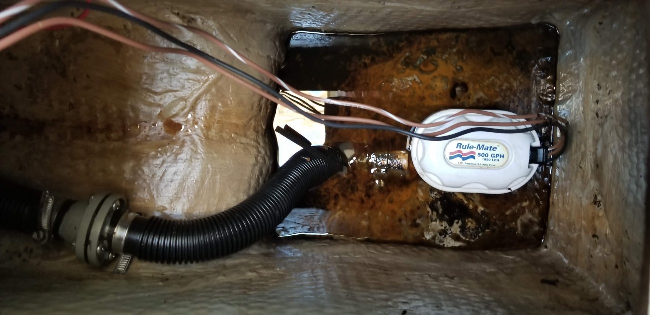

I made an offer on the Seaward, contingent on the owner getting the centerboard down, since he kept implying that it was probably only barnacles. He accepted my price, but said he would only sell the boat as is, so we parted ways.
I contacted the owner of the Watkins and we talked for a long time. We talked about his maitenance schedule and I am confident the engine has been maintained. The sails are brand new and the running and standing rigging are both in great shape. The deck is solid. Gel coat is in good shape. There are water marks inside the boat by the port and starboard chain plates, but it looks old, and when I inspected the deck around the chain plates, it was already sealed up. The mast and all deck hardware were in great shape and solidly mounted.
The engine and engine compartment were mostly clean. It showed its age. The motor mounts and bolts were good. The engine ran good at idle the other day and I know it was a cold start. My only concern is the oily bilge.
We negotiated a price, which was much less than the offer on the Seaward. The offer is contingent on an inspection and demo sail. I can also sublet his boat slip for a reasonable fee until I find a trailer.
I'd appreciate advice on my inspection. My weak knowledge is the diesel inboard since I've never had one.

It is pretty easy to get oil in the bilge through very benign actions. And very difficult to get rid of it all!
On many diesels, it is virtually impossible to change the oil filter without dumping some oil, same for the fuel filters. Depending on where the oil filter is located, it is nearly impossible to adequately clean any spill and that oil eventually wanders all over the bilge.
The oily bilge may also be diesel. Again there are benign ways of getting diesel in the bilge. The 2 that come to mind are overflow from bleeding the diesel lines and a broken fuel line. A couple of years ago a fuel line broke on my diesel and dumped 5+ gallons of fuel in the bilge. I'm still trying get it all cleaned up.
Depending on the purchase price, you may want to hire a surveyor to inspect it. A decent survey will probably cost between $500 and $1K. At some price point that amount just doesn't make sense. Certainly not on one of TomY's dollar boats.

Since you said it smelled like diesel, I'd look for a diesel leak first. A common place for leaks would be the banjo fittings on the fuel lines. It's a shaky little engine and mine have shaked themselves loose before. If it's an oil leak, one common problem, especially on a salt water boat, is the water pump developing a slight leak. The saltwater drips on the oil lines directly below, causing them to corrode and eventually leak. The water pump can usually be rebuilt, and the oil lines replaced but they aren't cheap. The single cylinder yanmar is a pretty dependable little engine.

Do a very thorough check of the diesel tank for leaks. That includes the fill hose and the injector return line. Could be were the smell is coming from.
