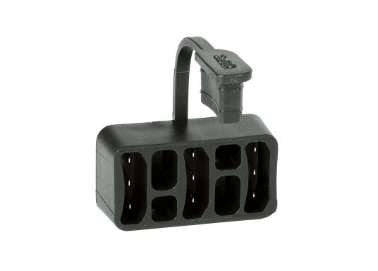

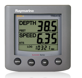

I am trying to wire up my Raymarine ST4000 (original black one, not the gray ST4000+), a Raymarine ST60+ TriData, and the Raymarine wireless SmartController. I have read that the ST4000 uses a pre-SeaTalk1 protocol but is still compatible with SeaTalk1, although you have to buy a SeaTalk1 cable, cut off the connector and crimp tab connectors on to use it. The SmartConnector has a wireless base station with a single SeaTalk1 cable and the Remote has a single SeaTalk1 cable to charge the internal battery. I bought a Raymarine Three-way splitter (D244), and plan to splice the ST4000 to the SmartController base station in parallel, then connect that cable, the smart connector charge cable, and the ST60 output cable to the D244 three-way splitter.
Am I crazy? Will this work?

Except the ST4000 (photo added) which only has one terminal, leading to the purpose of this post.

The Seatalk 1 buss is parallel. The Dailey chain cables are just a convience to interconnect the instrument heads. The D244 adapter is really to easily connect the flat 3-pin connectors. I have one myself for my wireless remote.
