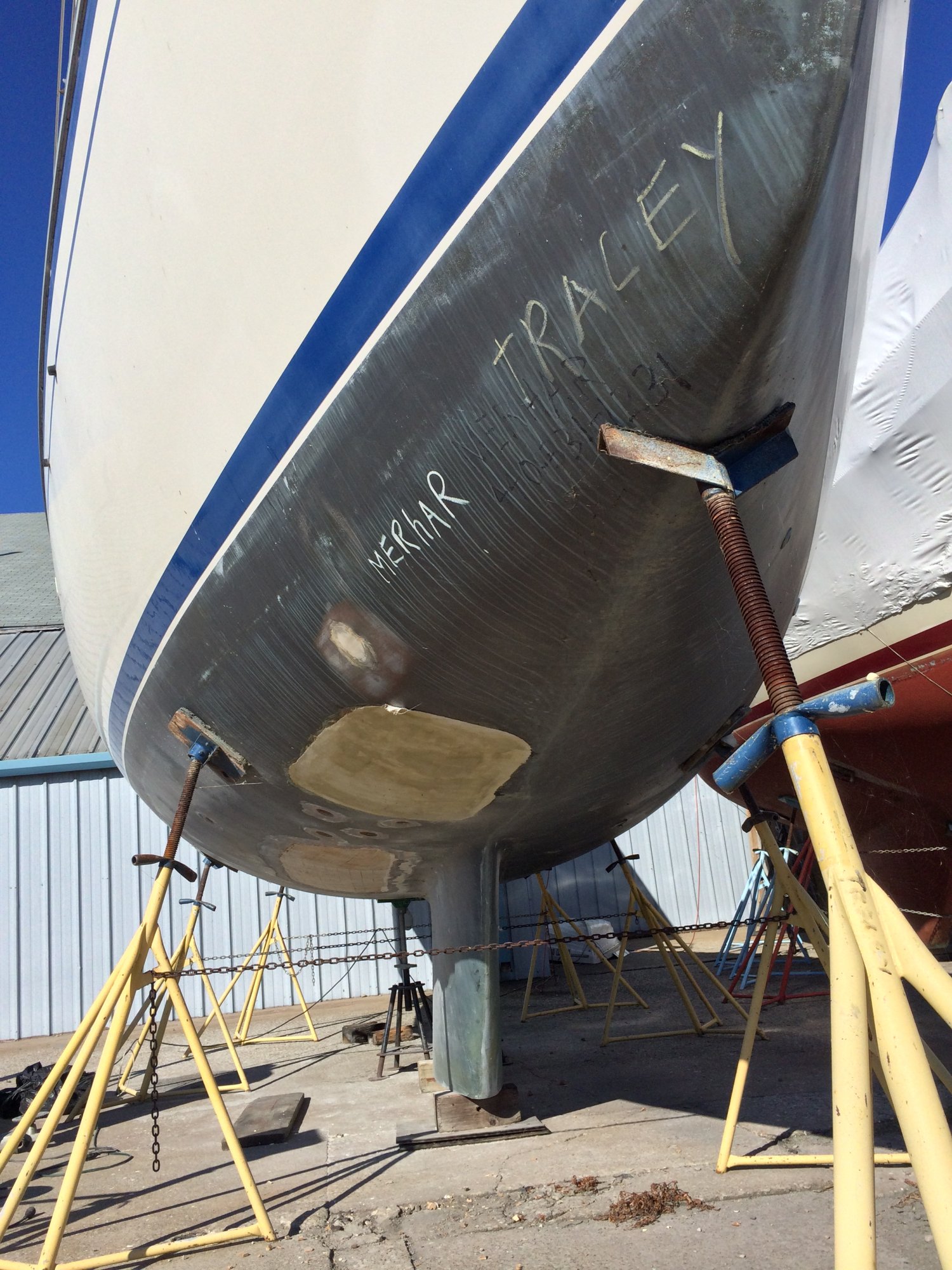

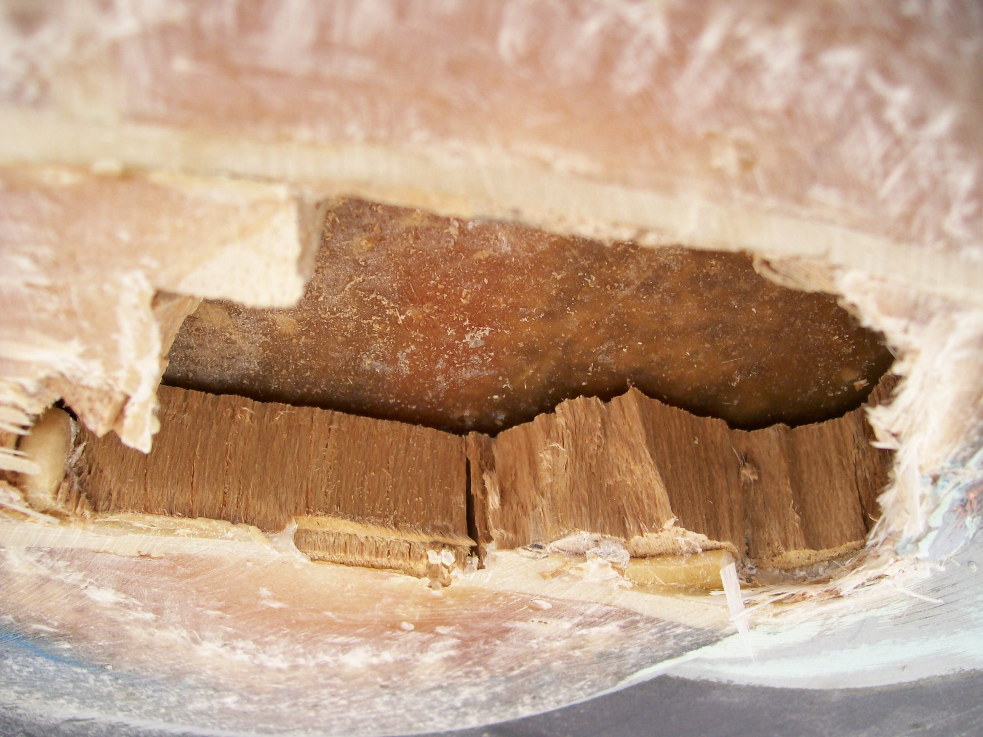

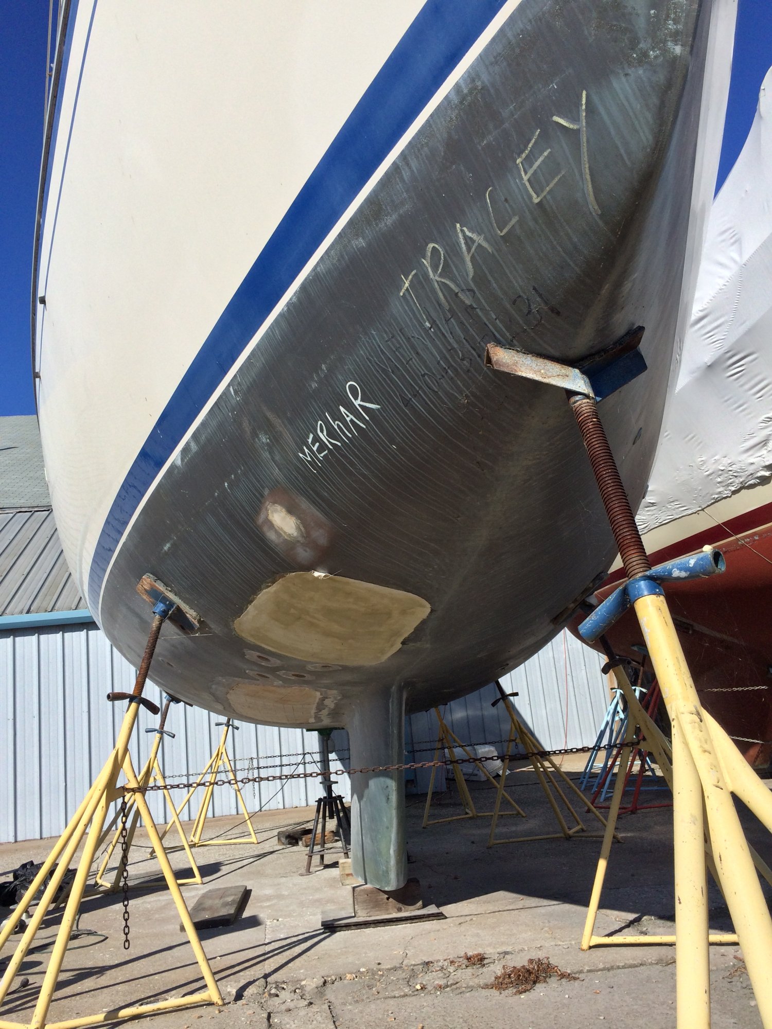

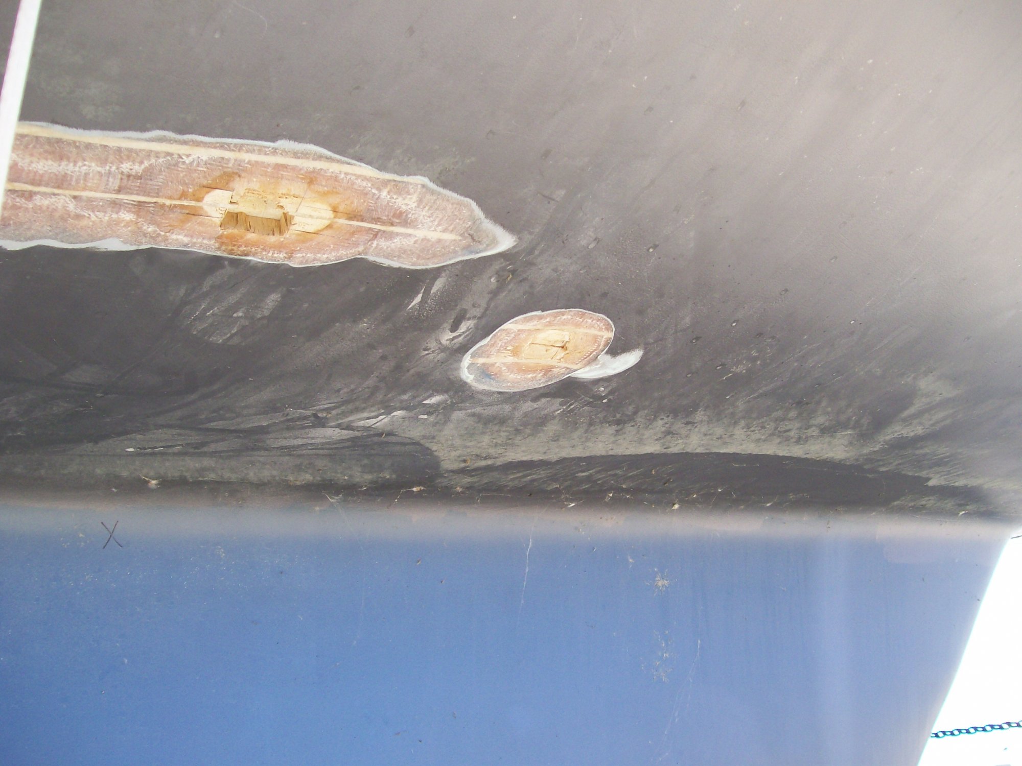

It was a beautiful boat, first owner was an older gentleman that did not use it much but kept very good care of it, second owner was a customer of mine at the Bridge Docks in Rocky River, OH, renamed Rocky River Marina. He told me about his boat being totaled so I went out to look at it and put a bid in and ended up owning it, never put title in my name because I was fixing hull. Lots of family medical issues happened and when that was all over was when I found out the new management of the marina had sold the boat at auction. I didn't even know it happened, they were tight lipped. I reported it to the State of Ohio Attorney, thats when I found out the facts. Why I was fixing the hull? Well, a year earlier the boat was at Edgewater Marina and had a dock pole wear a hole thru the outer skin during a storm and water infiltrated the starboard side. It ended up being an insurance job gone bad so it was totaled. I will attach my work doing repair. Big area delaminated so removed big area and used epoxy and new 3/4" Balsa.
The dock pole wore a hole in the bottom, below the waterline?
That looks like a major repair. You obviously had a lot invested in her.

I sounded the hull and just repaired where needed. Pole was rubbing higher and water ran in thru balsa core, insurance had marina dry by cutting slits and gave it time to dry, then they relaid glass over. This all happened to Tracey, previous owner. He complained that it was not smooth enough so they blocked it out perfect and put a slippery bottom paint. In the spring when taking out of indoor heated storage he saw water weeping in two spots, thats when the insurance totaled it and wrote him a big check.
