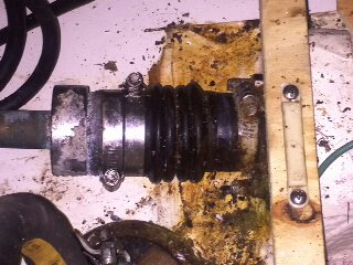

What I believe to be the shaft seal is leaking where it enters or connects to the metal ring to the left of the double hose clamps. Dripping at rest. Touch the shaft and it sounds like it wants to let in the Pacific. Question is whether it can be changed without a haul out, and if so how. Is there anything I can wrap it with to contain the water until I can replace it?

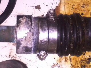

How old is the unit? One manufacturer (PSS) recommends replacing if over (I think) 6 years. since the failure of the seal would be a BIG problem, I would take the route of replacing. I have seen threads on tightening the seal by moving the collar aft, but it's important not to re-use the set screws - get new ones. Check the bellows for cracks or wear. If not pristine, I'd replace. I notice a lot of corrosion on your ring. Clean it, but don't use anything that can deterioate the rubber. Also, many of us that use this system put a hose clamp on the shaft to make sure the ring dosen't move forward on the shaft. You do not seem to have a "burping" tube as part of your installation which means that it is probably an older unit. You might want to upgrade.
10,214
You can cram a bunch of thin plastic bags (grocery shopping bags for instance) into the hull recess where the shaft comes out of the boat on the underside of the hull.. as many as you can get to stay in there.. Dive under and see what ya have. Then you can test the amount of leakage by pulling the bellows aft. it will leak some, but not a whole lot. You should check the amount of face pressure on the seal by having the collar loose then moving it away from the bellows until it there is a gap then push aft until the face first (barely) touches the stationary carbon face held in the bellows. Then mark the shaft and from there, push the collar aft the correct amount as listed in your seal instructions; 1/4" or somewhere around there.. be accurate with that measurement. Tighten the collar set screws. and pull the bags from the outside to check. It should be burped as Scotty says.. again, should be in the seal instructions. If that doesn't do it, it will have to be pulled off the shaft. That is usually done with the boat out of the water. The faces of the seal are very critical and one small scratch across a face can ruin the seal.

By the looks of your old one, I think it's seen better days. The ring on the shaft looks pretty corroded. If the mating surfaces are pitted, it could be resurfaced, but it's polished to a mirror finish and if there are any pits or scratches, it will mean leaks. The new ones have a fitting for a hose that comes off of your salt/fresh water intake. It eliminates bleeding or burping. I've had mine for about 10 years and am going to replace the bellows while I have my engine out.

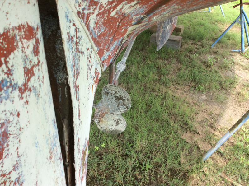

I don't want to "bad news" the operation, but when that shaft comes back enough to clear your job, the rudder may have to come off. Or.....sometimes getting lucky and pull the prop and the shaft slide alongside the rudder. Probably not.

It possibly may be worse than I thought. If your boat is built anything like this one, the skeg has to come off too. Then again, you may be lucky and slide it back I enough to get the parts on. It wouldn't be MY luck..

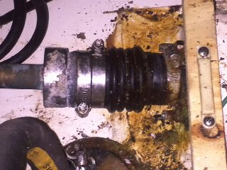

By following Kloudie's instructions on moving the carbon ring aft I was able to bring the leak under control. That along with a 12v pump should allow me to do any motoring I might need to when I go to the boat yard where I can install the new seal.
