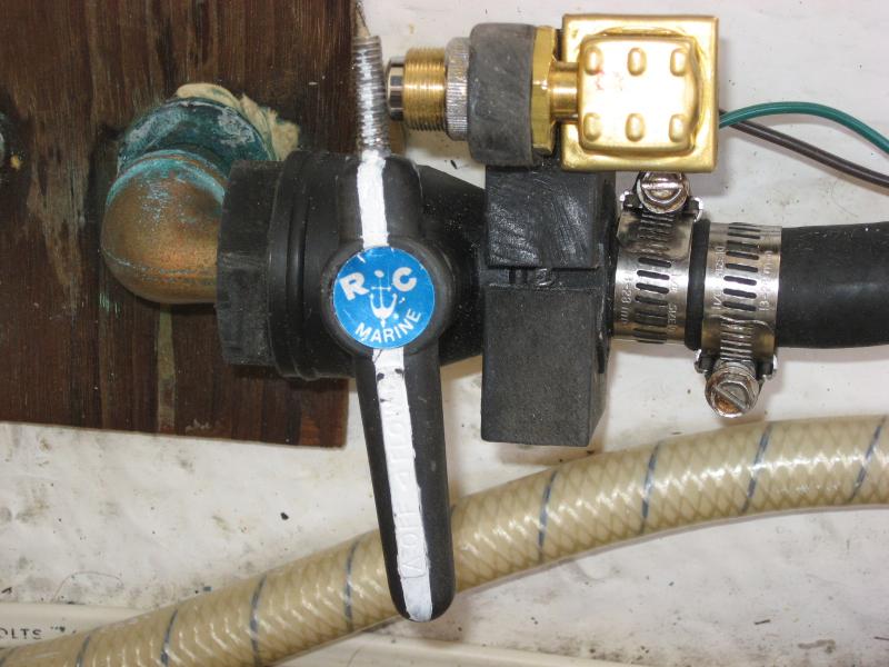

I also did the "forgot-to-open-the-engine-seacock" scenario several years ago. My normal routine was interrupted due to arriving guests on board and being at a different marina. Fortunately I had on-board a spare impeller and there was no damage to the engine.
Vowing to never repeat, I mounted a trigger switch to my engine seacock and wired it to my Yanmar alarm circuit (pictured). Now, if the alarm doesn't stop sounding after the usual several seconds (until the oil pressure rises), I quickly know the seacock is still closed.
I posted this at the time of my incident. I recall that one forum responder opined that if I couldn't remember to open my seacocks, I had no business owning a boat. Useful solution.

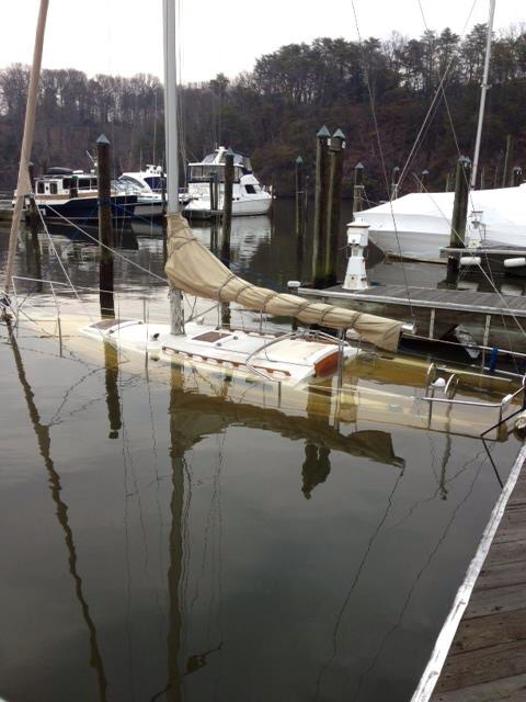

In 2013 my 30 foot Lippencott sank in the slip because I had the flu and was unable to make it to the boat when an unexpected cold snap overtook Virginia. I had recently moved from salt water to fresh water and did not have a healthy respect for how quickly fresh water freezes
$8,000 dollars later, mostly not covered by my insurance, a bruised ego, and 2 years of work and she is finally back in shape.
I now close all my seacocks when not in use. I store my engine keys on the value to remind me to turn it on. I do this year round just to make it habit
Closing your seacock valves is an easy thing to get in the habit of doing, and has expensive consequences if things go bad.
