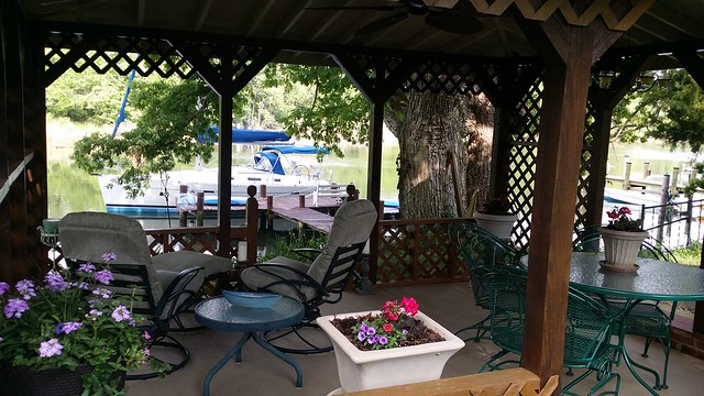

I keep my boat at the pier in my backyard and often relax in the gazebo where i can gaze upon it when not in use. I was not closing the thru-hull for the head but after reading this I certainly will begin doing so! Nice thread and thanks to all who participate.
