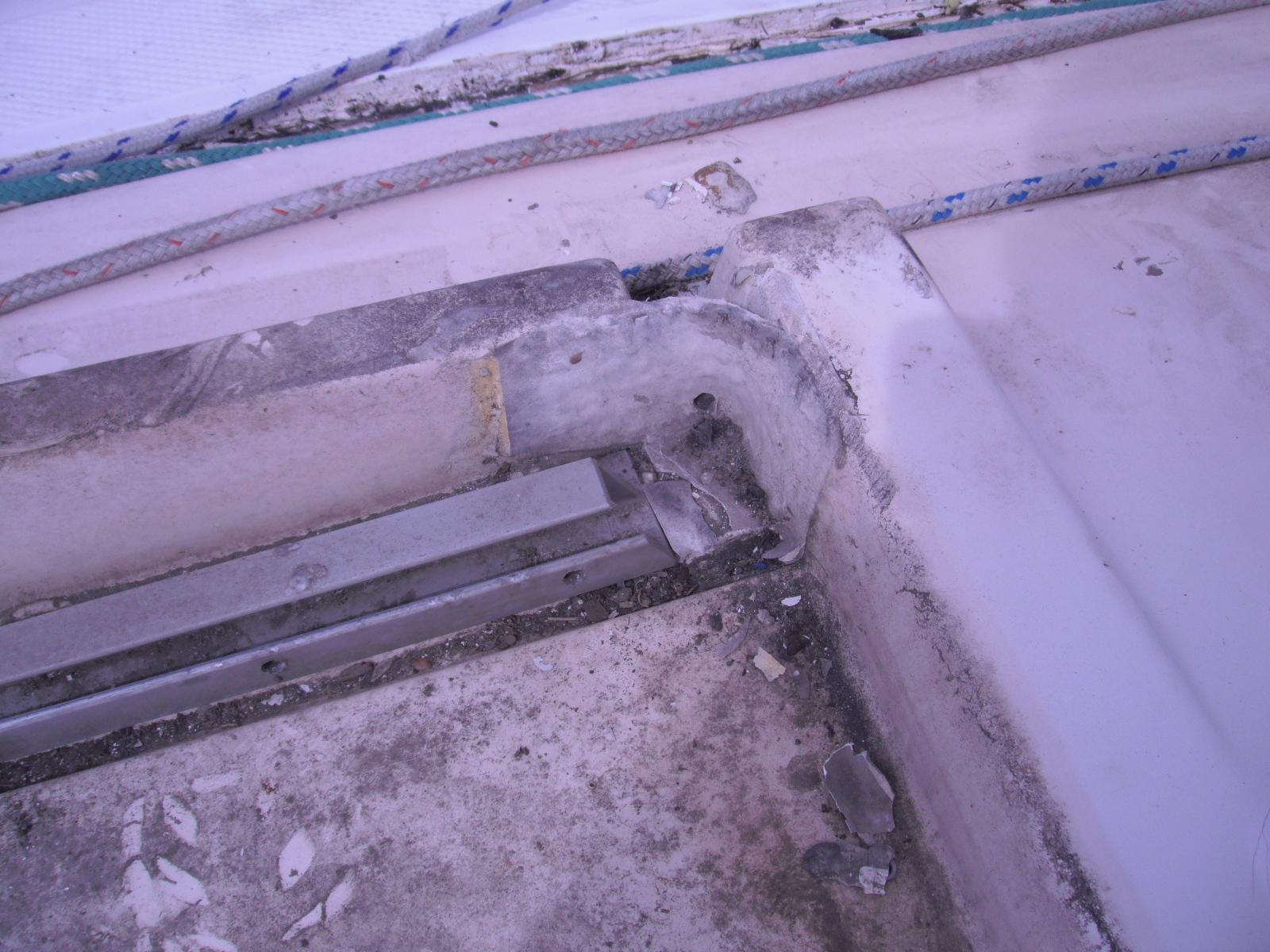

Dave, my '85 model did not have 5200 for the seahood seal. it came up with slow and careful levering around the edges on a hot day. The sealant was stringy kind of like a butyl that had been put on thickly. I think that same stuff was used to secure some of the cabin wiring to the cabin grid/liner in spots. I don't know if they used 5200 at different times on that seal, but I am glad that mine was not .. Be prepared to open the drain channel at the front of the slider pocket once you have the cover off. The drain on my boat was completely blocked by some tabbing that should have been removed at the factory, but was overlooked. I tried drilling a hole in the tabbing but it plugged quickly with debris. I opened it completely the next time I was in there. picture shows the drain channel with tabbing and my small drilled hole.
