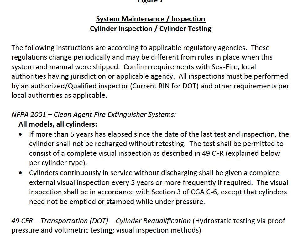

We have a 2006 Hunter 45 CC with a SEA - FIRE Extinguisher in the Engine Room. Can anyone who has a similar system tell me how often this system needs maintenance, and or re-charging. Needless to say we have not has to use it since taking delivery of the boat.

Here is a manual from their web site Sea-Fire Support

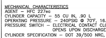

From the research I did in January, it will cost a fair buck to get the system cylinder upto date, you will end up having to purchase one of these FG 100A about $450.

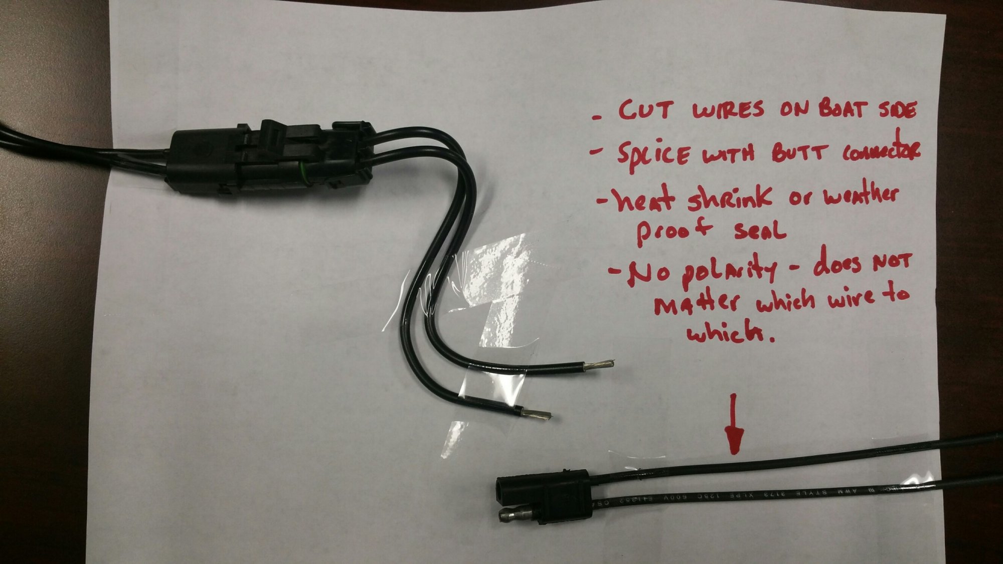

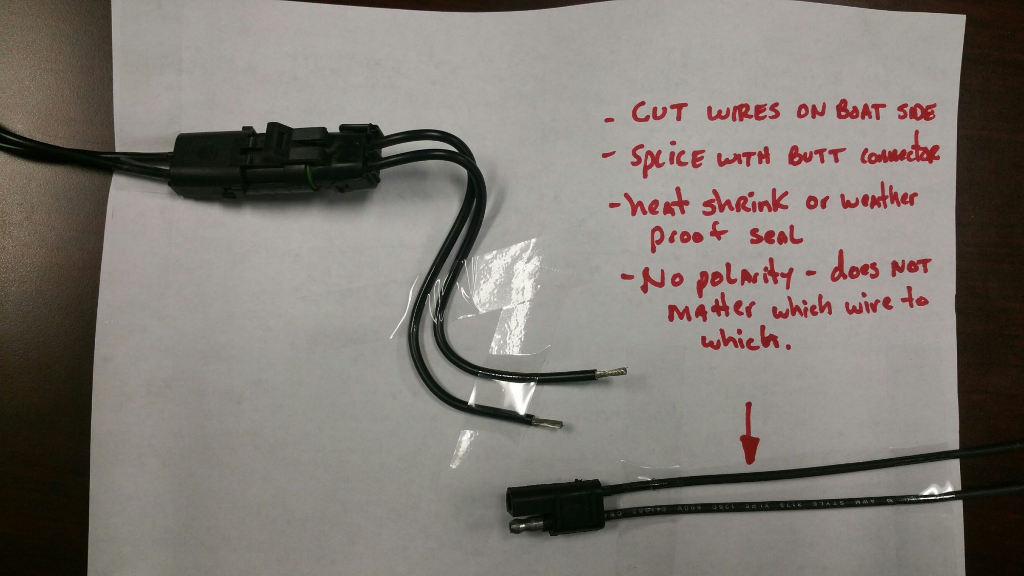

When I purchased my new to me 2005 Hunter 46 last January I replaced the 14 year old Sea Fire FGA 123-295 50cf fire suppression bottle in the engine room as a safety precaution. According to Sea Fire, the FG model cylinders aren’t refillable regardless of size, require replacement in kind. The cost was $300 plus sales tax and $75 ground Hazmat (it’s considered a compressed gas cylinder even though mostly liquid agent) shipping from the east coast to San Francisco, CA. If you replace it the new one will come with a 14 gauge electrical pigtail to connect to the boat's shutdown circuit. The existing 16 gauge connector on the boat side will need to be cut off. The two ends need to be spliced together, typically with a butt connector. The connection needs to be weather proofed with heat shrink (installed in advance, and then melted in place). There is no polarity with the wires. It does not matter which wire goes to which wire according to Sea Fire.

Replaced with HFC 227ea (heptafluoropropane) agent. Halogn manufacture is banned by the US EPA. The fire suppression bottle supplier, where I purchased the new bottle, disposed the old one. When making the electrical connection refer to the "FG Connector" jpg file attached. Those instructions came from Sea Fire.
