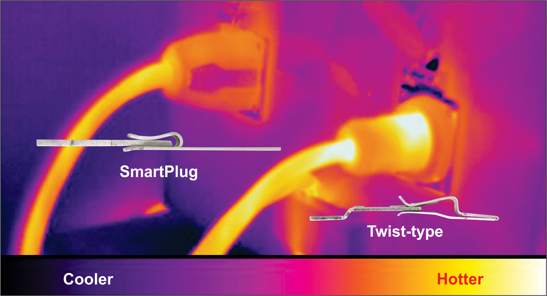

And this image shows why.
The SmartPlug also has a thermal disconnect. If the plug gets too hot, it disconnects the power supply. Earlier version had auto resetting thermal breakers, newer models don't.

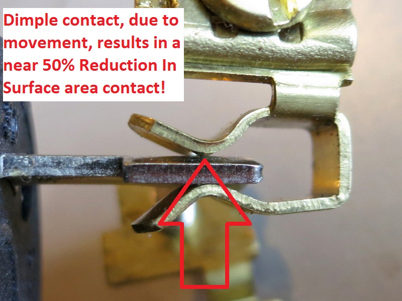

The real problem occurs when folks don't insert the twist lock properly or fail to thread on the locking ring, if they have one at all.
I have seen more than a few basically brand new cord sets & inlets burned up despite zero corrosion, zero arcing and zero time in use because an owner over-loaded the cord set and failed to plug it in correctly.
All it takes is a mm or so of movement for the locking dimple to ride out of its hole and onto the blade surface. Once this happens you have virtually no surface area to transfer the needed current and the socket begins to heat up until it starts melting. If not caught soon enough the boat can burn or the marina.. The twist lock standard we use today would never pass current testing standards (it has been tested to the same protocols being required of the SmartPlug and fails, but it is "grandfathered"...
If the plug does not lock properly or gets tugged on..
