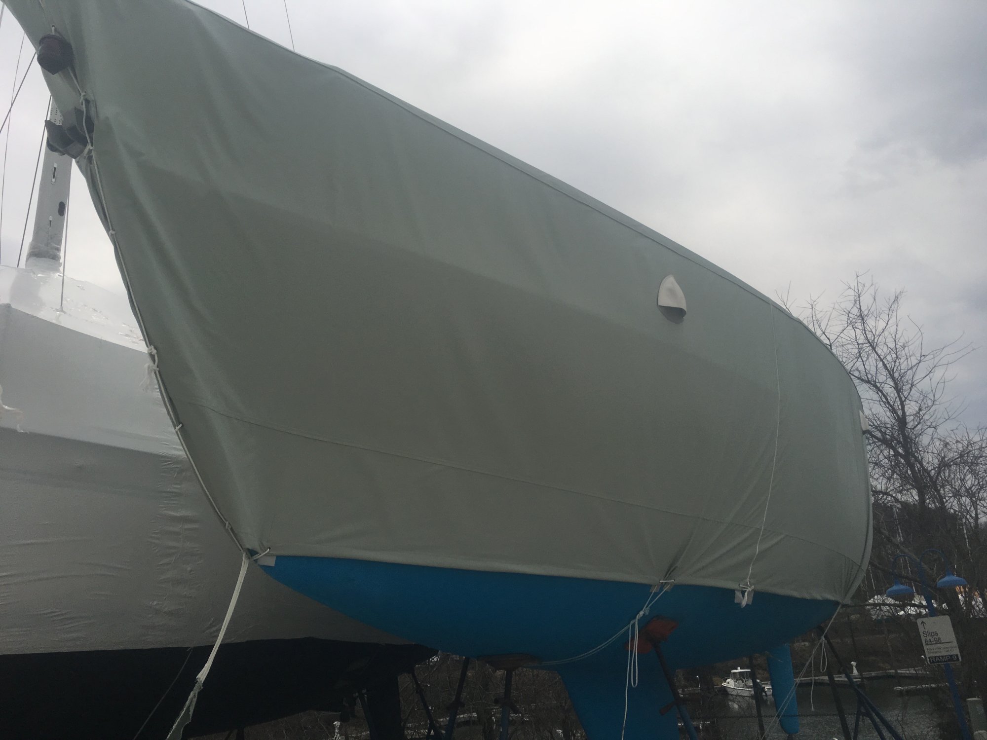

I had a custom cover for the first 10-11 years I owned my 323. It was a single piece using the boom as a ridge, and a 2 x 4 extended from the mast to the anchor roller forward. It was fitted around the stanchion bases and reinforced over the winch locations and any other hard points. The only zipper was from the mast to the deck on one side.
I normally put the rolled up cover on the boat before haulout to avoid having carry it aboard when the boat was on its cradle.
I ended up shrink wrapping after the cover wore out only because I could not get another cover locally made in a timely manner. The shrink wrap, long term, is not an economical or ecological way to go for sure. The upside was that the wrap did the job, and because it was smooth, the snow slid off rather than sticking to the cover (we get a lot of snow, wind, and freeze/thaw conditions in northern Michigan).

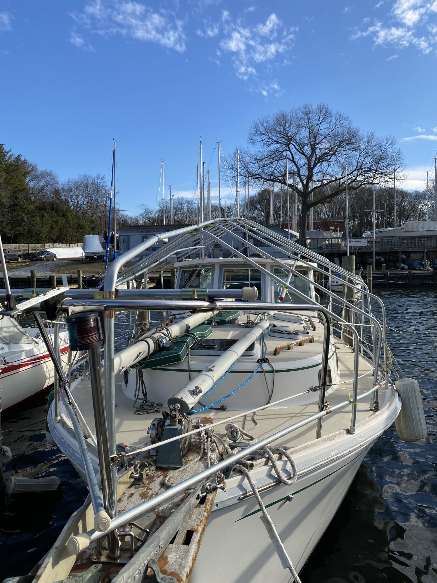

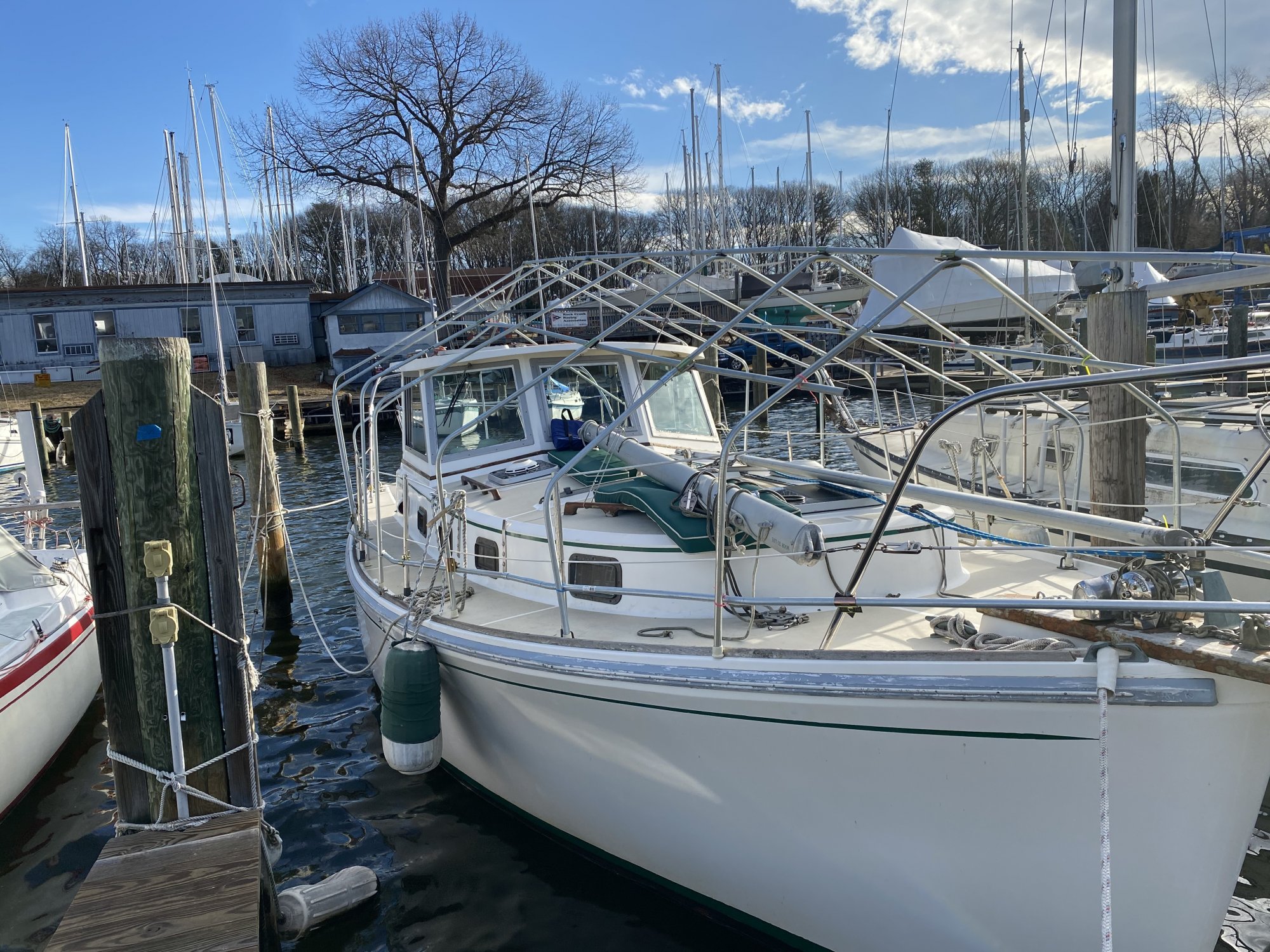

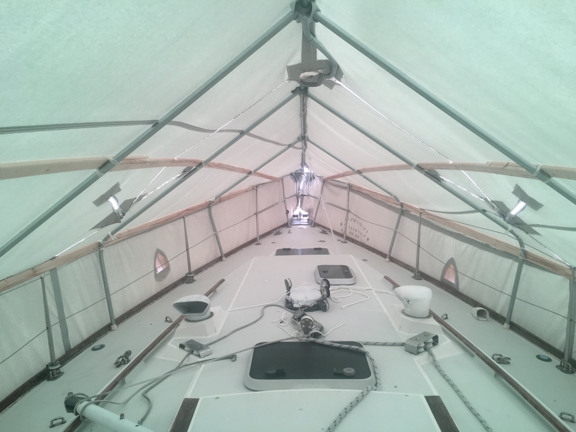

Last year I made a framed cover out of electrical conduit and Kover Klamps ( google it). Having the boat covered made it easy to work on deck projects and keep the boat ventilated. In (Maryland) our winters tend to be wetter with everything from ice and freezing rain to snow. The cost of the cover and frame was about $800. It took a couple of weekends to build the frame but now that everything is bent and marked I hope to be able to put it together in a weekend. Here’s a couple pictures of the frame. Last year I had the mast down and kept the boat in the water. I’m planning on leaving the mast up this year so will have to make some alterations.
That seems really cheap. What did you use for the cover and how well has it held up?
Also, how do you hold the cover down while in the water? I tie mine to the cradle, seems like that would work very well in the water :huh:
I used the tarp that is sold by Kover klamp. You can have them built to any size you need. The tarp held up very well last winter and I intend to use it again. Kover klamps claims that some owners have gotten ten years out of their covers. As far as tie downs there is a perimeter frame that is made from conduit and secured to stanchions. Since I left the boat in the water I also ran several ties under the hull but most of the load is taken up by the perimeter frame. Look up Kover klamps they have a pretty extensive tutorial on building the frame and installing the cover.

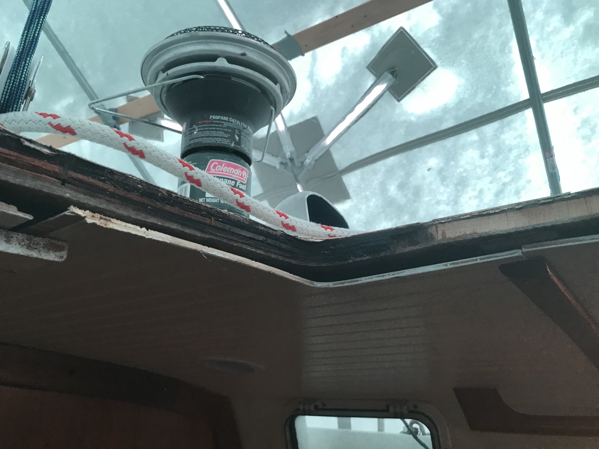

My mast stays up, but I can run a 110 ext cord to the boat, run a light or 2 , a space heater and work on some winter projects. If it is really cold, I may fire up my flowerpot heater ( leave the hatch open).
Boat is in a new spot this year…closer to an outlet, so that is good.
