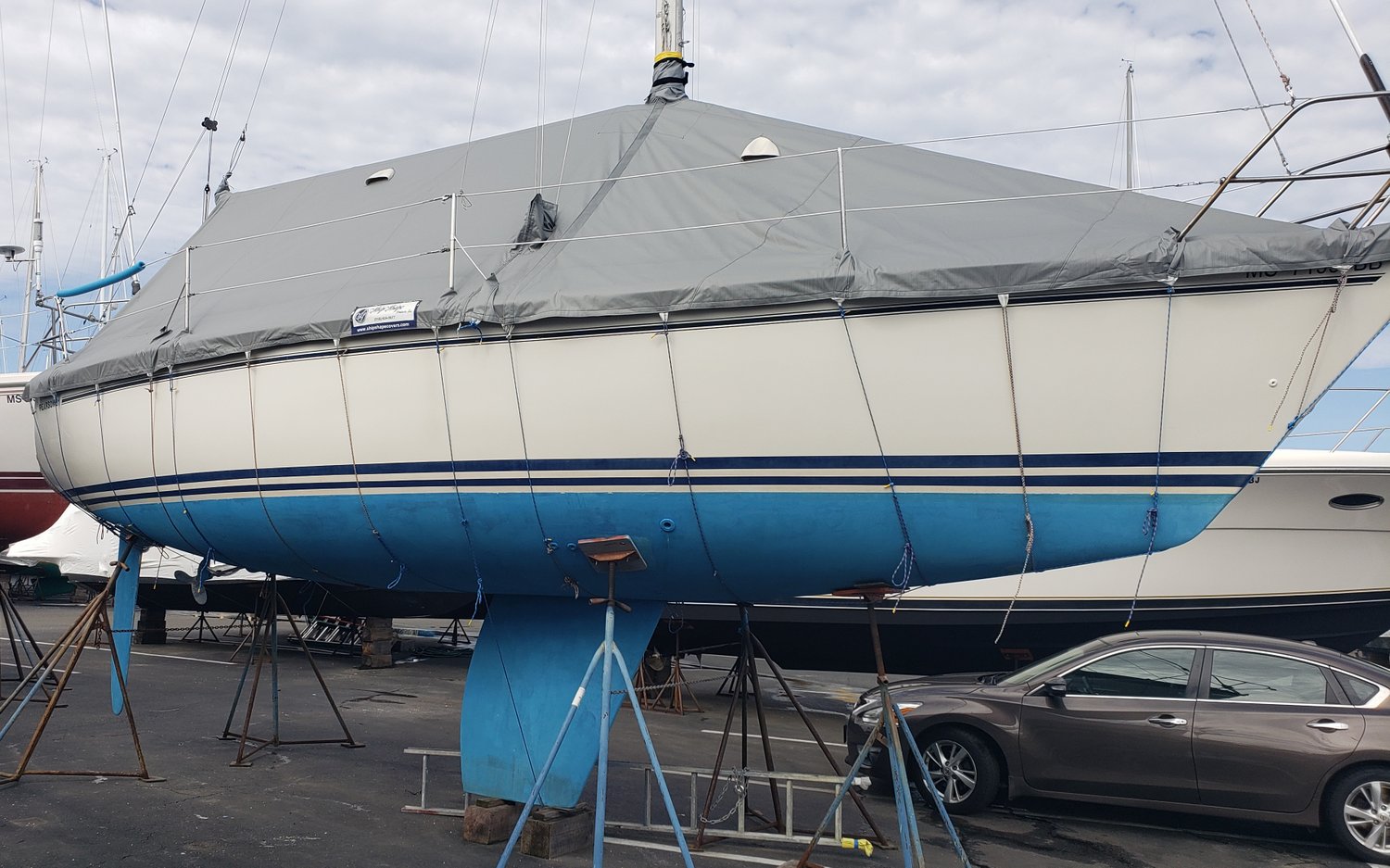

Jul 19, 2013
390
Pearson 31-2 Boston
I think not covering at least the cockpit of boats which experience snowfall and freeze-thaw temperatures is asking for trouble.
If a hose gets iced-up, you can end up with a hose with a split in it from ice expansion. Mostly likely the owner wont be aware of such damage until after the boat has sunk following its spring launch. (Every season I ask the yard manager to notify me when the boat goes in, and every season I find out only because I drive over anyways just to check.)
Alternatively wind-blown debris like leaves can block the cockpit scuppers, resulting in rain and snow filling the cockpit, and then spilling into the interior. One of these boards has a story of a Hunter 40 that was totaled due to the interior water damage resulting from ice blocked scuppers.
Most owners in the Boston area are having their boats covered in single-use shrink-wrap. Some apy the big dollars for a full canvas cover. I found the sweet spot to be a nicely fitted deck tent (from Ship-Shape Canvas in Duluth), which cost less than three years of shrink-wrapping, and after three seasons still looked new.
Yeah. Shrink wrap seems stupid. One time use gets expensive and a custom seems both cheaper and better.
When you say deck tent, do you mean exactly like that photo ?
I always just saw that as a being a cover, though I have seen photos of both custom covers and shrink wrap covering the hull.
Why would people cover the hull too ? Especially when it is evidently a problem to trap moisture against the hull paint ?

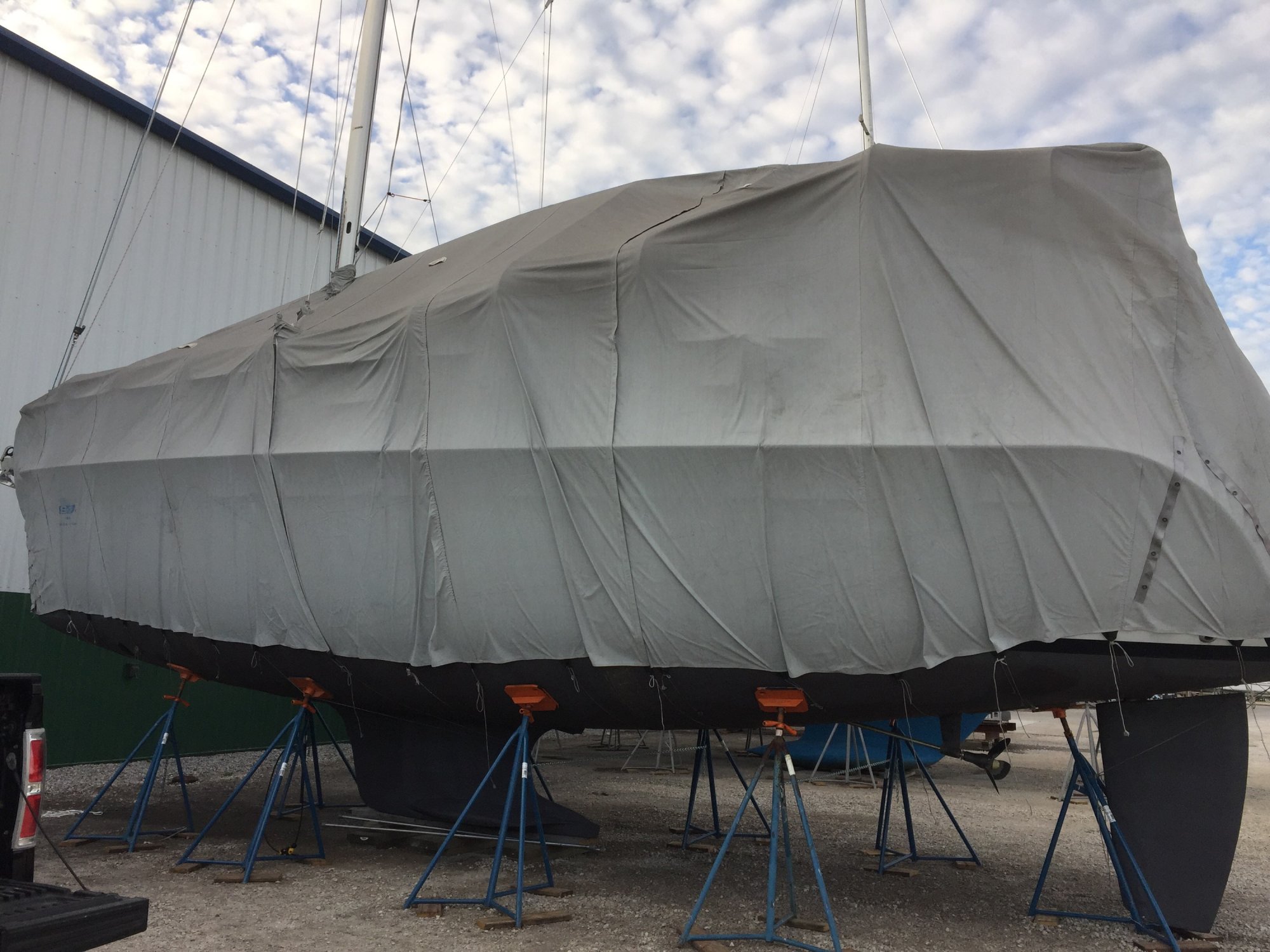

Oct 29, 2016
1,929
Hunter 41 DS Port Huron
Cover every year, mast unstepped every second year, the canvas 3 pc cover is at least 10 years old

Jul 19, 2013
390
Pearson 31-2 Boston
Yeah. Shrink wrap seems stupid. One time use gets expensive.
When you say deck tent, do you mean exactly like that photo ? Why would people cover the hull too ? Especially when it is evidently a problem to trap moisture against the hull paint ?
FWIW: I may eventually make a deck tent with a industrial tarp and a sewing machine. If only for doing late and early maintenance.
The photo is of my deck tent. I personally see no plus to a full hull cover, and if the boat is painted, you do not want the topsides closed in. There is a lot of engineering in a deck tent - cutouts for the mast, topping lift, shrouds, stanchions, bow and stern rails, and all reinforced, plus reinforcements at all corners, plus heavy duty zippers. All the work plus a quality material for under $2,000 was a bargain.
