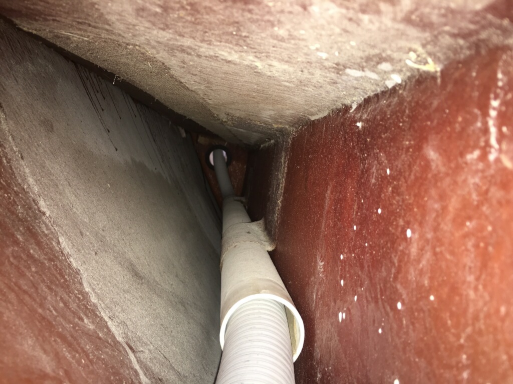

Finally found the opportunity to replace the 1.5" sanitation hose. Based on the odor of the exterior of the completely permeated hose, and the huge difference on the boat, this has been one of the best "quality of experience" upgrades I have done. As Paul J's post would indicate, this was not easy, but I did manage to replace the hose into the existing embedded tube without any modifications. Here is the process, minus the do-overs and expletives. Took me about four hours including mistakes.

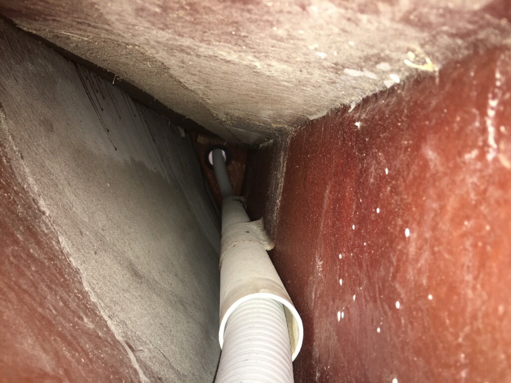

Remove hose clamps at tank. Slice the hose at elbow to ease removal. (Spill first beer). There is a stiff curve from the entrance to the tube up to the tank elbow. I used a PVC cutter to reach in and cut the bend off to ease pulling the hose forward. I just pulled the hose out, a mistake. The tube doesn't run all the way forward to the head bulkhead hole, so any attempts to feed the hose from fore or aft will not work. I needed a tracer line, so I stuffed the garden hose in rear of tube and fed forward until I could catch some of the hose at the hole in the head bulkhead. Worked first try and I tied a line to hose and pulled aft.
What follows is how I would have done it after learning more about what's behind the wall. Before cutting the bend off of the aft end of the hose, drill 3/8 hole through hose forward of most of the bend. This hole will be to attach the tracer line. Cut the bend off of the hose just aft of the hole. Remove the short curved section from the tank elbow. Now is the time to flush area using the nearby hose... If you want all mess over at once, go ahead and remove the lower pump out hose and the macerator hose. Tie a tracer line into the hole in hose. NOW pull out the hose from the head, making sure the tracer line is intact and feeding.
Prepare the new hose by drilling a hole for the tracer line. You will be tying to the aft end of the line and feeding from the back. The discontinuous tube prevents success feeding from the front (Tried it). I left the hose long, including the 6' needed for the pump out line + macerator and fed it down through the aft port locker opening. It was tough to get the hose started into the aft end of the tube, but keeping the tracer taut and bending the tube, it will start. I let the hose lay in the sun while I worked, and it was a bit more flexible. It takes a bit of muscle to keep pushing the tube while bending just right to release. I made progress in 1-4" increments. Since I was alone, my tracer line was fed from the head, over the engine cover, back so I could pull while feeding. Again, keep tracer taut, the hose will feed forward until it hits the head bulkhead. Playing the tracer at the bulkhead, I was able to easily find the tube end to guide through the bulkhead hole. Feed a bit more than you will need to connect the head and take a break. Hard part is over. Clean up again. Open second beer; 1.5 in my case.

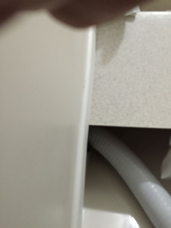

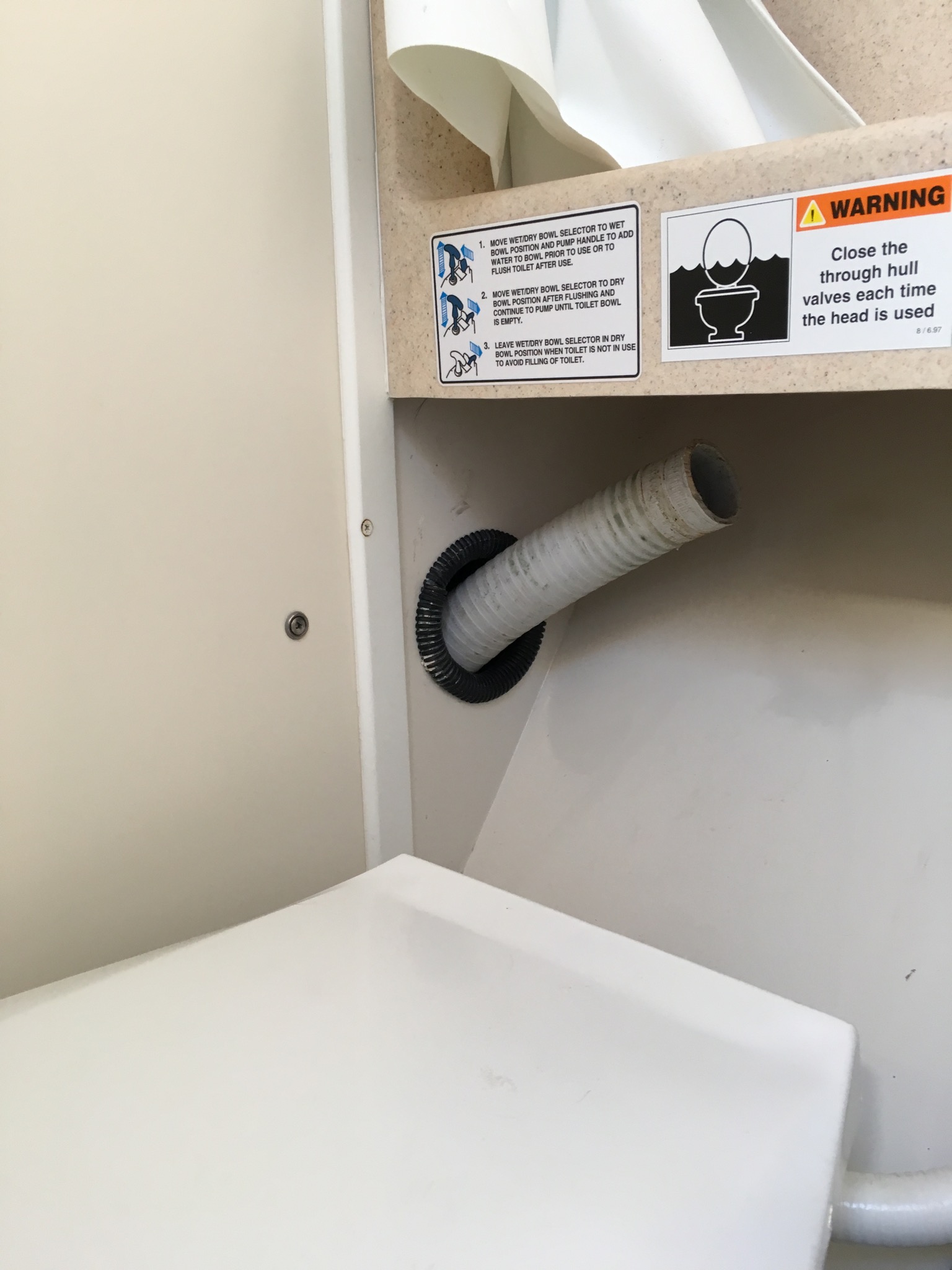

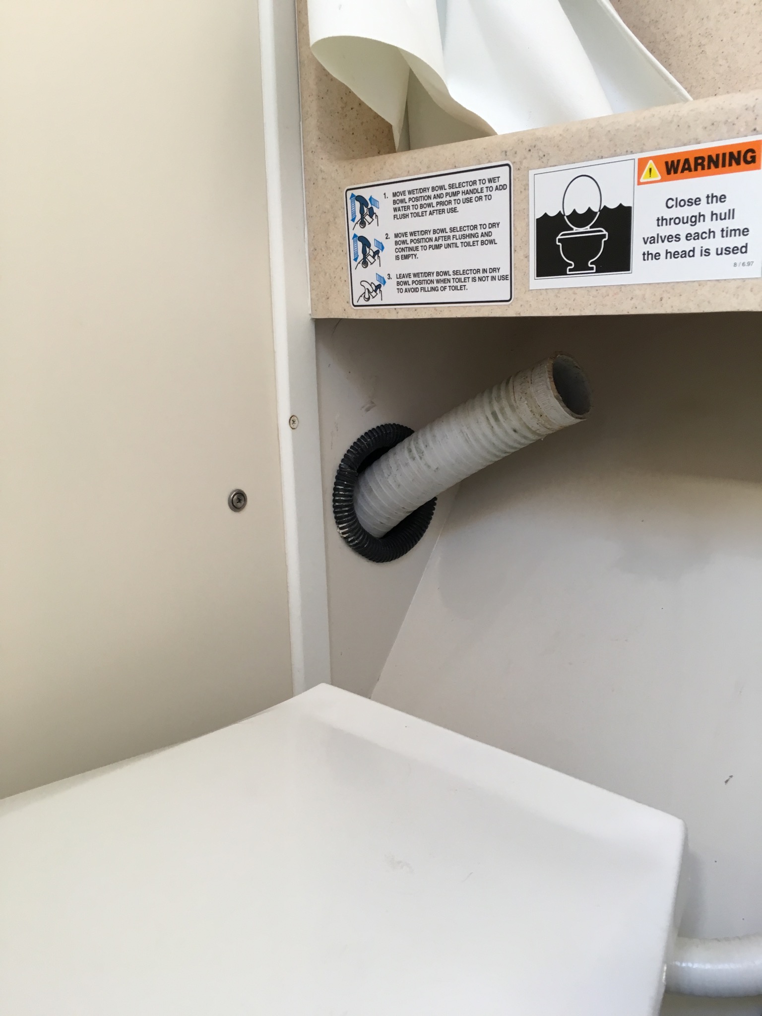

Hi Paul J. In your post of 5/19/15 you included a pic looking from head compartment toward tank. It appears you were able to extract the hose, but your text says you couldn't. Were you finally able to get the hose out? I'm trying to remove the hose on Time & Tide, #179. The curves in the hose are too acute and the hose too stiff to simply pull it out. I've attached pictures at both ends of the hose and you can see the problem. One of your pictures suggests you have access to the channel with the conduit between liner and hull from the head compartment next to the toilet. Did you create that opening or does your boat have an access panel next to the toilet? I'm thinking of creating an access panel in order to have better leverage on hose. Of course I'll have to cut off the tank end of hose in order to get it straight enough to pull thru. Any info you could share would be much appreciated.

Yes, I did create some access ports to help me install the new hose which is stiffer than Trident 102.
I did not run new hose thru the exiting plastic pipe.

Hi Paul J. In your post of 5/19/15 you included a pic looking from head compartment toward tank. It appears you were able to extract the hose, but your text says you couldn't. Were you finally able to get the hose out? I'm trying to remove the hose on Time & Tide, #179. The curves in the hose are too acute and the hose too stiff to simply pull it out. I've attached pictures at both ends of the hose and you can see the problem. One of your pictures suggests you have access to the channel with the conduit between liner and hull from the head compartment next to the toilet. Did you create that opening or does your boat have an access panel next to the toilet? I'm thinking of creating an access panel in order to have better leverage on hose. Of course I'll have to cut off the tank end of hose in order to get it straight enough to pull thru. Any info you could share would be much appreciated.View attachment 126507View attachment 126509
Thomas, I replaced those hoses recently on our hull #31 C310. One trick I found was to drill two small holes (1/4" or so) in the ends of the old and new hose. Use cable ties (zip locks) to connect the two hoses together. Then pull the old one out as you feed the new one in (I did it from the tank to the head, I think, but it may not matter which way you go). It worked pretty easy.

That's one way to do it. However the cable tie "locks" could get caught in a really tight space or hung up on a hole in a bulkhead. The recommended way is to buy a male-male hose connector. Cut the ends of both the old and the new hose as cleanly and squarely as possible...you want a smooth unbroken surface when you butt them together on the connector. Use pvc cement to "glue" the hose onto the fitting. Now you have nothing that can get caught, which of course would never happen anywhere that would be easy to reach to free it, only in a totally inaccessible place.
