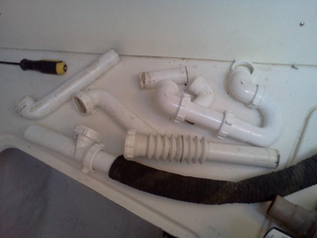

Well I left the sanitation for last and I am paying the price. It should have been item ONE on my refit but it will all work out
. Started by looking at the forest of fittings the P.O. had on the holding tank and decided to simplify the whole mess. I am trying to replace as much of the hose with 2" PVC pipe. Cheap, odor proof and simple to work with. There will still be some hose but I feel I can get from 25 ft of hose down to 10 ft by replacing all the horizontal runs with PVC sched 40.

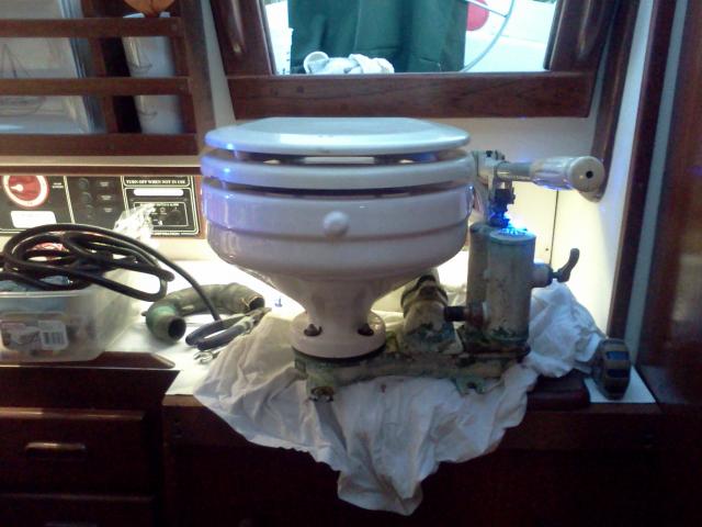

My question is this. Removed the nice W.C. bronze vent elbow. Has a valve cap on top. The vent hole in the elbow is solid with crud. Is this hole suposed to be open??Is there a valve in it (similar to a bicycle tube schradder valve??) Can I drill it open?? The screw cap on cap seems to seal it and would not allow air into it so what is the purpose of this valve stem??
Now, on to rebuilding my Imperial throne.
Thanks for your insight.
