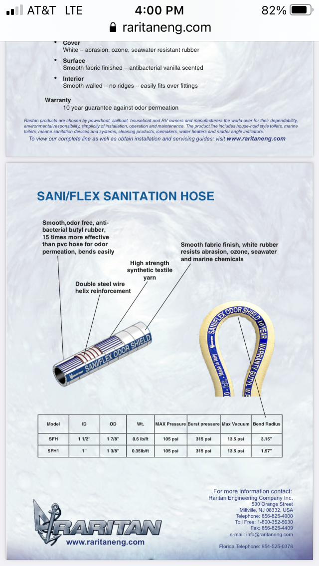

Who (anyone?) has successfully stretched 1 1/2” Raritan SaniFlex hose to fit over a 1 5/8” OD pvc hose barb? Or over a 1 19/32” OD pvc elbow?
If you have ACTUALLY DONE IT plz tell me how you did it.
Everyone else - Plz stand by and do not repeat all the same old good advice that we’ve all read and heard.
If you’ve ACTUALLY DONE IT, I’d
to hear fromYOU.
Thank you.
Included is a photo of the steel reinforced hose I refer to.
