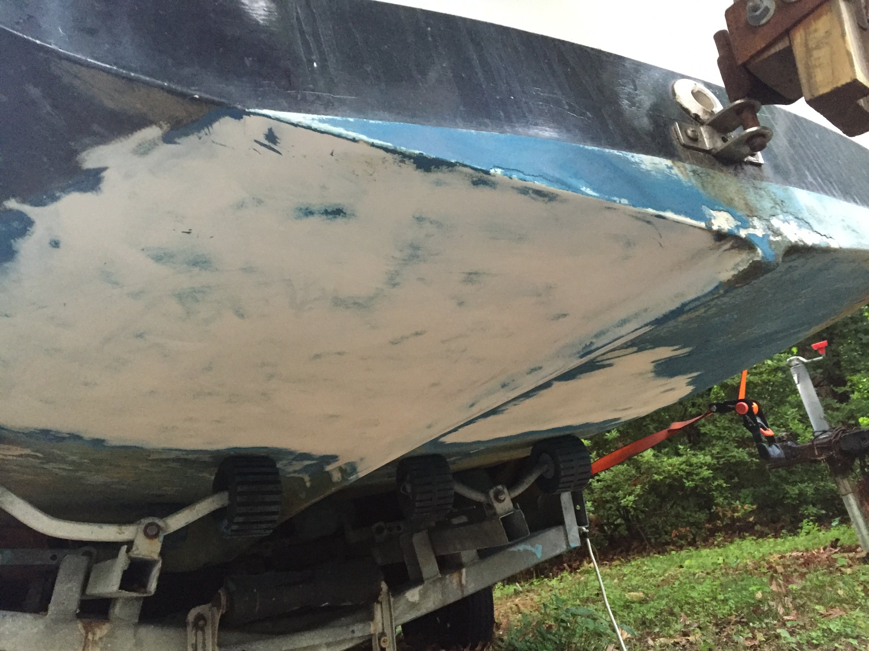

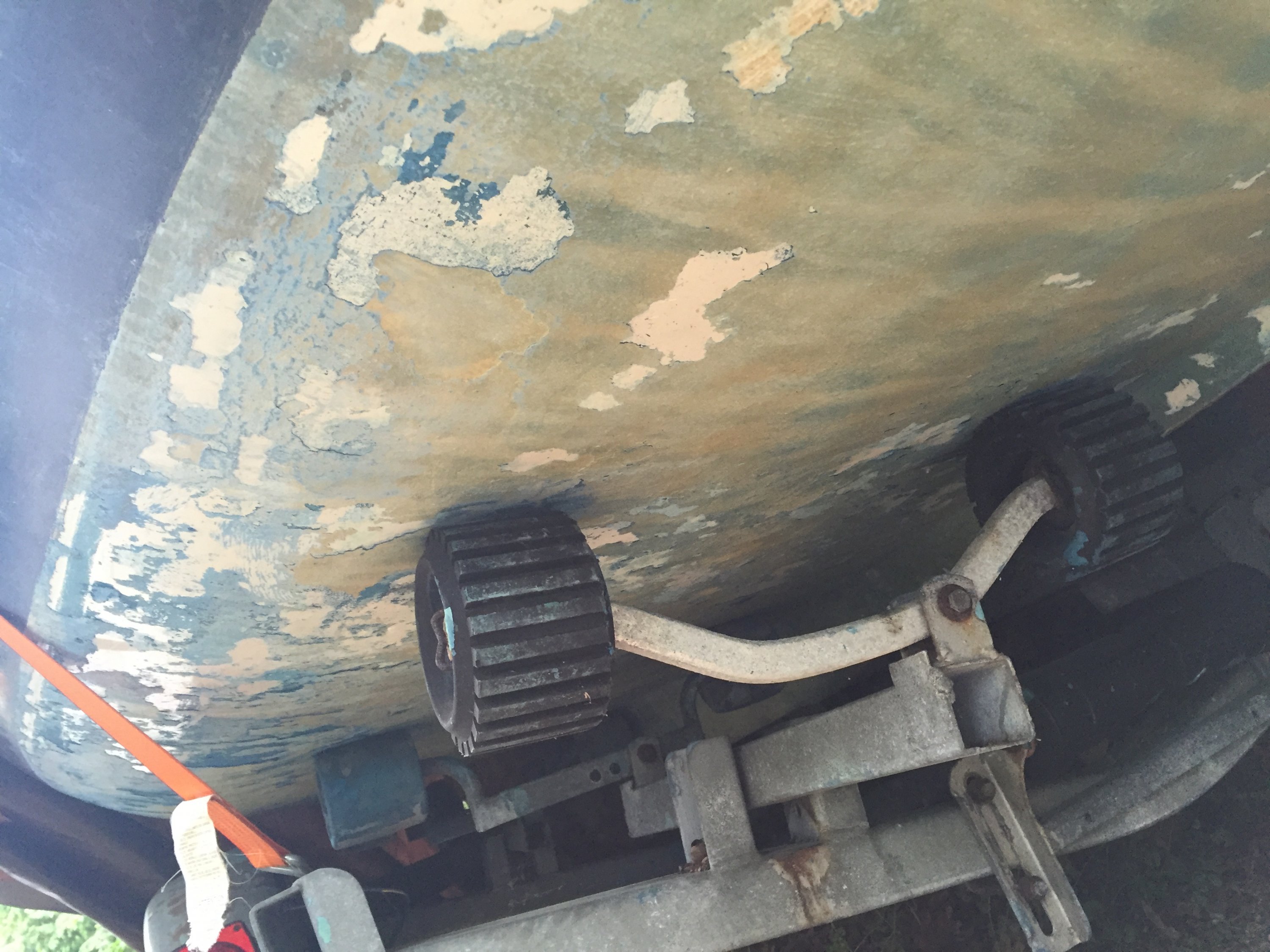

It is on a trailer in my yard and will be trailer sailed. The bottom looks like the attached pic.
I read about paint strippers. Never read a good review - always seemed like it didn't work as advertised. Scrapers - ton of sharpening and risk of gauging. Crazy how many times this subject has been written about but still not a defined "best approach"

Brett, looks like your on top of it. Looking at your photo I still think you might give scrapping a try. It looks like a lot of paint has already flaked off so it may come off easier than expected. Go gently and you can avoid gouging. Maybe be easier than sanding through bottom paint with a heavy grit and hitting gel coat and going through that before you know it.
I used one with changeable blades so no re sharpening. When the yard media blasted my bottom paint because it was flaking off, they left the last 2" near the water line because they did not want to hit the good gel coat. I was able to scrap off that 2" easily without any gouging.

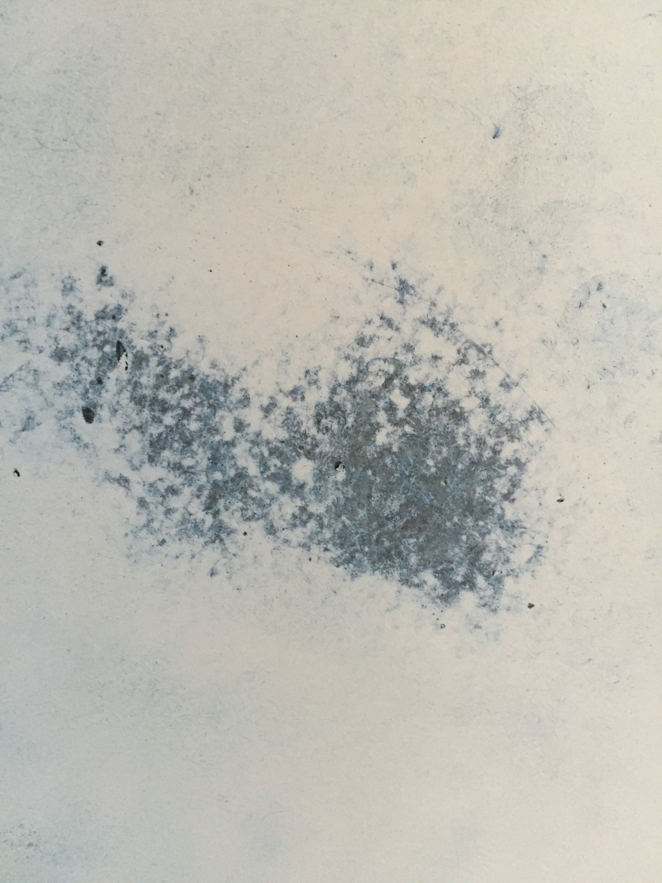

The downside is I think I went to much and hit fiberglass - see pic.
I hope this is easily repaired!!!!

You can coat the bottom with Interlux Interprotect 2000. It will cover all your sins.

Ok. I was thinking I needed to put gelcoat paste on and then sand it.

You are doing fine... don't worry about 'hitting fiberglass'. Take agprice22's advice and paint the bottom with Interprotect 2000. Get a gallon of it and use the whole gallon on the hull, keel, and rudder. Use a 1/4" nap roller, foam rollers are ok but the paint on too think and it takes too many coats. 3/8 nap is too thick. Its what we call a 'barrier coat' and also the primer for your new bottom paint. You'll need to get the boat off the trailer and onto some type of stands to finish sanding and paint.
