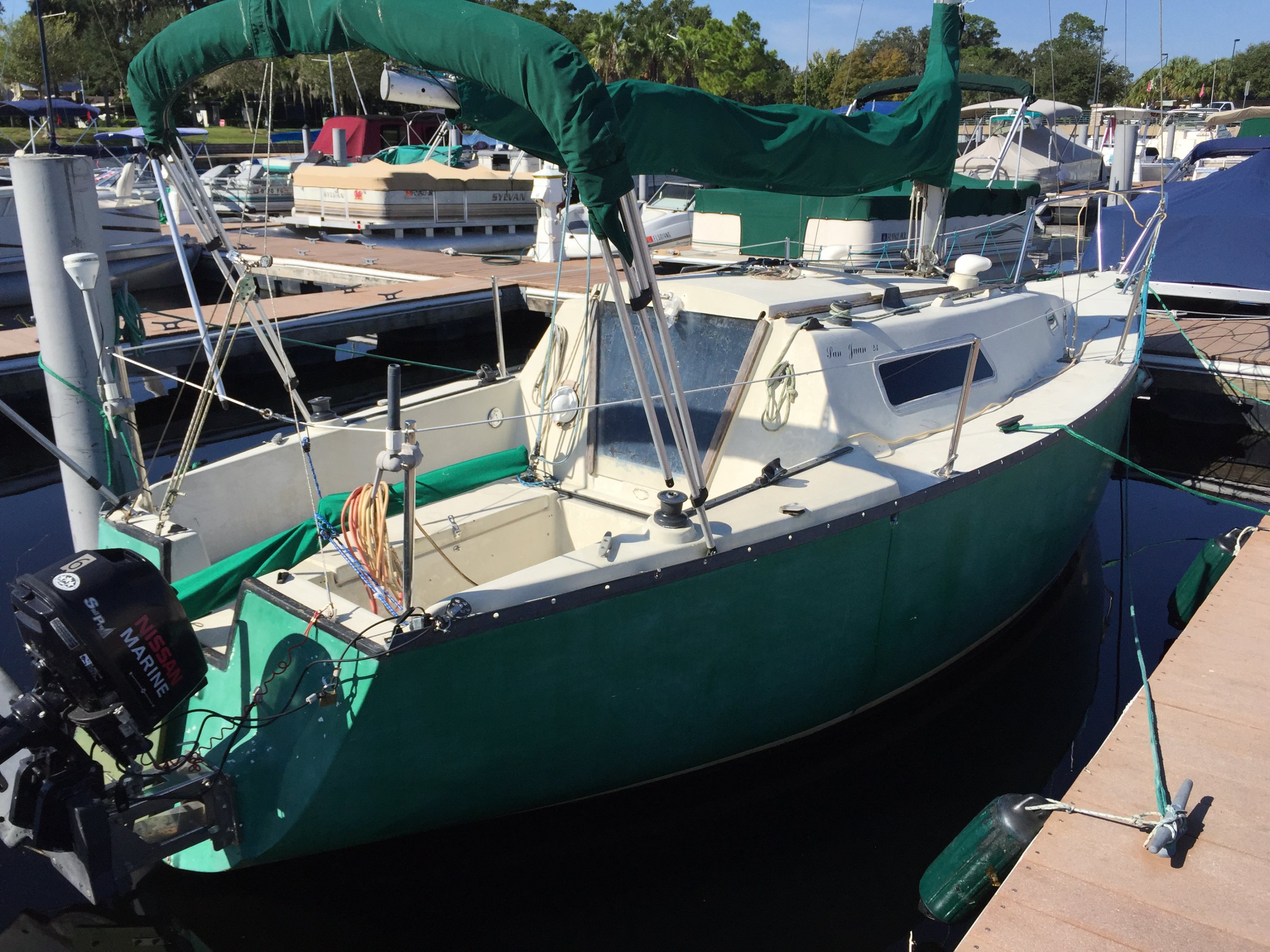

Hello, new to the forum, 1st post. I just bought this SJ23 1979, all is well with the boat, so far. My question is about the 2 cockpit drain holes, one appears to drain fine, the other not, if i put the hose on the one working the water doesn't back up, on the one not working (port side) water doesn't drain as quick (backs up with hose)....
Is there an access point to these drains?
Could the water be going in the hull?
Recommendations? (not Drano)
I haven't been able to find any drawings/plans/blueprints on this boat.
Thank you in advance.

No, yes, not Drano. There might be an obstruction, see if you can run a wire to clear it. I would also be wary of the one that drains real fast as that could be the one leaking into the hull. Crawling into a cockpit lazarette might allow inspection of the drain conduits under the cockpit sole.

If the drains (scuppers) are like my 24 had, they are straight down through the stern lazarette and out just under the water line. You may be able to see the obstruction with a light from the top. A straight iron rod might loosen it.

Sorry, Alexvw- my wording is not quite accurate- the tubes go down through the crawl space under the cockpit, not the lazarette.
