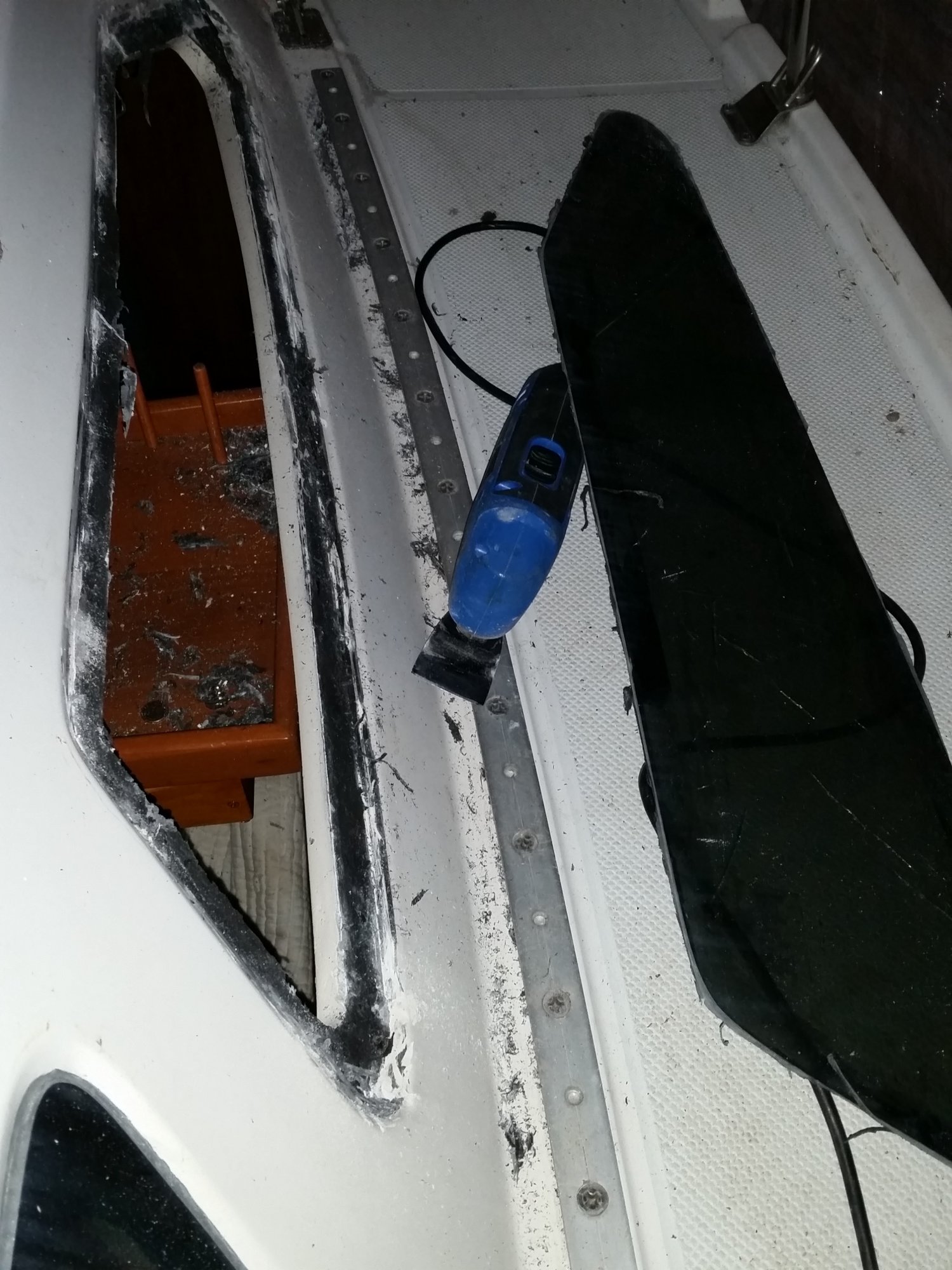

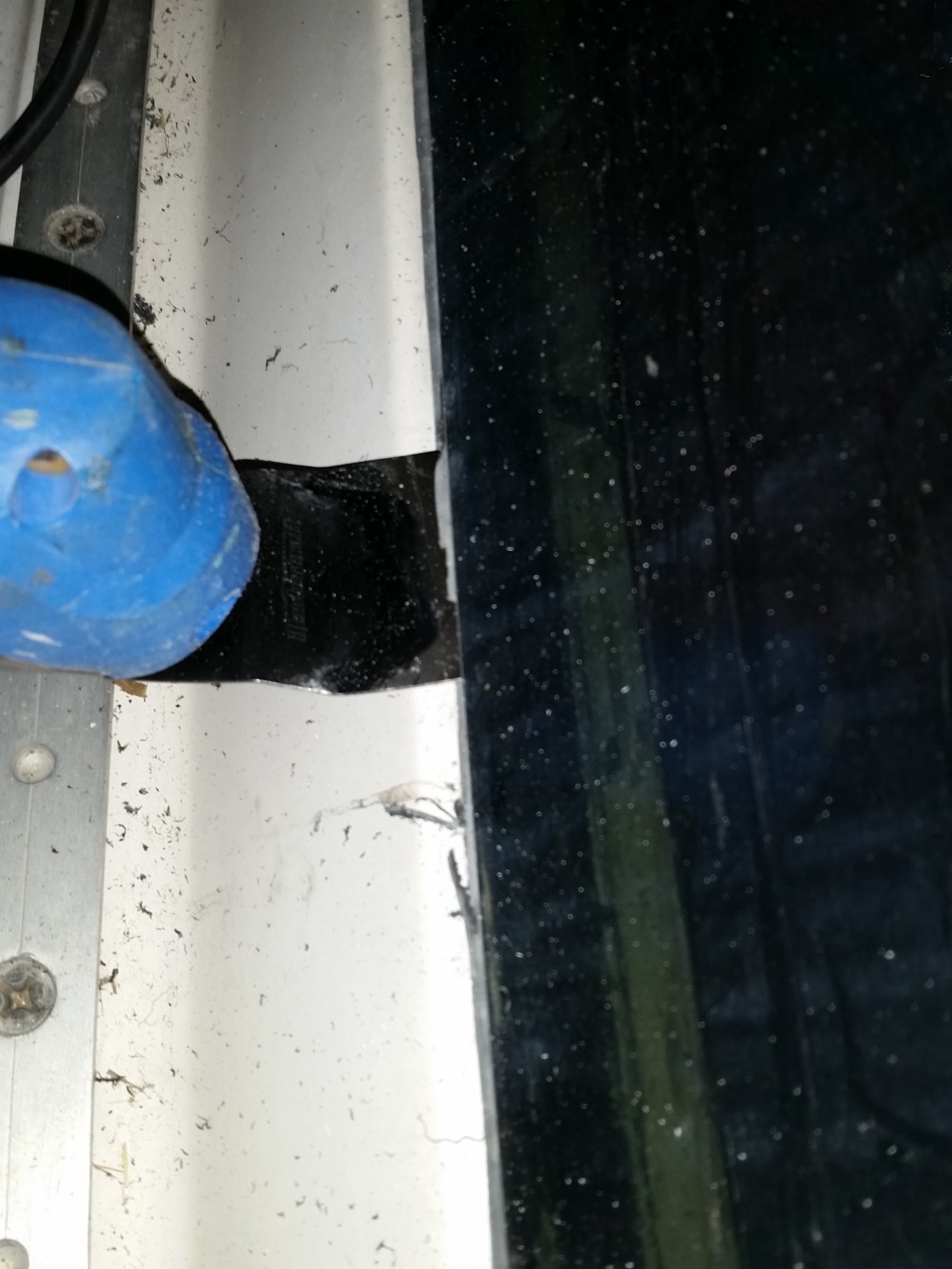

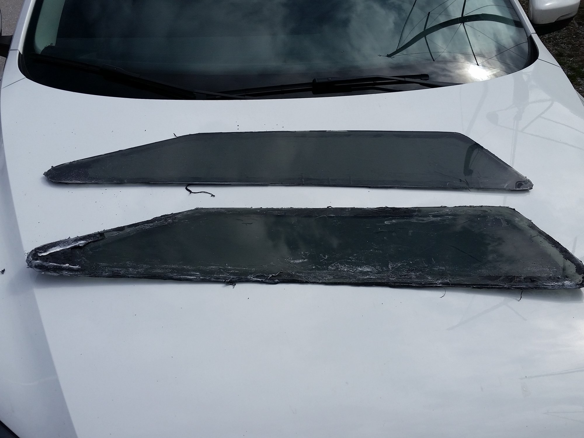

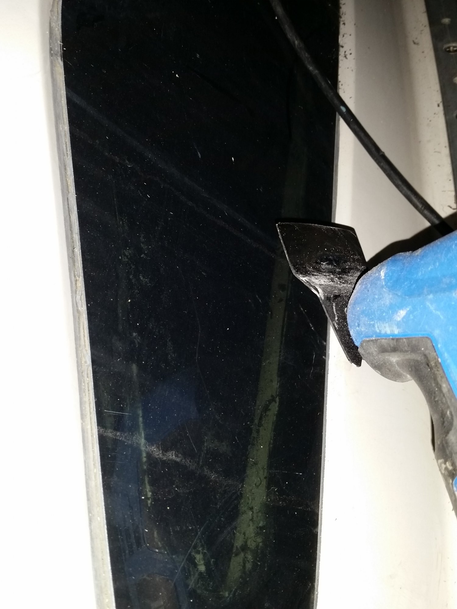

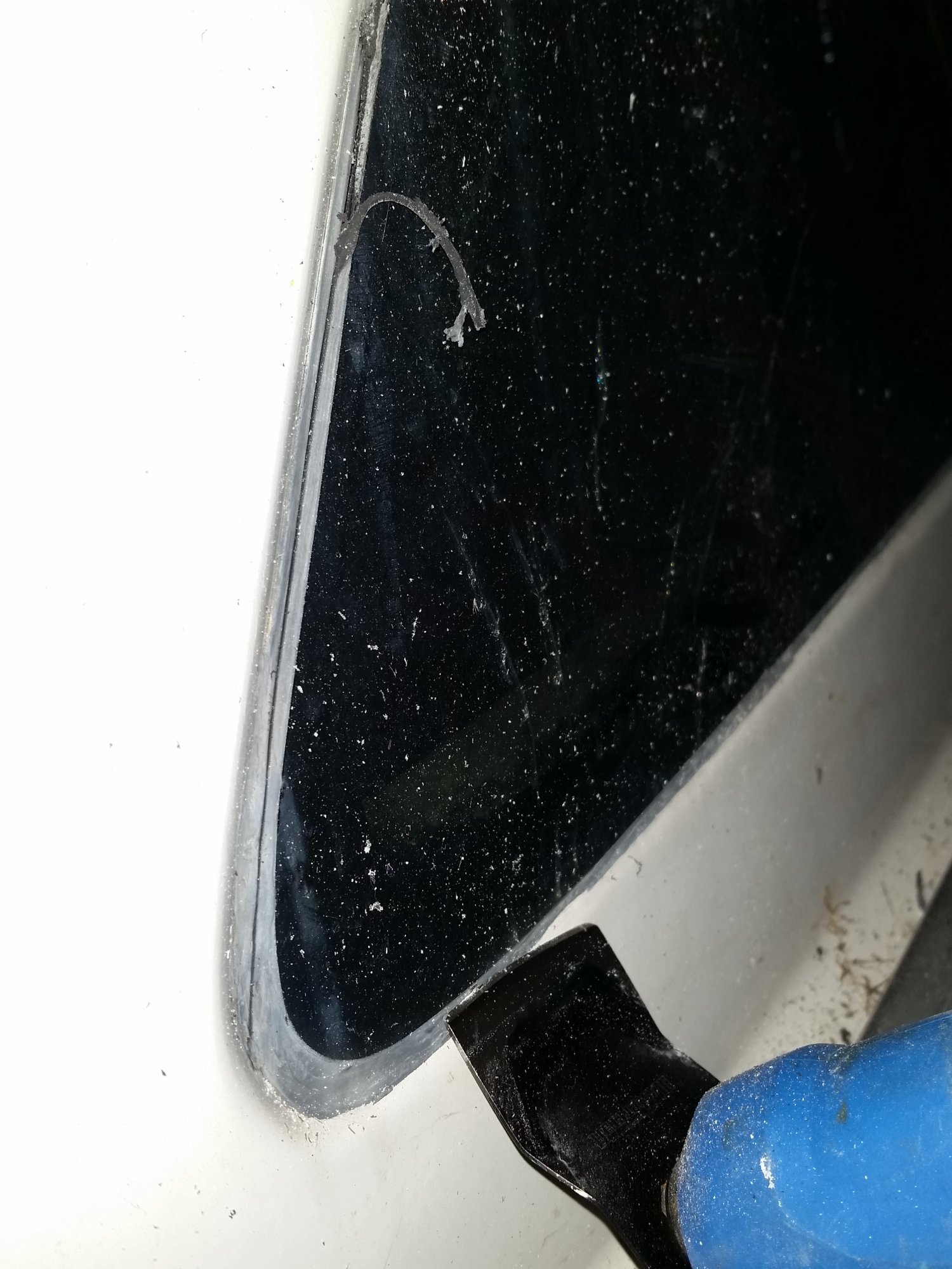

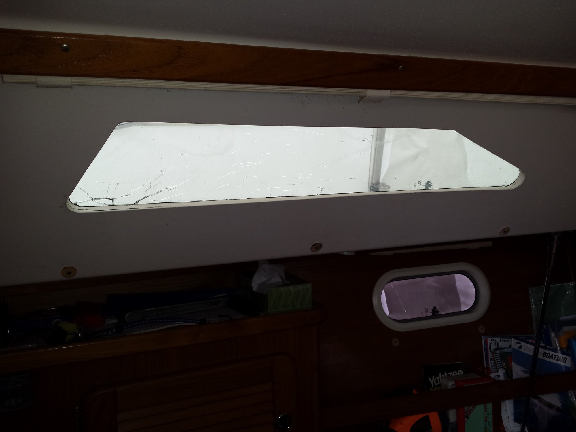

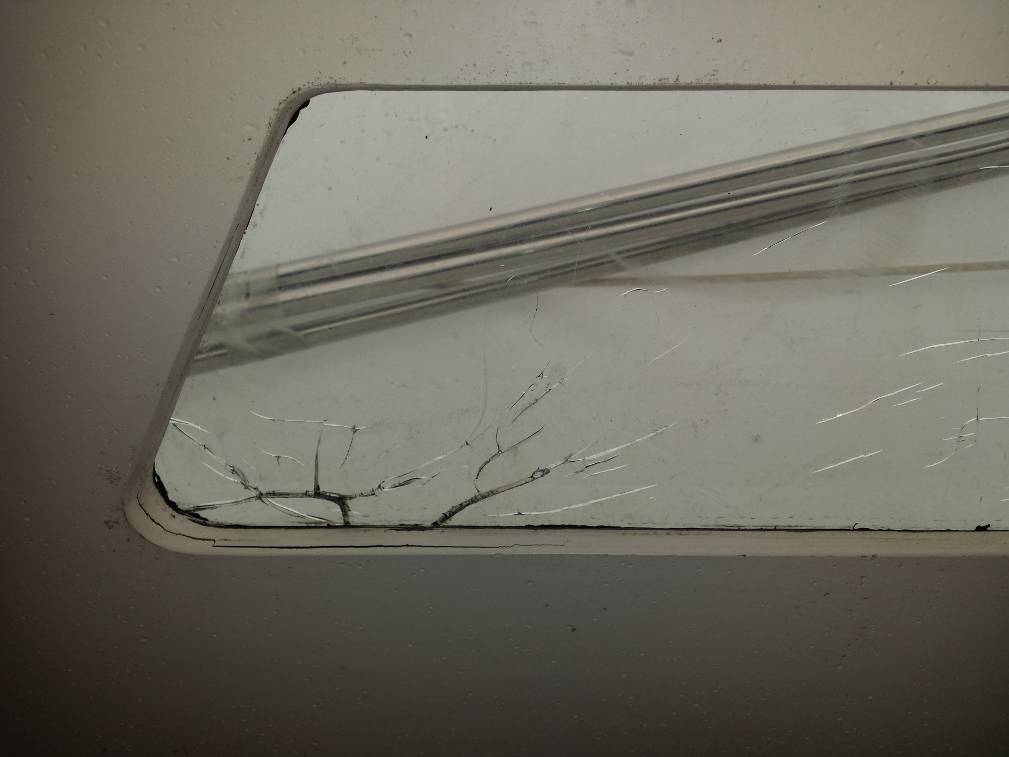

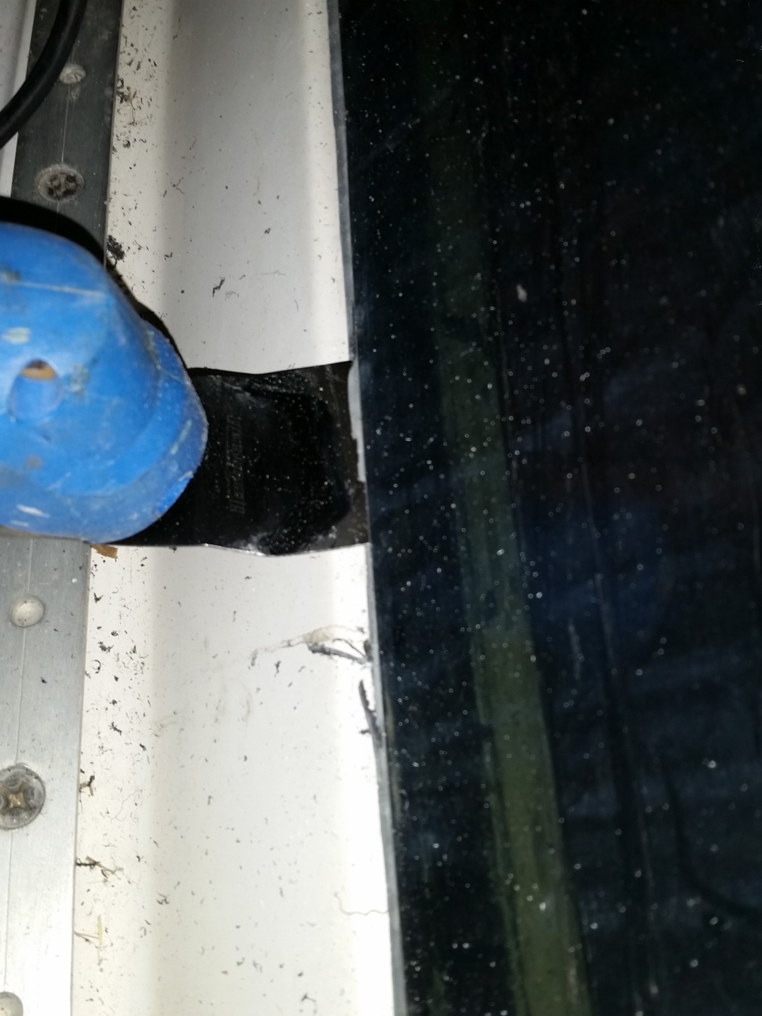

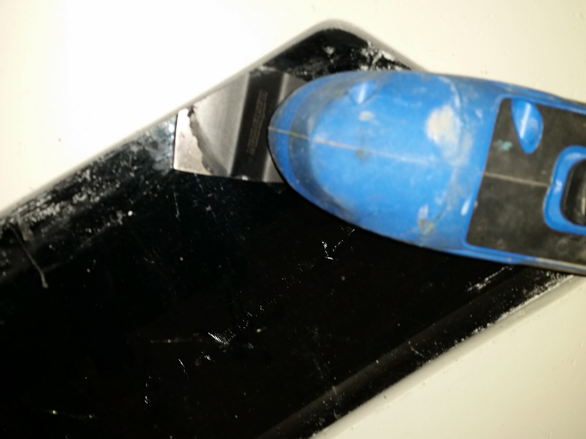

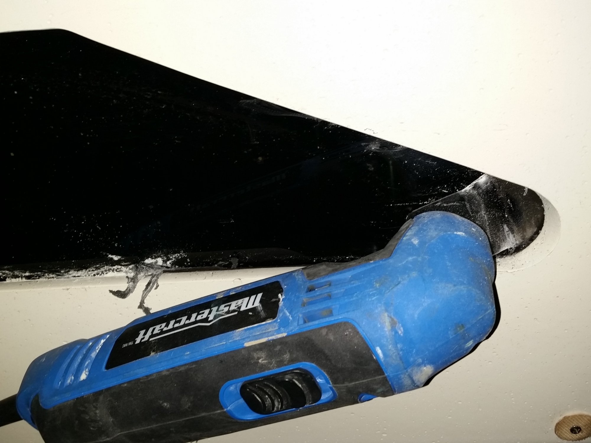

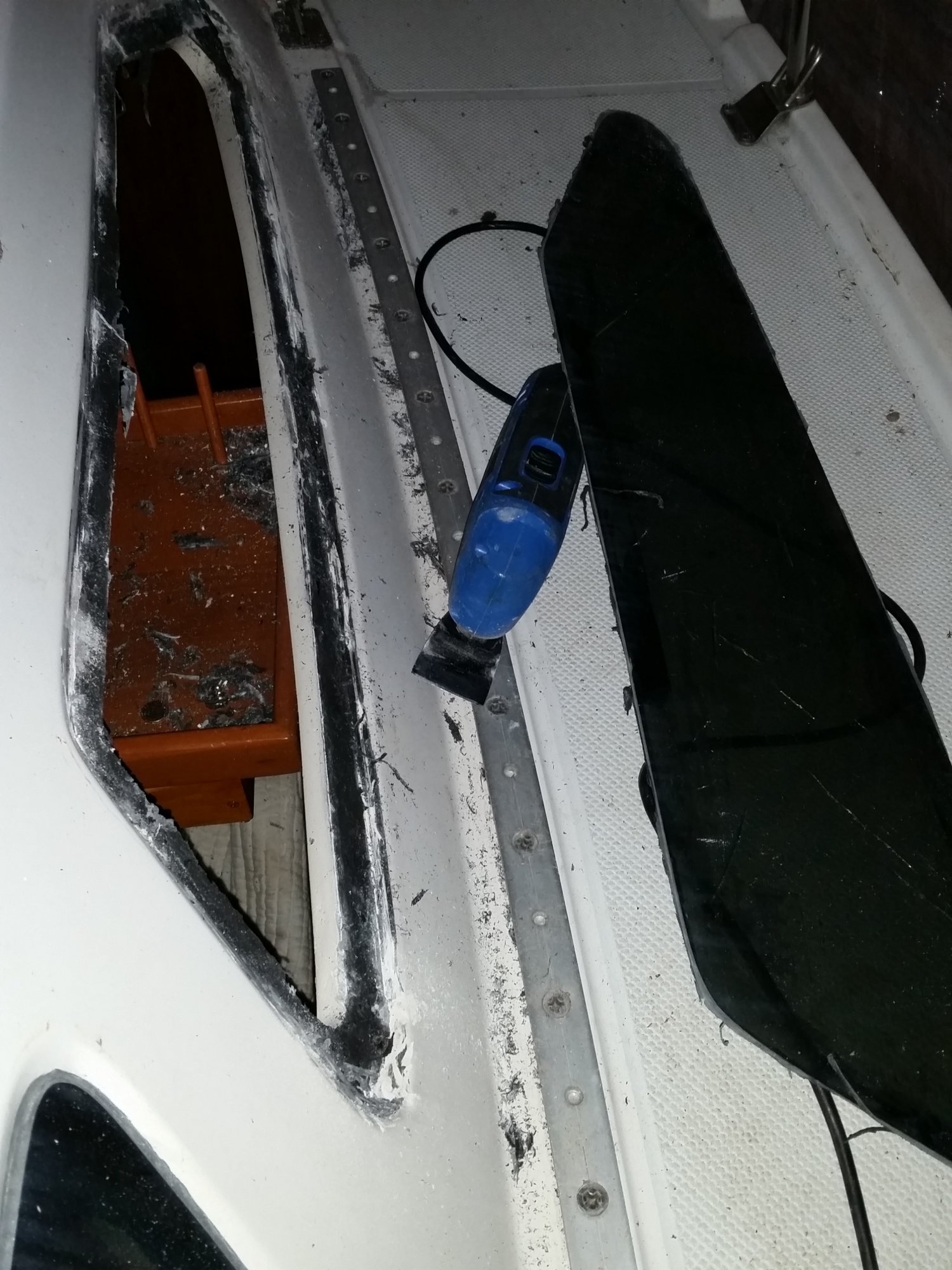

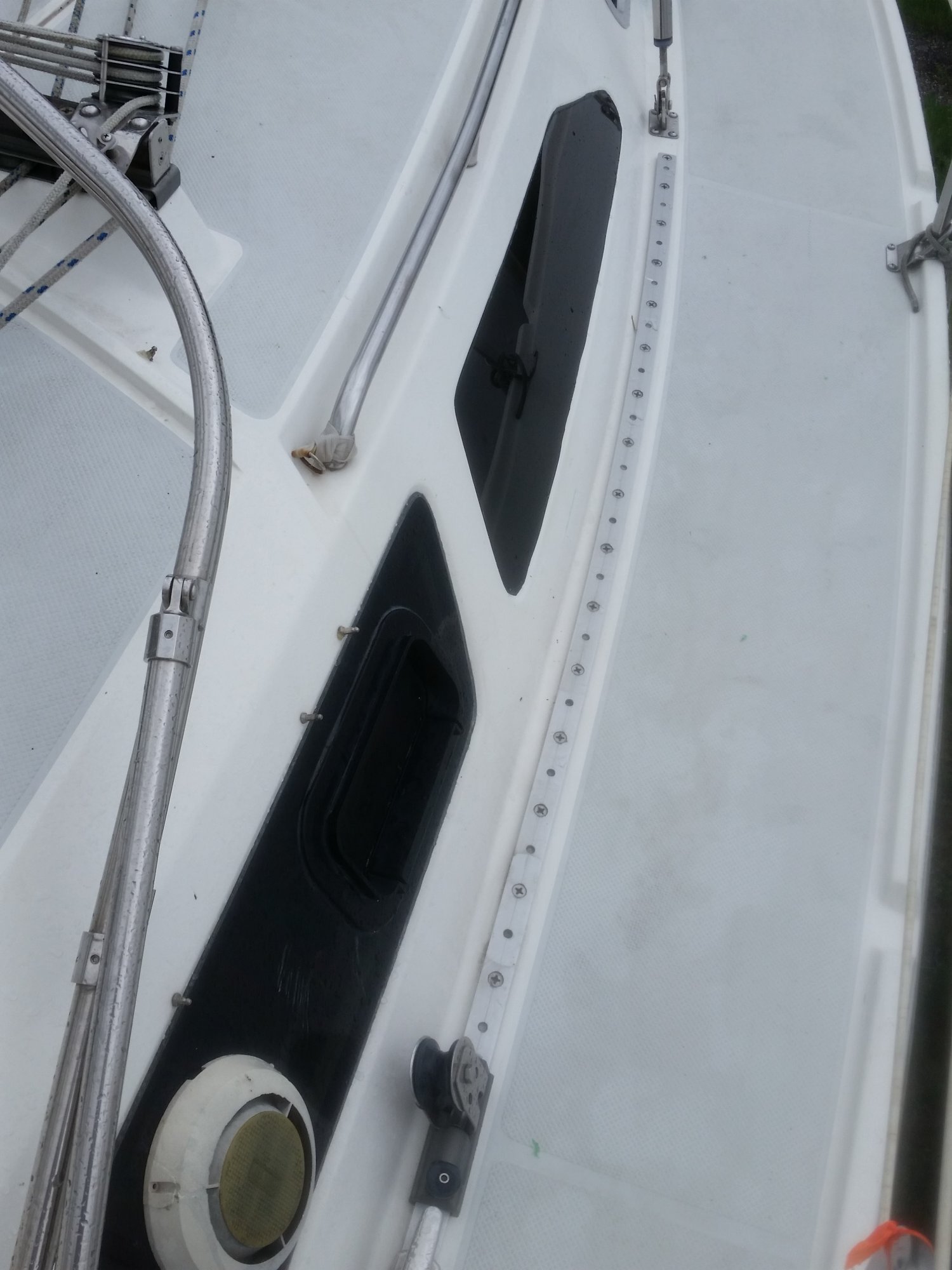

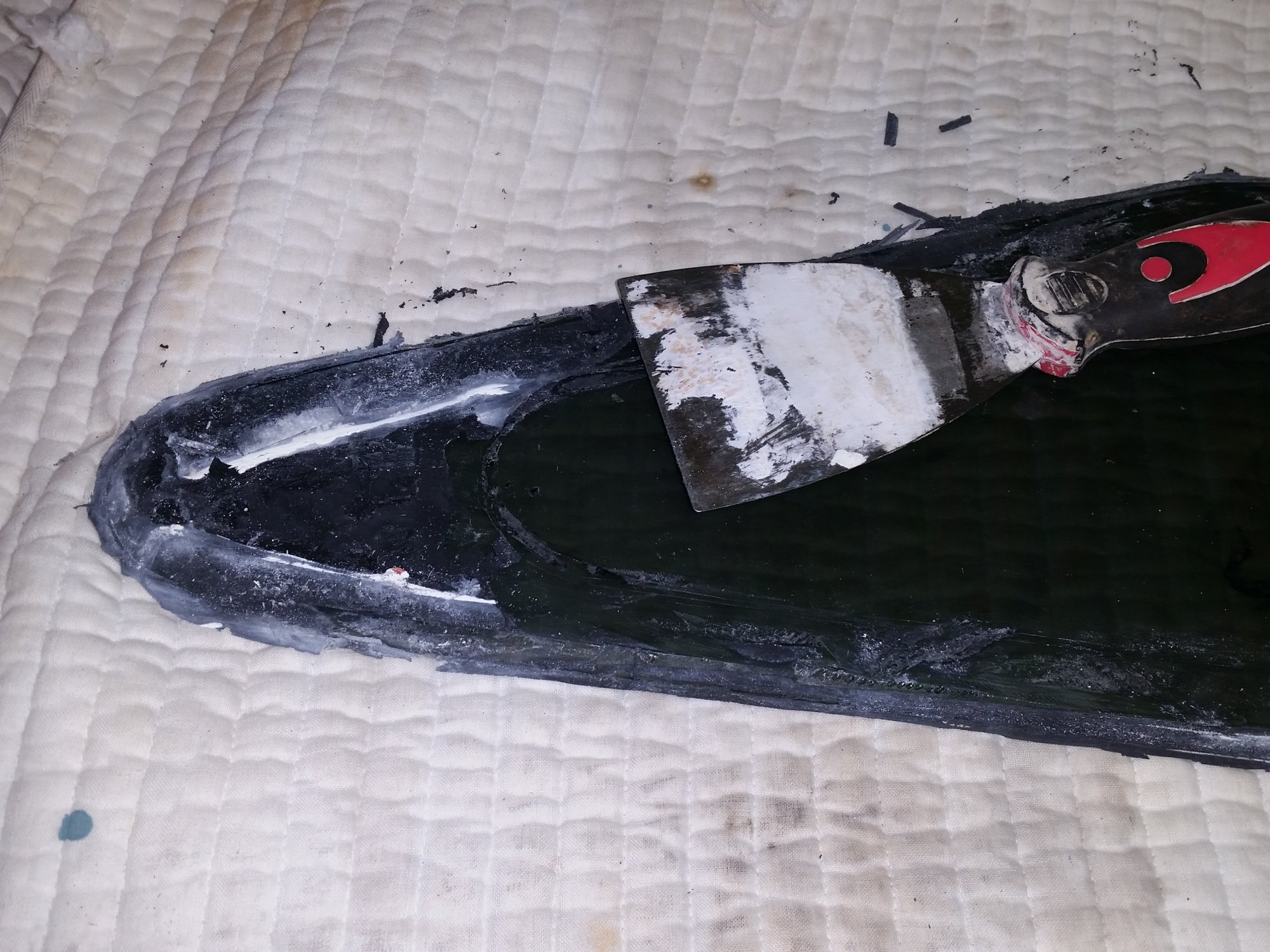

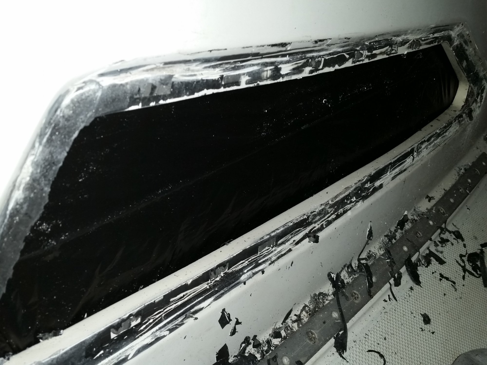

I replaced 2 fixed portlights 2 years ago on a 2000 C310......removal photos of cracked portlights attached.
Used orbital tool with paint scrapper blade for portlight removal.
Dow 795 was a great adhesive to use.....product used to install office tower windows.
Dow 795 was $8 a tube ( 1 per window ).....1/4" smoked acrylic was $246 for 4'x8' sheet......enough for 8 portlights.
As highlighted in previous posts.....not technically challenging, but does take some time and is a little messy.
Made boat look new again......no issues 2 years later.
See photos attached

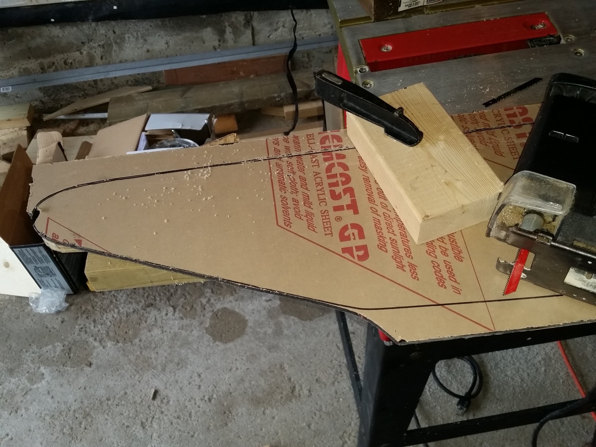

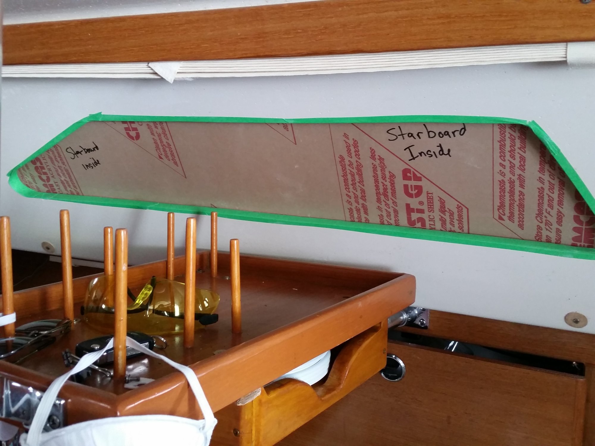

May 10, 2012
11

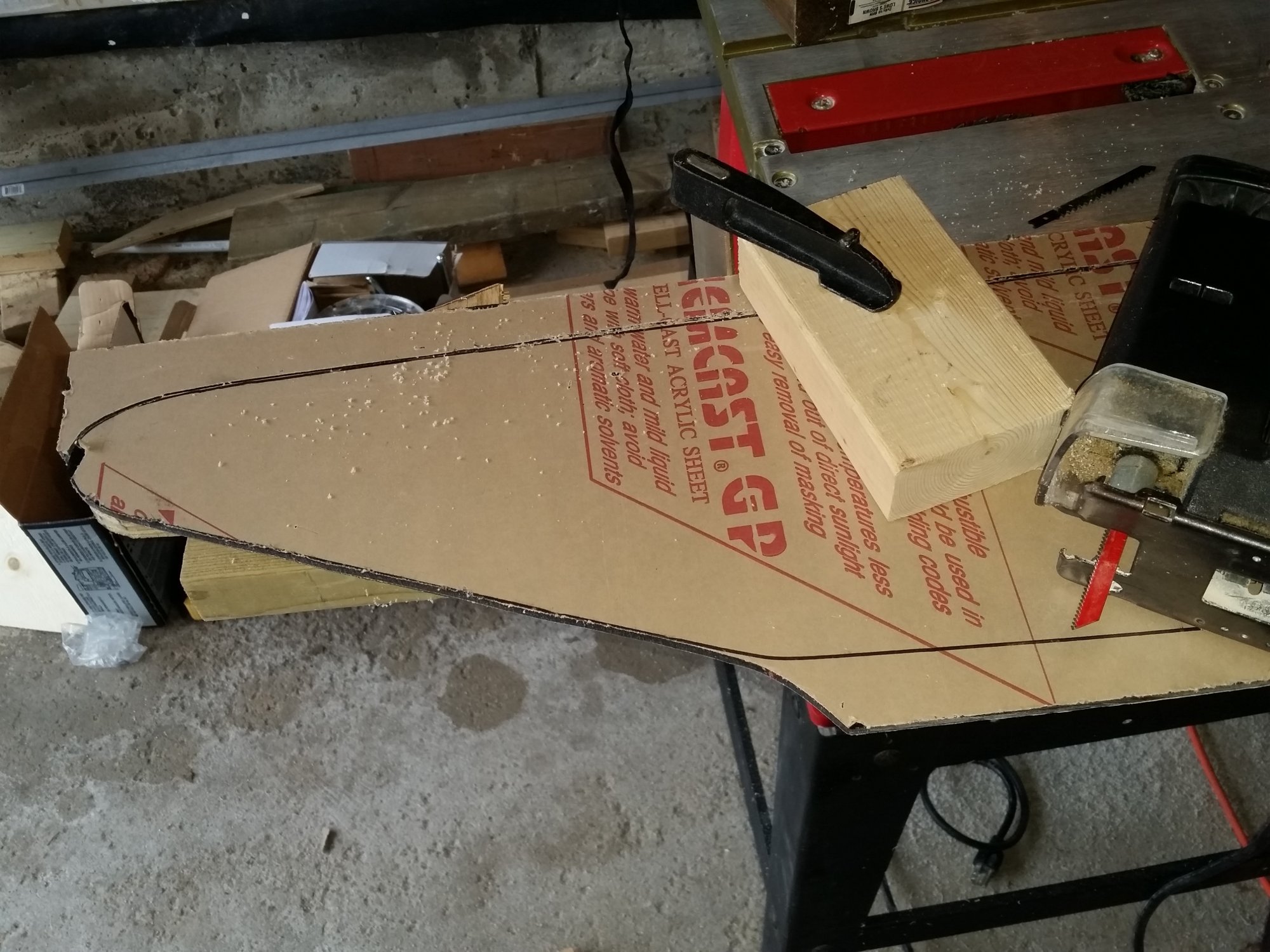

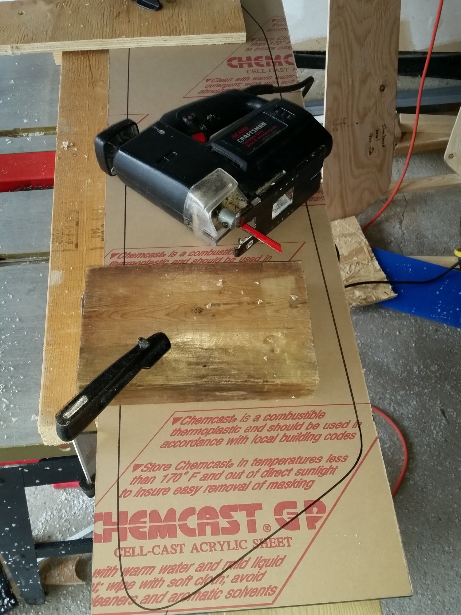

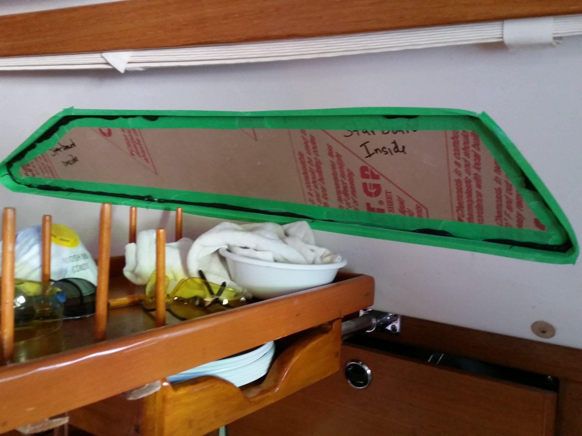

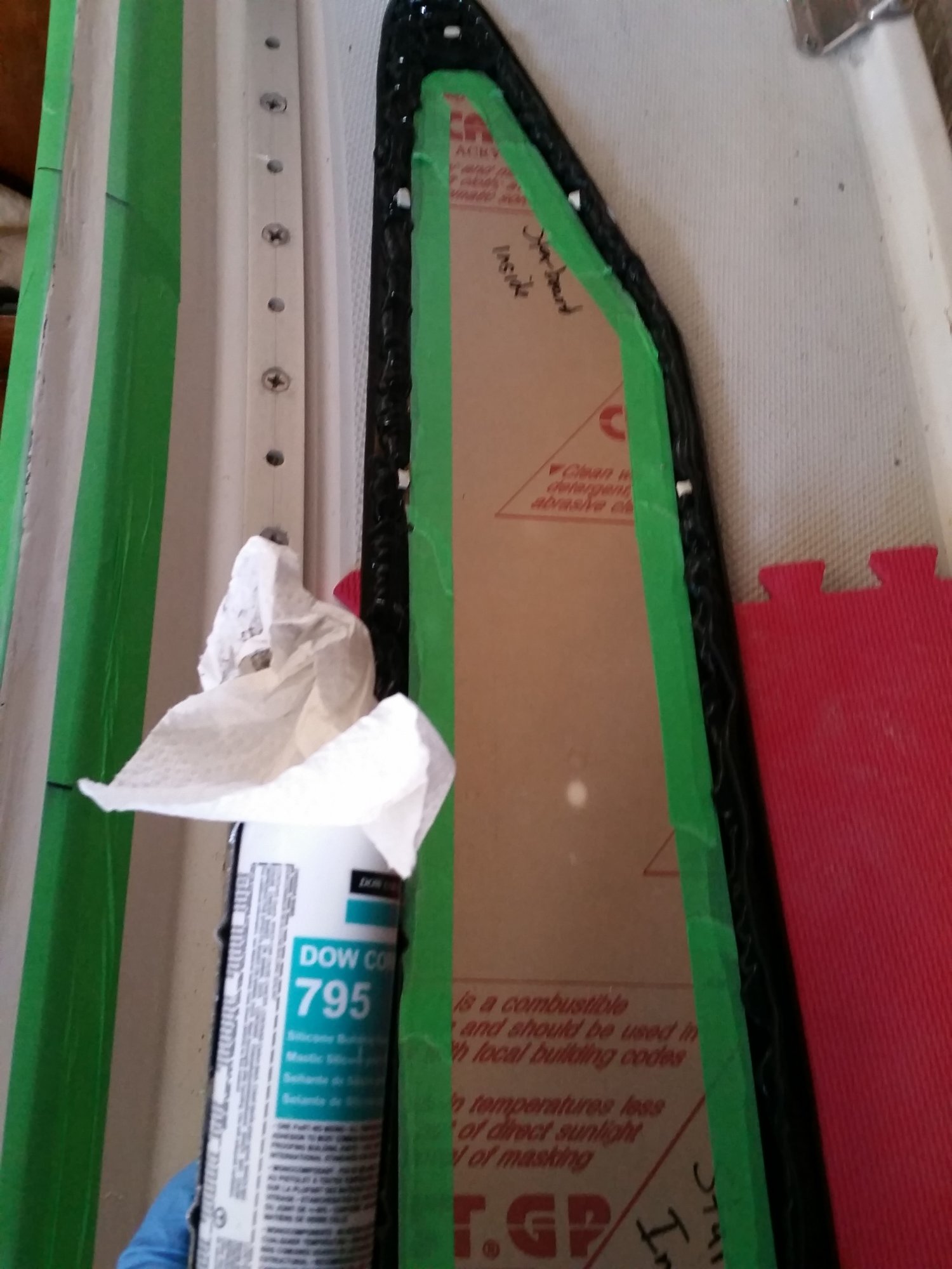

Catalina 310 Bayport

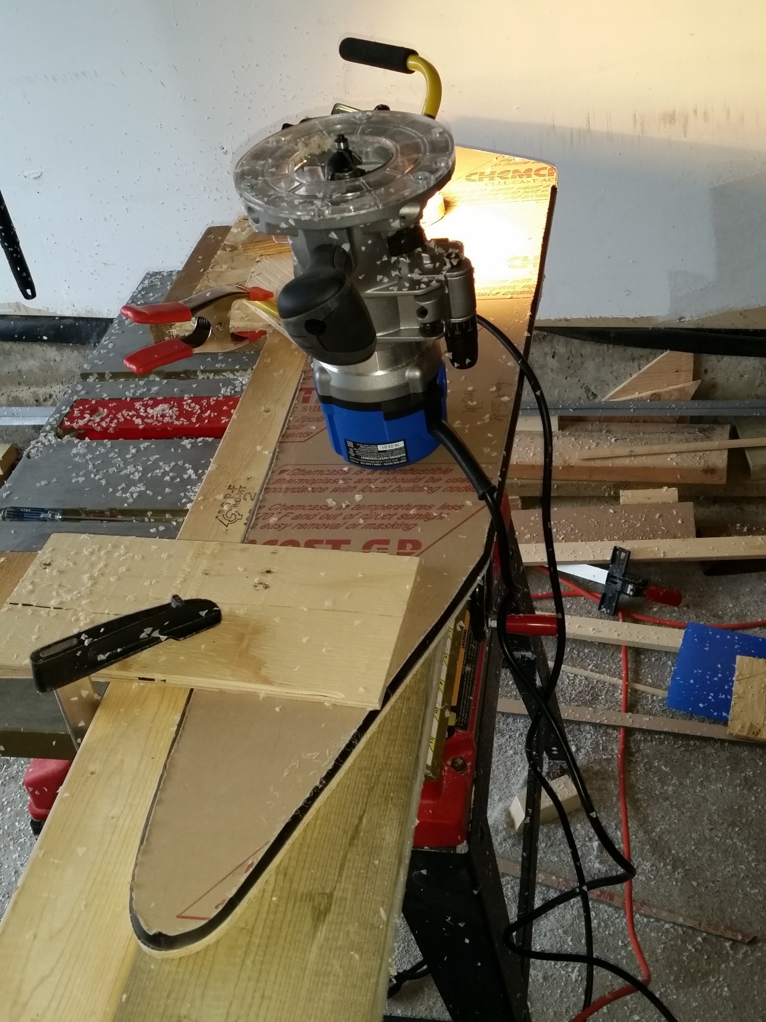

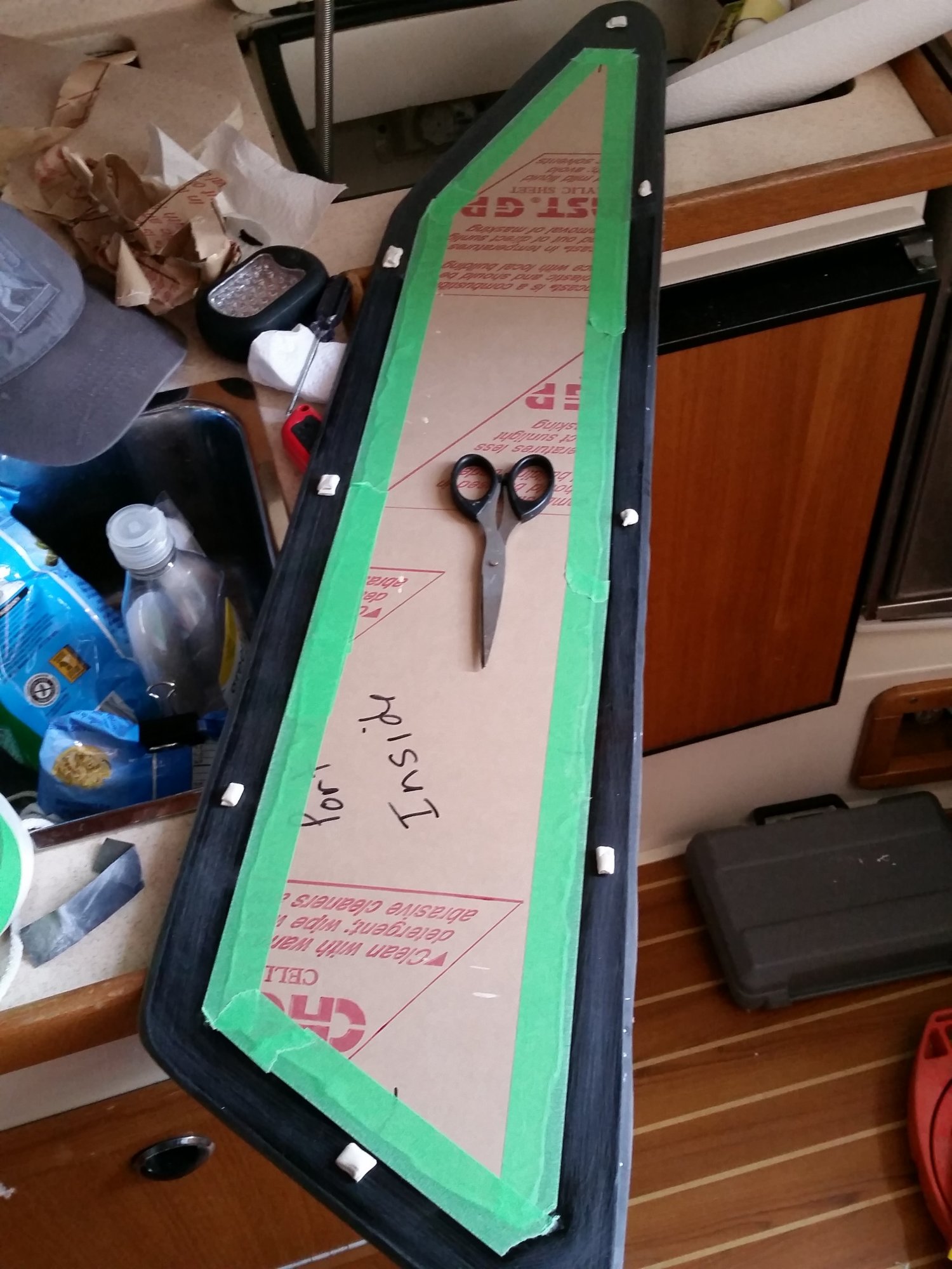

Reinstalled new portlight windows......photos attached....2nd of two postings.
Used old windows as templates.....scroll saw and router to fabricate.
Dow 795 was a great adhesive to use.....little butyl tape to ensure a gap for the DOW 795.
