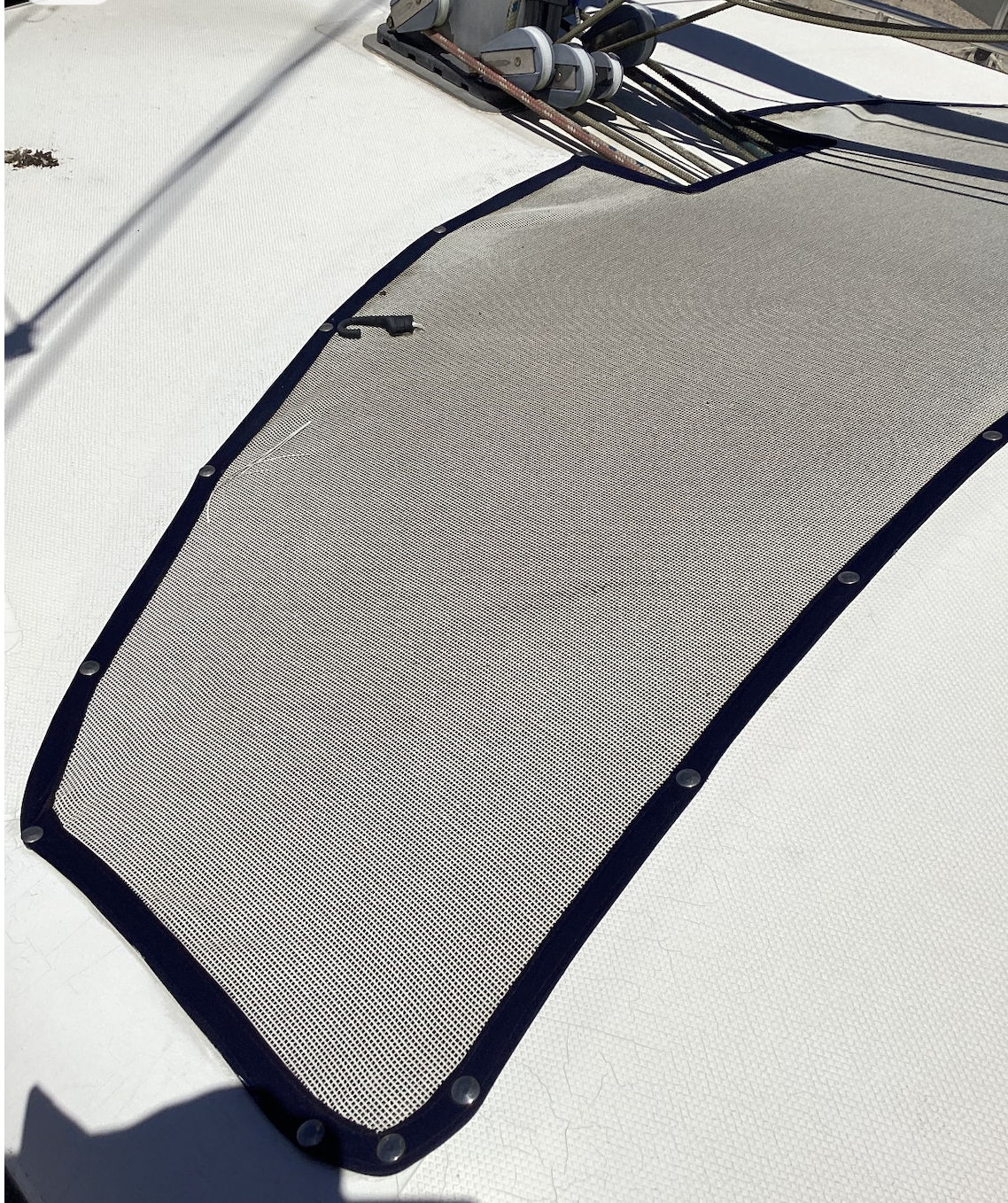

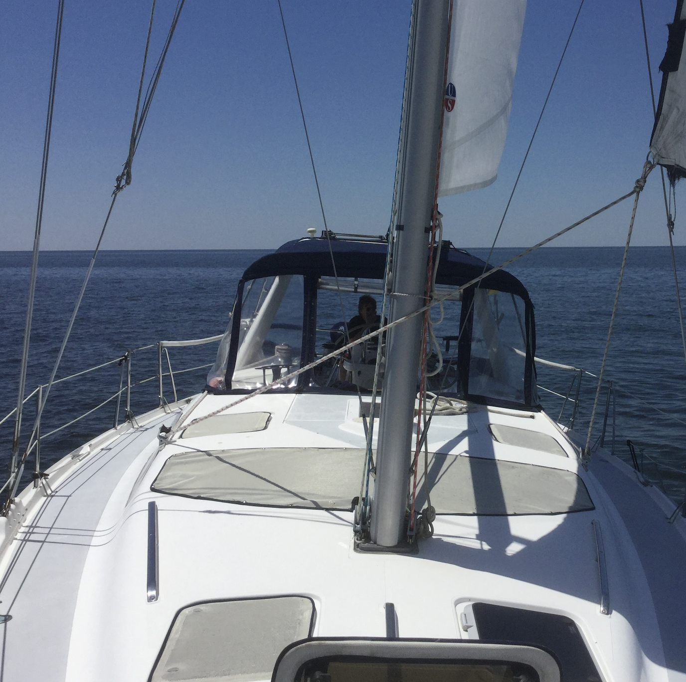

Once you fix it you will need this.
Or go bannas and do this :
I finally installed the three hatch covers a couple of years ago.
Didn't use buttons and that was a challenge. The big plus was the drop in interior temp in the summer when the boat wasn't being used.
