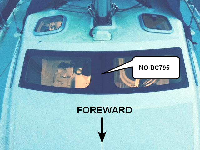

Not sure what your front (if it is front) hatchlight configuration is like but with our boats being one year apart (but different lengths), it "MAY" be one solid piece right across the deck which is a crack, in the centre, waiting to happen :
When one considers the enormous thermal stress involved in the winter (summer gives you compressive forces IIRC the relative thermal coeff. of exp. ) you will see how the window cracks open and why plastic welding and glue are as just as effective as spitting on the crack.
The problem I have is that every winter the glass contracts and opens either the port or starboard edge of the window which causes a small leak. After a few years (cycles) when it gets annoying enough, I seal it up with 795 again.
The support at the centre fothe window has no 795 on it so it's as good a place as any to split vertically at 90° to the stress as it does with the OP. Why my loooooong hatchlight doesn't split is due to the thickness of the sealant around the perimeter but I'm too lazy to get into that explanation right now.
Do to the large stress across the glass ( <--- x --->) you will need a sealant, not an adhesive, which will move with the annual compression and expansion.

split the window and use the center frame as a structural edge for both pieces,
Which is exactly what Hunter did in later models when they split the large forward window into two pieces with a narrow FG separator in between the two windows. Shorter windows = less thermal stress.
