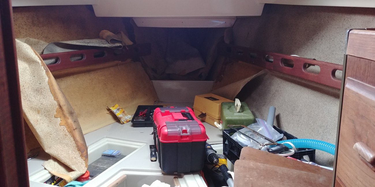

The carpet-like material on my 23' O'Day on the interior side of the hull looks bad and needs to be replaced. Does anyone have advice on how to get the old stuff off and then what to use to glue new replacement carpet in place? Many thanks.
