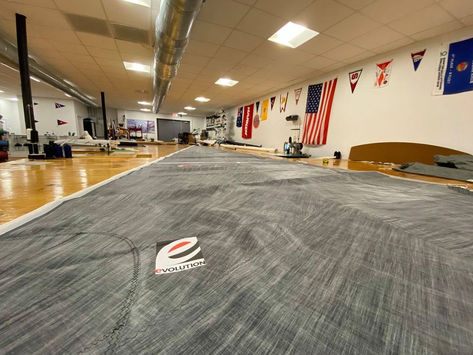

Evolution: Main and or Jib Fabric: Cross Cut Dimension-Polant AP280 or Dimension - Polant Flex Sport LS11 or Rti Radial Demension - Polant Carbon Sport LS 10 - Zero Di,emsion - Polant CZ05 - Low Price is 6K High 7K
North: Main and or Jib Frabic: 3Di Ocean (Nordac) ( For Jib not structured for Reefing) or NPC Cross Cur Nordac ND64ha Zero 75% SMG NPL Code X1 X104 CD or MaxiKote MK 200P 2.13 oz - Low price 5.3 to 8.1K

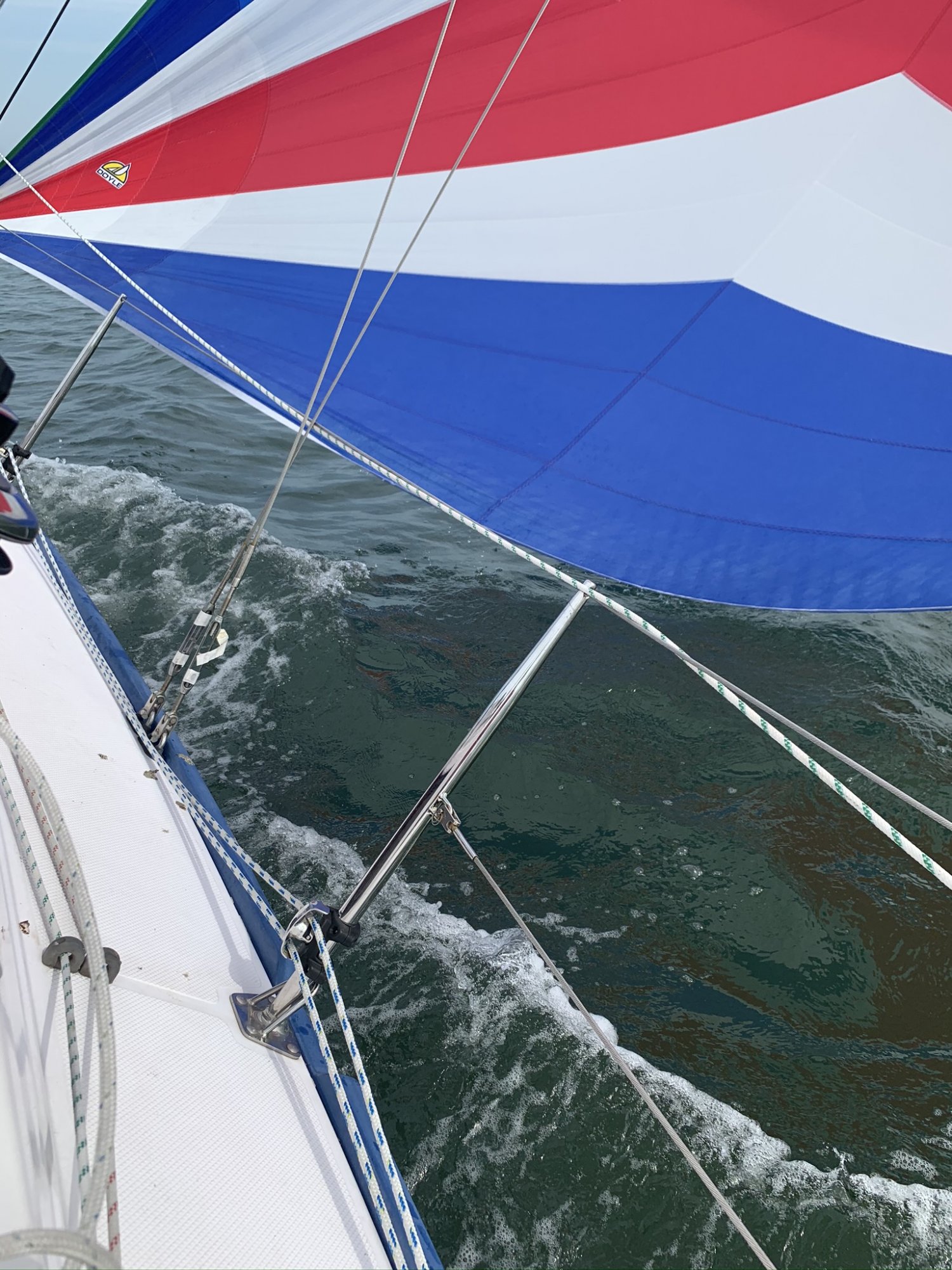

Supposed to be a 106, but if pulled taught it does just touch the shroud... wasn't supposed to.

Just replaced my original UK sail, that wasn't an OEM sail, that had a Top Full Gaff abd next down as full. Rest were partial with a new Full Batten North... Haven't been able to really try it out as its been blowing so hard needed to use the first reef... I have a preference for full battens and needing po feather the main was much more controlled this weekend in the Puffs (near 20+) than the Partial was
