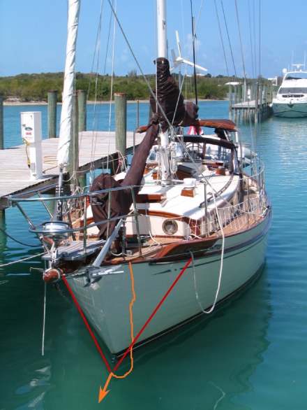

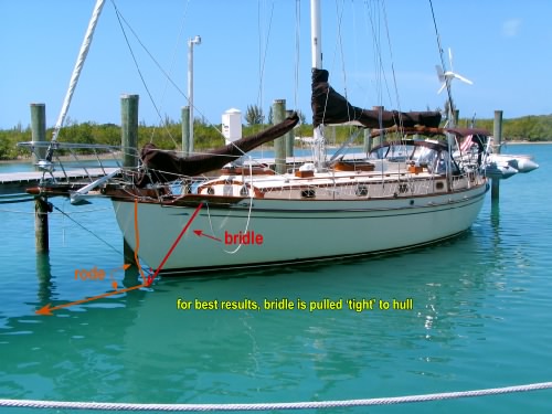

Over the years, and owning many boats that 'hunt' when anchored, I discovered the 'best' overall method is to use a "bridle".
Ive tried heavier ground tackle, kellets, riding sails, anchoring from the stern, removing sails, etc. etc. etc. Nothing beats a bridle attached to the rode. A bridle is attached from an auxiliary chock or 'hawse' about 10-15% of the boats LOD 'back' from the stem on one side of the boat, then attached to the rode at the bow's center-line, and run back to an identical chock or 'hawse' on the opposite rail. To 'set' the bridle, you pull in on one side, then the other .... until (important) so that the bridle's connection (multiple rolling hitch or chain hook) is AT the waterline AND just slightly in front of the bow !!!!!!!! The rode will then have a much greater 'scope angle' and if the boat does start to 'hunt' one side of the bridle will tighten (straightening the bow to the wind) while the other side 'relaxes', all giving an 'early counter-force' to dampen the 'hunt' / sailing at anchor.

My current bridle (for chain rode) is braided nylon with a chain hook 'middled' to it with a 'figure-of-8 knot'.
For my secondary rope rode, I use braided nylon and attach it to the anchor rode with a 4 or 5 (instead of the normally 3) wrapped 'prussik knot'. http://www.animatedknots.com/prusik/index.php or do websearch for 'prusik knot'.
Gel Chafe - you need stout chocks 'hawse hole in bulwarks', etc. to protect the 'cap rail'. I havent seen any gel chafe below.... but it does sometimes 'rub' on my bobstay and for that I use chafing gear (rubber/nylon tube over the braided) near the attachment / chain hook.

RichS -
On my boat I have 'hawse holes' through the bulwarks. Could be cleats, etc. on 'any' boat.
see attachment

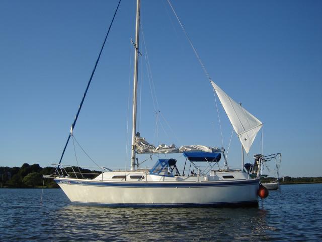

I'm thinking of designing a tri sail to mount on the aft of the boom with a halyard from the top connected to the end of the boom. I'd like some suggestions on other ideas. Thanks
Sailrite makes (and has kits) for two anchor-riding sails. I have been hashing over the possibilies for a couple of days, having seen the smaller Sailrite model flown on my neioghbor's boat here at the dock. I have a Sailmagazine article that I am going by as far as square footage of the sail. For your 410, they call for a 30 to 32-square-foot sail.
