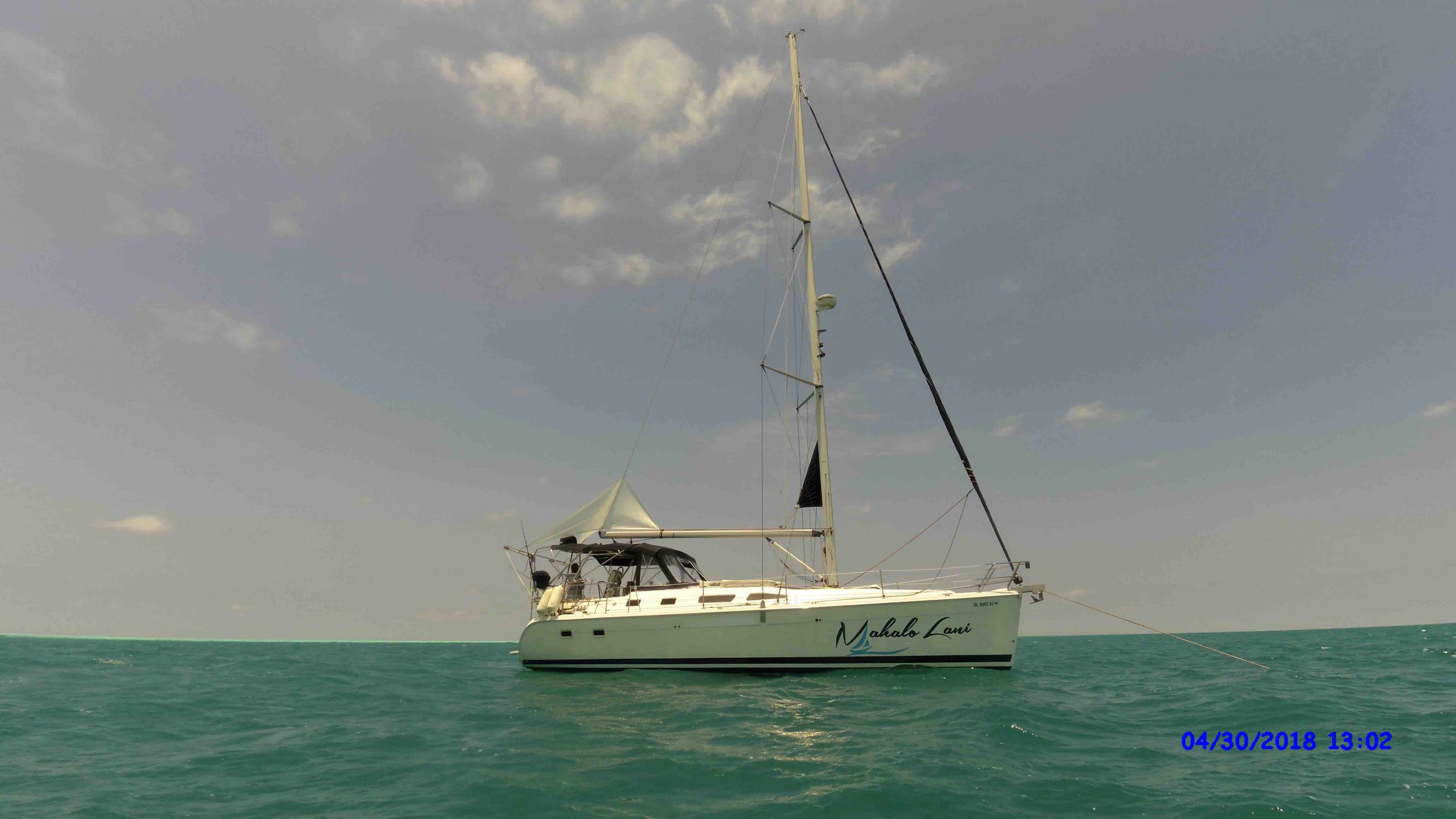

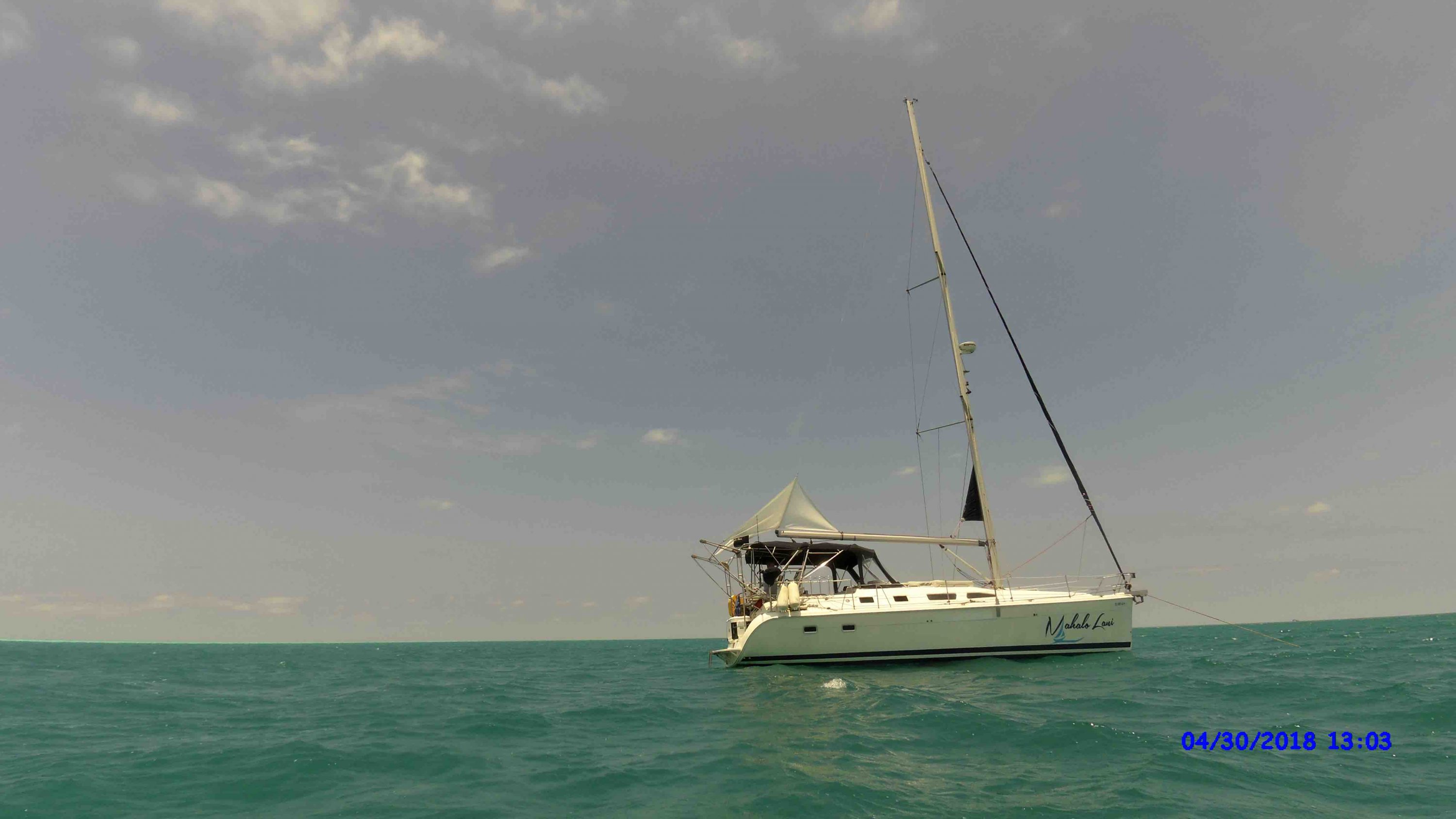

Another way to do same thing, especially with your in-mast furling main. I do this in a 10 knot wind anchorage.
1) Unfurl your main about 1 foot or so.
2) Belay your main sheet to center position of your boom
3) Set you Anchor alarm to be, Distance = anchor chain + rode + boat length + 10' [GPS precision ;)]
