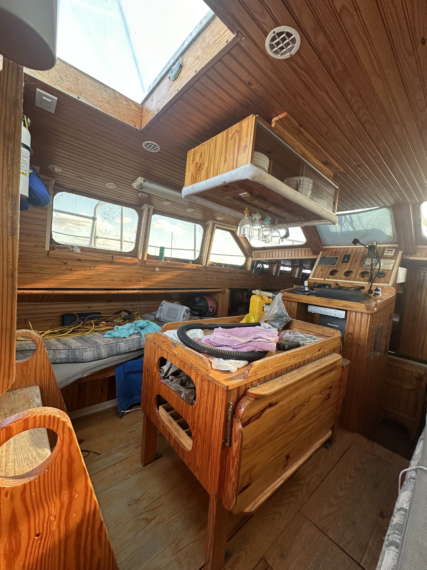

Good to know. I just got back from inspecting it. After 15 years on the hard it actually looked good and it did swivel on the bearing. It’s a custom built Bruce Roberts design with a AeroRig like mast but the company Forespar actually built it for the owner.
There was even an extra bearing.
I’d probably jump on this, but the ‘pilot house’ which was also the salon part of the boat was too low for me to stand up in. At 6’1” and my girlfriend at 6’0” we were craning our necks. I’m not sure it would be realistic to drop the floors a few inches. It’s too bad!

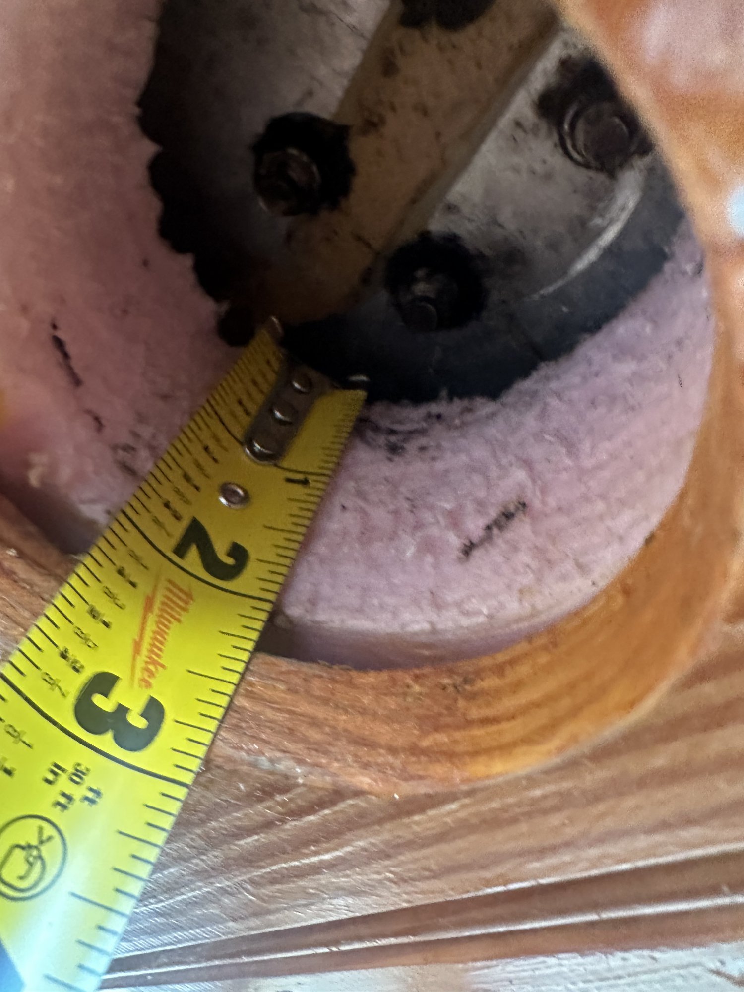

Is there enough clearance under the boom to raise the roof? That would be the easier option. Remember that with the AeroRig, the height of the boom is a fixed dimension because it is a rigid connection to the mast.
Sep 9, 2024
3
Cal 34 Mackinaw City
There was around 2 inches or less of clearance above the aluminum bimini. I found 2 inches of foamular insulation between the ceiling panels. The panels themselves were tongue and groove, 3/4 inch thick.
Floor to ceiling was 69” and I’m 73” tall.
Could potentially remove the foamular and replace with thinner panels but lose some R value. Or use 3M thinsulate/similar product.
The more I think about it though, I’m not sure it’s worth it. It’s been sitting outside for 15 years and the bilge was full of coolant and rainwater. I’d likely need to replace the majority of the equipment. On the plus side the rigging looked great. It pains me to not be able to pull the trigger!

That is very low head room for a boat that size... Nice looking though... Even I'd have to bend over and I'm not 6 feet tall. I would find that pretty uncomfortable.
Looking at your pics, I would look into lowering the floor over raising the roof but there would have to be a lot of things right with that boat to entertain that much work.
