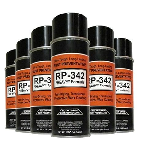

Collier's section on Rust Preventatives was kinda fun to read. He wrote about what the old timers used and how they would go on about them. Considering how old Collier was when he wrote this book, I have to wonder who he considered an old timer. :what:
He mentions Cosmoline as a basic petroleum-based coating used up to the Korean War with origins all the way back to the Civil War. Then he points to a product called Rust Veto 342, which is the modern version of Cosmoline by the same company.
This is Cosmoline from Amazon.
